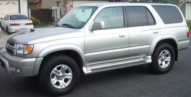

J jonnyk80 New member Mar 4, 2005 #1 normally when im driving around at 70-80 mph, my dashboard shakes excessively? Im wondering if it is the tires? I know the rotors are brand new? ANY SUGGESTIONS? Attachments newcar.jpg 44.5 KB · Views: 423
lee New member Mar 4, 2005 #2 thats probably due to out-of-balance tires... http://128.242.141.111/pub/search/findgsp9700.cfm find a hunter machine near you and get it balanced.
Jason B Official Vendor Mar 4, 2005 #3 Good advice. It could also be the front rotors if they are warped and hitting the pads. Most of the time it's the tires. See my post about balancing and the Haweka adapter.
