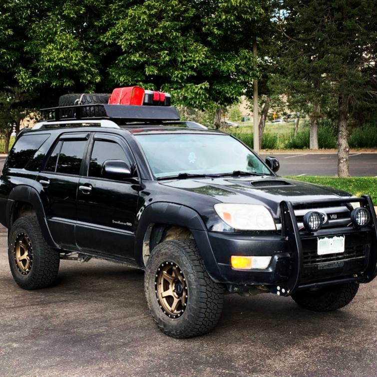

Current Build:
5100's 5th gen Coils, 1.5 spacer w/4th gen coils
Volant Intake
Cali raised Tundra brackets w/BD squadron sports
Police style Bull bar w/7in round lights
Custom 4runner molle racks
SPC UCA's
Matte Bronze RR2-V wheels 17X8.5
285/70/17 Wildpeaks
RSG BMC
Roof rack
removed Mud flaps, side steps

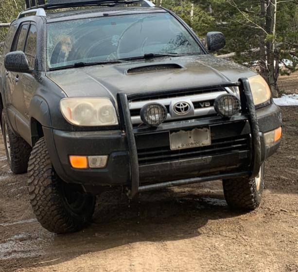

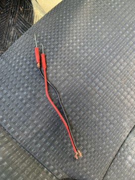

One cause & fix for "VSC TRAC" & "VSC OFF" lights, Zero Point Calibration - Toyota 4Runner Forum - Largest 4Runner Forum

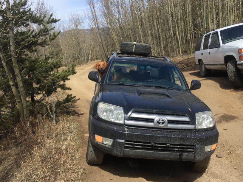

One of the first things I fixed was the VSC & Trac Off with the Zero Point Calibration. it was extremely easy and cost nothing more than 2X butt connectors, spare wire, and half a paper clip (still have the "tool" in the glove box). Find a flat spot to park and complete the steps. Next on the list was the loud blower motor $35 and 30 min later it was replaced, sometimes I have to tun it on HI just make sure I can hear it run. Spent $8 at the dealership for replacement HVAC bulbs, And lastly I dropped the spare and cleaned the rim (wasn't holding air) and remount the tire. I was Finally ready to test this beast off-road. In stock form the 4runner is extremely capable off-road and comfortable on the way to the trails.
Stock XRES, Temp Tags, 265/65/17

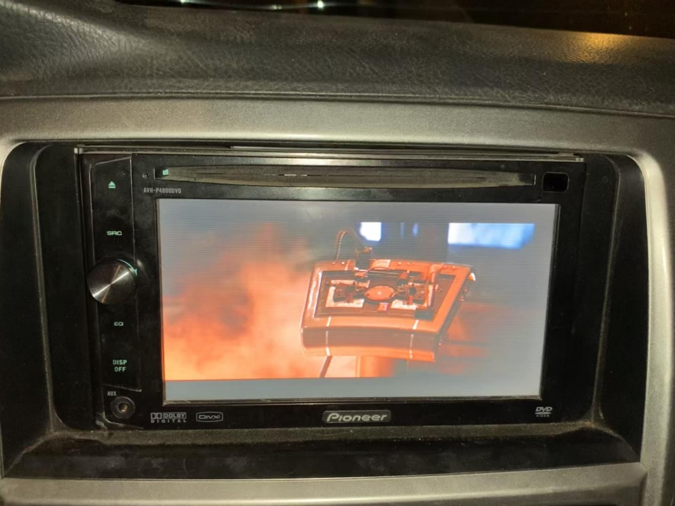

Audio upgrade & Craigslist finds

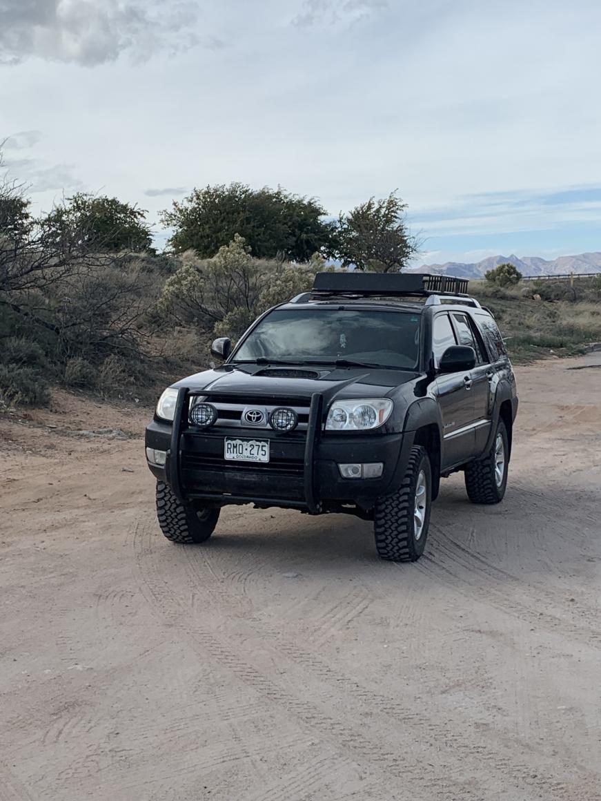

With the first off-road trip out of the way, I took it on a 3 state 1200 mi road trip. After I returned home, I knew the next thing on the list was an upgrade to the oem radio and speakers. I choose to replace the speakers with a set a kickers (6x9, 6 1/2, tweeters), I picked up a used "simple" aftermarket touchscreen HU (no nav, bluetooth, apple play...) it has sat radio, and plays my dvds when "off the grid". While searching craigslist for parts I was able to find a brush guard "police style", it helped to change up the front look. I had a pair of "off-road" lights from another project that I decided to add.

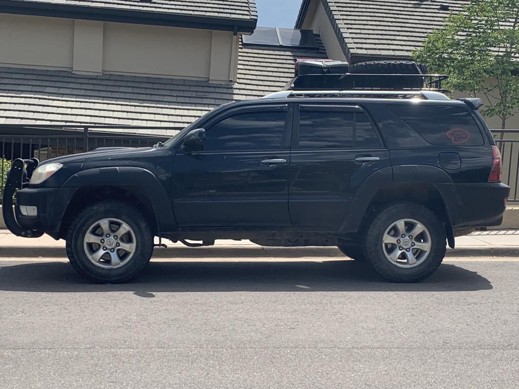

More Craigslist Finds and a Roof Rack!

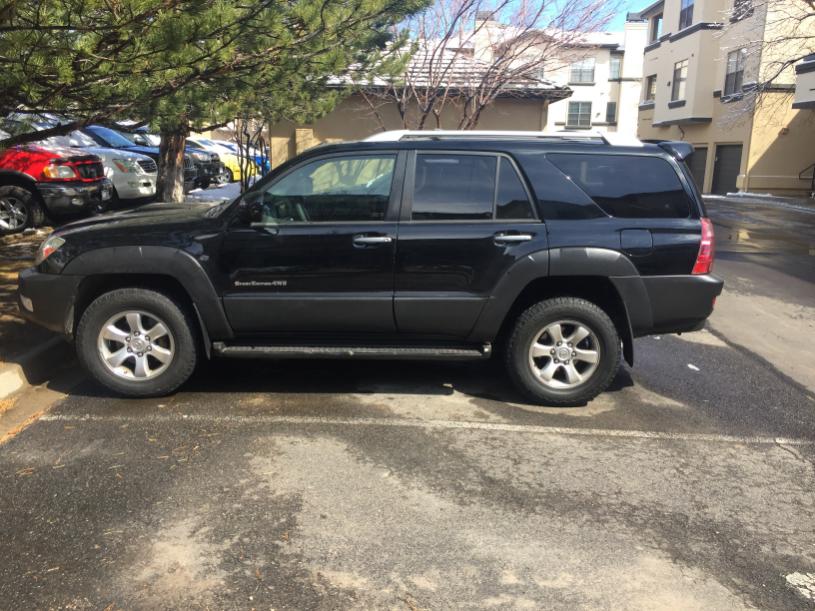

One of my favorite finds was a used (10K miles) complete set of 5100's off a 5th gen, after a 2hr round trip I was able to get a set of front 5100's w/stock 5th gen coils already set at 2.5" and rear shocks w/1.5" spacer (total $120). I also added a set of used 255's ($120) and a no-name roof rack with 2 day shipping. one weekend later I lost all my XRES fluid, but gained 2.5" of lift :thumb:.

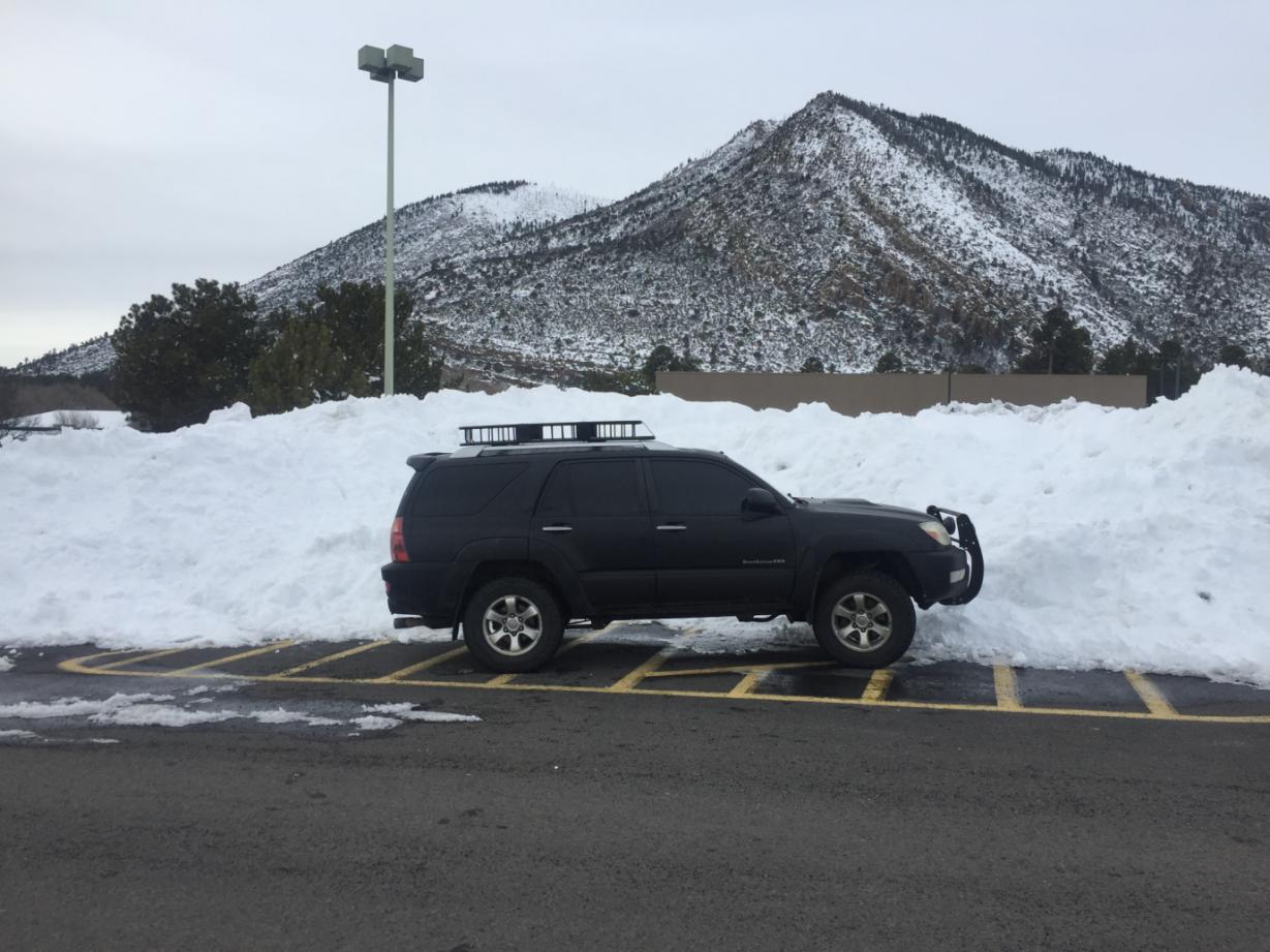

Shake down

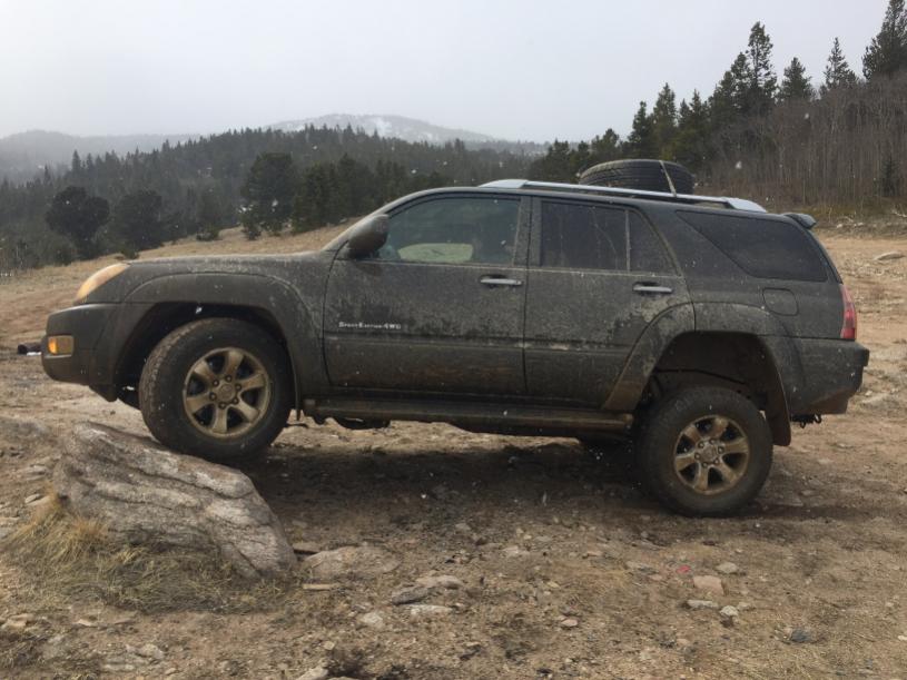

After the lift install, I decided to take a little trip to test the on-road manners of the new lift. For anyone with a tired, old, worn-out suspension, I highly recommend a set of 5100's. Had to drive all the way down to AZ to find snow, the only issue the entire drive was the lack of 5th/OD. I was forced to stay in 4th the entire trip, not bad... except when you're traveling up hill (5% grade, 70mph, 3200rpms) my gas mileage dropped down to 8.6 mpg (not towing, light cargo load).
