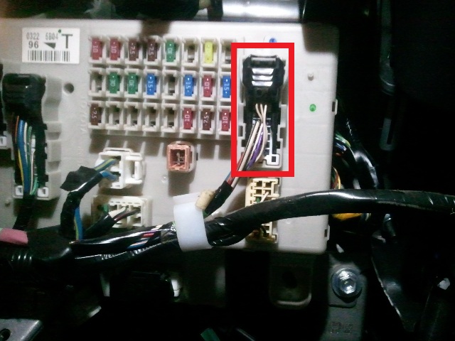

3: open the door and see if the fuse blows.
b: yes, remove the driver's a pillar (the handle at the left side of the windshield)
c: remove pillar post and disconnect the harness at the bottom the windshield on the left. what you are doing is disconnecting the top wire harness on the roof. if there is a problem up there and disconnecting this, you narrow down your problem to the roof area.
I thought the roof wiring connects to the fuse box under the driver kick panel. I've outlined it in red below. This will also disconnect more than just the roof harness, I'm not sure what all else on that connector
I never saw a connector in Pillar A when I had it removed for the dome light mod. You have a picture?
That's good to know, I do so many cars I must have gotten it confused with another vehicle I worked on recently. You are right. That's good to disconnect all the stuff up top so you can rule that out. Just to give you an example of the vehicles that I worked on today, 2014 mini pace man, 2014 country man, 1989 Chevy Blazer, 2013 acura mdx, and 97 dodge Dakota. That's just today :)
