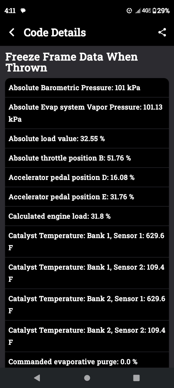

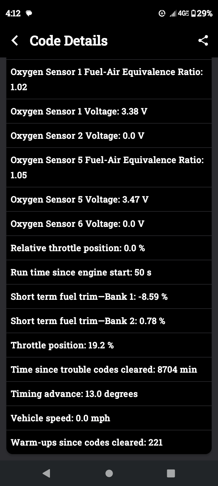

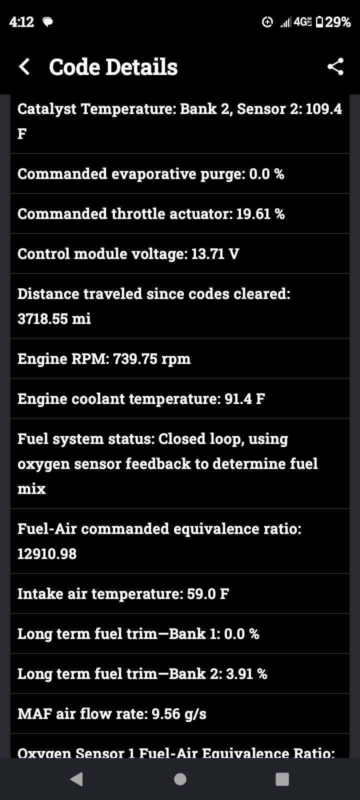

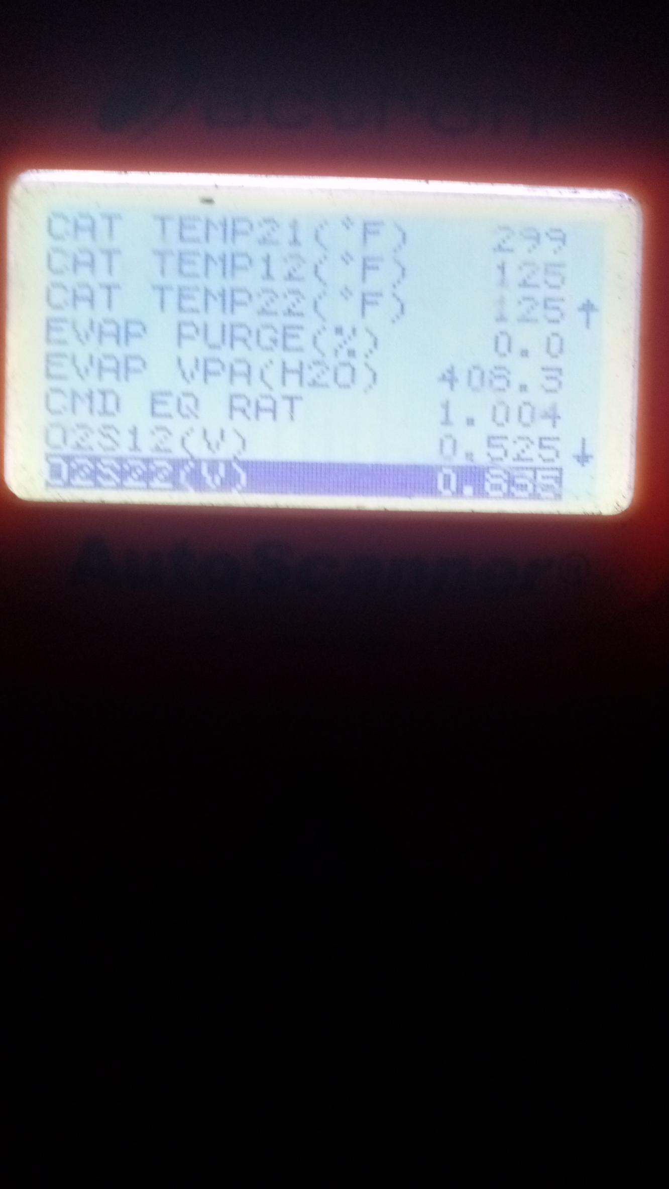

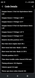

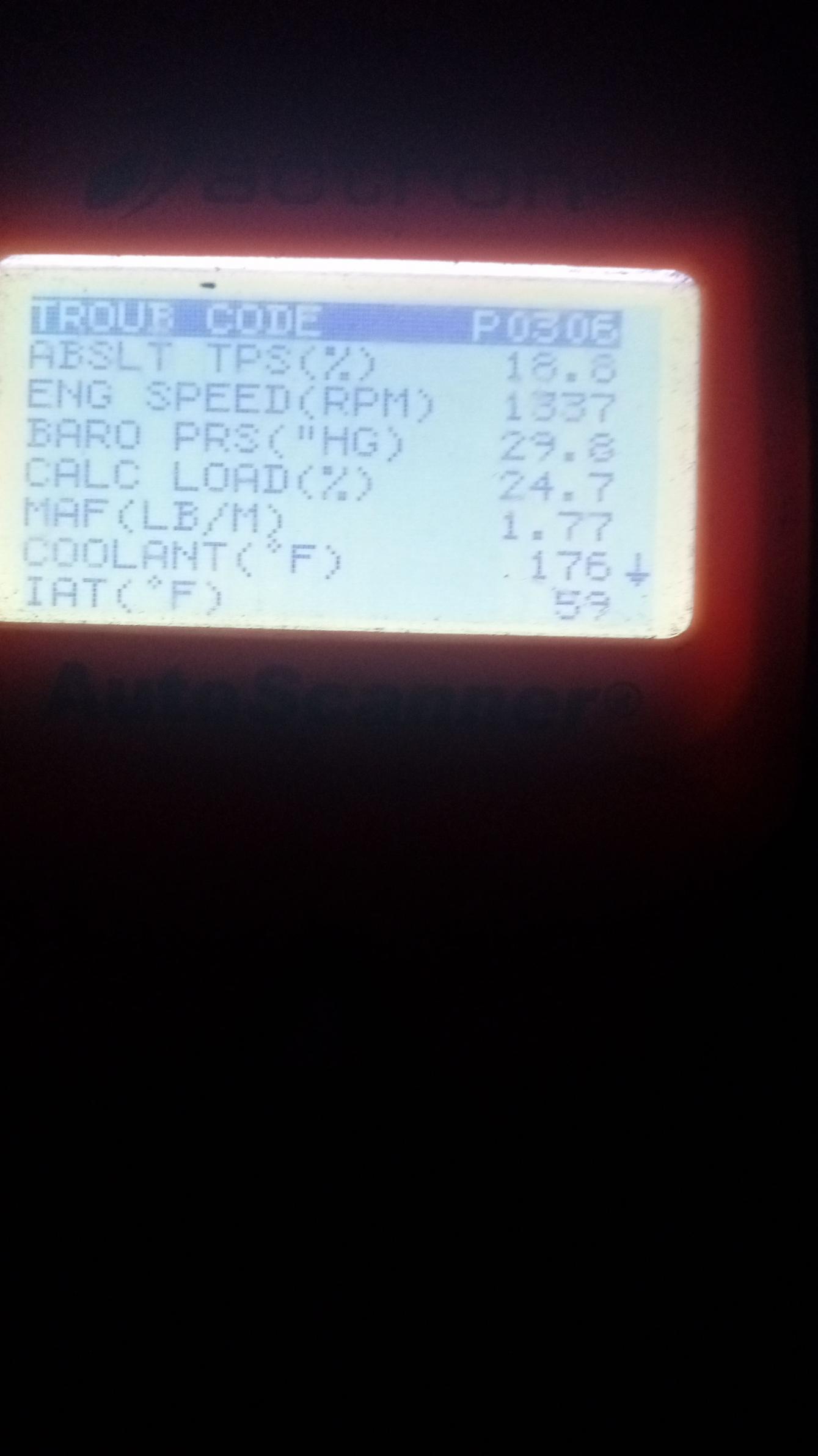

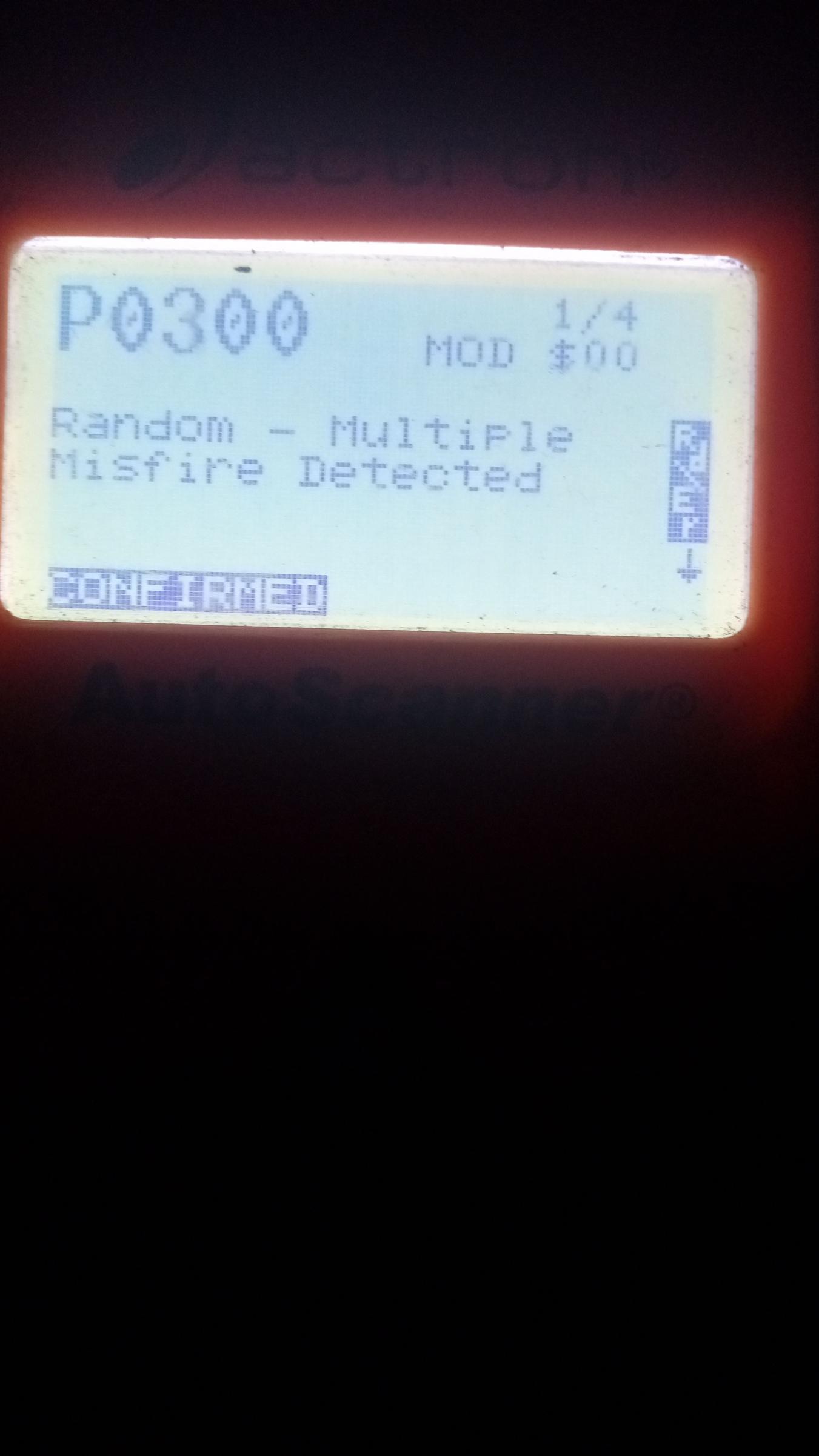

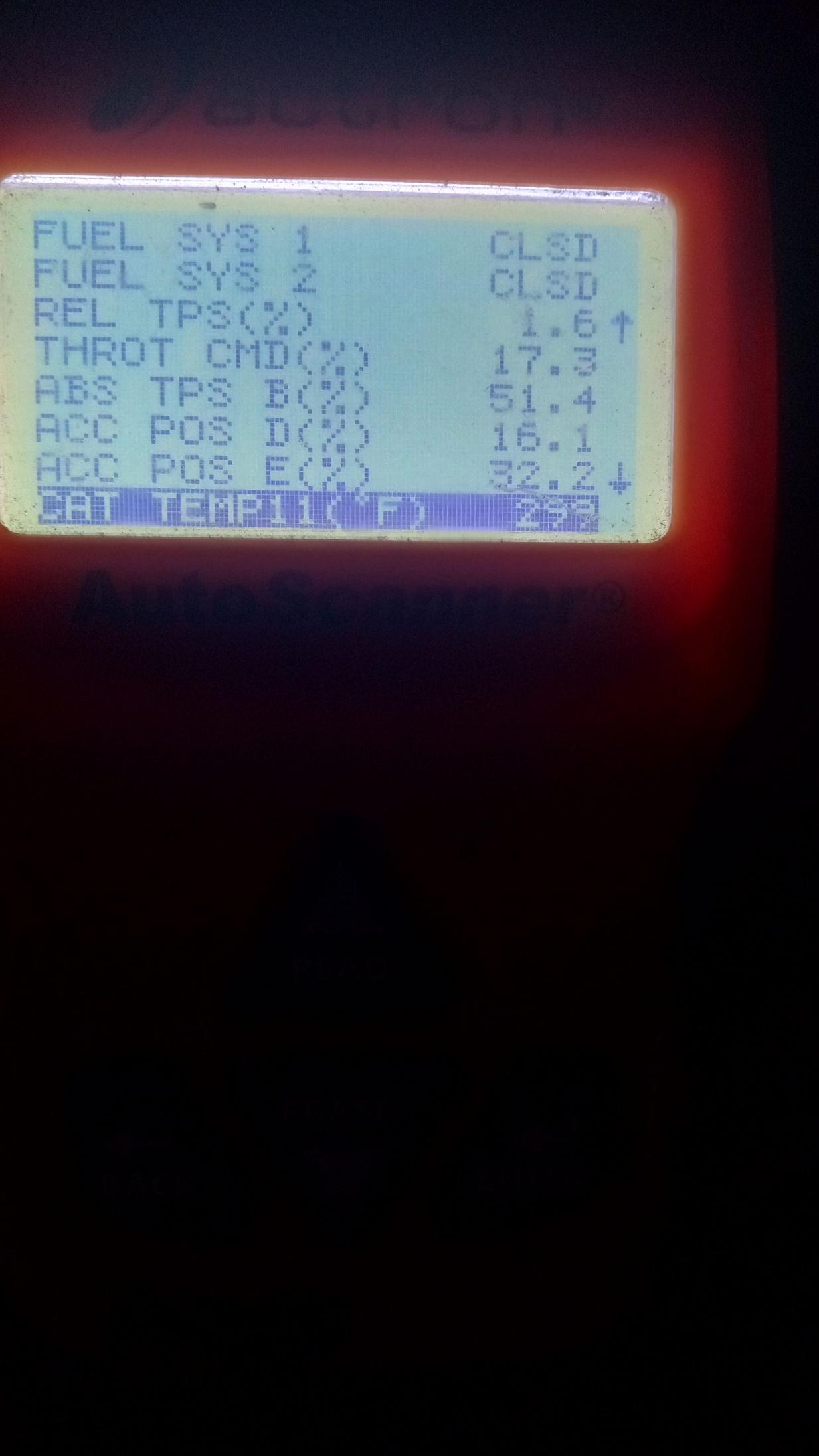

I have a 2005 4Runner limited that had been running rough lately then check engine light came on along with the VSC track and the slip indicator light those came on in the past but it had always been a loose gas cap but this time I ran a scanner on it because of how the vehicle had been running I used a fixed scanner and it produced a po306 code misfire cylinder 6 here are the freeze frame data from that date of January 13th when I first ran it.

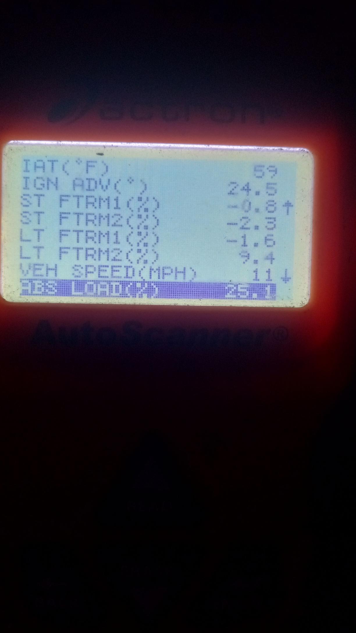

I decided to let my friend who knows a little bit about cars install a new spark plug just to see if that was the cause of it but he installed a new spark plug in cylinder 5 instead of cylinder 6 because that's where he thought it was so after he was done it wasn't until then that I realized when the code came back up that he installed it in the wrong cylinder but I rescanned the vehicle with a different scanner an actron one and it came back with the same cylinder 6 misfire code along with po305 cylinder 6 misfire and an additional po30 multiple cylinder misfire code so what I am wondering is did he install the spark plug wrong for the cylinder 5 code to come up now being that's what he just replaced I'm just so confused and I don't want him to mess up my car can anyone shed some light also this is the freeze frame data from the actron scan results on February the 2nd the other day when I did it thank you guys y'all are great I love this website
I forgot to add that the check engine light is on and flashing the VSC track light is on and the slip indicator light is on along with those codes.
I'm mainly concerned with why after putting a new spark plug in cylinder 5 (on accident it was supposed to go in number 6) why I'm getting a misfire code for that cylinder now as well as for 6 and now a random multiple misfire code.

What did the spark plug, coil, and plug well look like? Were they wet or dirty? Inspect #5 coil. Look at boot, coil to spring contact, and plastic housing. Try swapping #1 coil to #5 cylinder.
If you drive it for any length of time with the misfire and flashing CEL, you will damage the CAT. On the freeze frame data, the 9.56g/sec MAF reading at idle looks high to me - I would expect it to be around 4.0g/sec. MAF issue would be a multiple cylinder problem. Could try cleaning it or replacing it. Maybe others could comment.

Agree - want to be careful with sensors on a T4R - OEM or OEM supplier only. If the OP decides to replace the MAF sensor, this is the one I would use...

Agree - want to be careful with sensors on a T4R - OEM or OEM supplier only. I would first try to clean it but if the OP decides to replace the MAF sensor, this is the one I would use...assuming it's a V6....

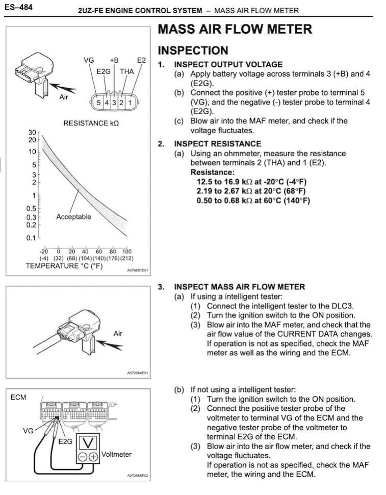

I didn't see what engine OP has but why buy a MAF before completing this? This is from the V8 manual. The V6 would be similar.

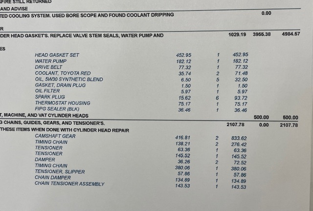

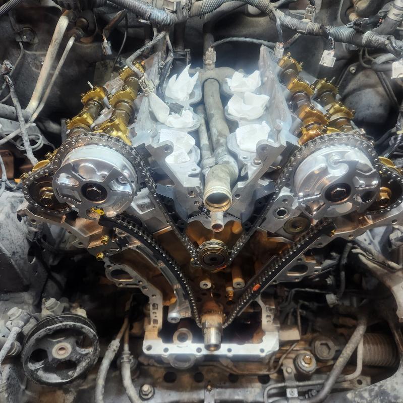

I’ve been chasing a P0301 code since mid June. I’ve owned my 2005 V6 Sport 4R since new. I decided to change all plugs, ignition coils, and lastly the fuel injectors….still with rough idle at cold start. So I decided to take pull the coil and look inside the #1 cylinder head. Not good. Oil/coolant in the cylinder. Chat GPT said might be a leaky stem valve. Finally, decided to take it to a Toyota specialist and they confirmed it was a blown head gasket. Small leak causing the coolant to get into cylinder head overnight, rough idle at cold start…runs fine after but get same issue when it sits.
Soooo….having the engine rebuild this week…20.5 years without any issues is pretty good. This was a known issue in early model 4Rs. I’m planning to keep this 4R FOREVER so the price isn’t an issue for me.
Good luck.
Got the 4R yesterday and drove it to work today. Engine feels smooth and purrs like a kitty. She’s back to normal after the rebuild. Now, need to find replacement tires.
An arm and a leg for sure. Labor of course was the most expensive, around $4600. This is the Austin, TX area and had it done at Bearden Automotive, they are Toyota and Lexus specialists.
