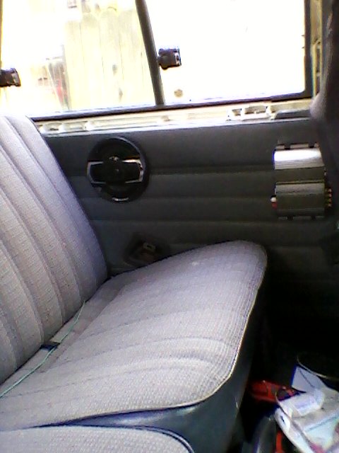

Well this morning was mildly productive.
Installed speakers in panels next to seats- no need to cut metal (yay!). Purchase and installed amp, began wiring speakers and amp.
Began figuring out and ripping out shitloads of existing wiring. Some of it puzzles me, I must say. :tsk:
changed a few fuses, but the horn still doesn't work. :doh:
Perhaps best of all, I'm solving this damn tire and alignment problem once and for all- with money. My mechanic referred me to someone else who's going to mount four new 235/75/R15LT BFG ATs on my used 15" rims I found (I already have two), replace the swaybar and rest of associated pieces on front right side, and do an alignment, all for a reasonable price (given how much two new BFG ATs cost). Getting it done tomorrow. Shelling out some cash for it, but dammit it needs to get done. And there's no way I was figuring out how to install a sway bar and associated apparatus in the next week.
Well shit. Talk about your rookie mistake: that amp impedes the upward movement of the seat bottom when bringing down the seats. I didn't think to check when I placed it. I'm not sure where to place it, I guess I'm considering the trunk now. Grrrrrrrrr...
Mount it to the back of the seat or if you dont plan on the floor getting wet, mount it under the drivers seat?
My seats sag so much there's no room under the seat! But actually the back of the drivers seat is a brilliant idea, i'll give that a try when she comes back from the shop.
I have mine under my passenger side seat. fits perfect, wouldn't know its there unless you look hard. I don't do any river crossings or anything like that so I am not worried about it getting wet.
It's a 1200 watt amp and never had any heat issues, even when pumping two 12s for a long time. Well back when I had 12s, haha

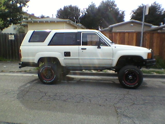

Well, she just got back from the mechanic. New BFG All Terrain KO 235/75R15LTs on new (to me) custom rims. Hate the paint job on them but they're the right size. The lift looks a little cray now, but I'm hoping I can take care of that at least partially by adjusting the front torsion bar. Also just told I need front brakes. BOOOO... hoping I can do that myself this weekend.
Also took care of alignment, sway bar/tie rod end assembly replacement.

It will require completely ripping out everything I did and rewiring everything, but it is also the best option. I may do that. In that case, I'd be mounting directly to the outer body of the truck?
Inside the drivers side panel is a little rack that holds the rear window washer that never ever works. You could modify that rack. Or pull the entire side trim and build a little sub panel in the empty space to hide it to. I wouldn't mount it directly to the outside sheet metal though.
Brakes are easy. And is the front lift all torsion-bar? If so, you can definitely relax them to lower the front, and you'll like the ride a lot better too.
Spray your torsion bar bolts and nuts with a little PB Blaster over the next couple of days before you go at ot. Also don't forget to raise the front end or you might end up like me with a broken bolt and a permanent scar on your fingers.
