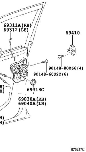

Yesterday I had my first experience with my dealers Service Dept, which unsurprisingly was less than enjoyable. RE: Required 5K service.
One of the things on my list was adjusting my driver door. For me I have to slam (slight exaggeration) this door to ensure it closes.
The Service Dept tells me they couldn't detect any difference with this door compared to the others.
Soooo I'm wondering if there's any tutorial on adjusting doors.
Obviously the adjustment would be minor but I haven't a clue where to start. I'm pretty green on body stuff.
One clue on what the problem is: When I gently pull the handle to open it, there's a more abrupt Pop when it opens. When I gently swing the door under its own weight, it doesn't fully close.
Can Part# 69410 be moved around a bit?

Carefully inspect where the striker plate (#69410) enters the slot in the latch. It should be in the center of the slot. If not, it can usually be adjusted by just loosing the mounting screws.
If the striker plate is centered in the slot and you still have problems, lubricate the latch mechanism with WD-40.
If the striker plate cannot be centered in the slot, then you will have to have the door hinges adjusted.

According to the Toyota OEM repair manual, page 5446: (TOYOTA 2016-2019 4Runner Repair Manual RM27F0U)
(e) Using a T40 "TORX" socket wrench, slightly loosen the striker mounting
screws.
(f) Using a brass bar and hammer, hit the striker to adjust its position.
(g) Using a T40 "TORX" socket wrench, tighten the striker mounting screws after the adjustment.
Torque:
23 N·m {235 kgf·cm, 17 ft·lbf}
Previous pages in this repair manual describe how to adjust the door hinges.

While I am no body expert. I've definitely tweaked some door strikers before, and usually get the desired results. It's not a difficult thing to do.
You'll need to crack the two torx bolts loose. Not so much that you can move the striker by hand, just a couple turns or so on each bolt.
Then I usually use a dead blow mallet to knock the striker the direction I need it to go, you could also use a regular hammer and a block of wood. Don't be afraid to give it a good whack, but at the same time, don't go pounding it with a sledge.
In your case, if your door seems too tight to close, you'll want to bring the striker towards the outside of the vehicle. Try the door after you've moved it a bit, then just keep going more or back the other way until it feels right.
The last thing you want to do before you tighten it back up, is to check that the striker is level with the latch. Grab your door, and close it while holding the handle out so the latch can't engage, and just rock the door back and forth right near the closed position to make sure that the striker hasn't become out of line with the levelness of the latch. If that needs tweaking, just do as you did before to make adjustments, and just knock the striker up or down as required. I wouldn't mess with the hinges at all, or you could be opening a whole can of worms there.
Short answer yes. I’m obsessed with the doors closing cleanly and have adjusted the strikers on all of my last 4 Toyota’s. The Tacoma’s were the worst of the bunch. Word of advice, use a 8 in or so 2x4 to rest on the striker plate, loosen the torx about 1-1.5 turns, one or two decent smacks in the direction you want to go (usually down to close smoother, or in if door sticks out a little). In my early trials the mallet slid off the striker and hit the inside jam denting it(someone has a ‘16 Tacoma with small dent). The wood block gives more surface area to connect, just don’t rest it on the paint, even then, nothing a little buffing won’t take out. In the chance you drive the striker inside too much, put a thick screwdriver in the middle of the catch vertical and pull, the inside metal securing the bolts will give. There is a lot more forgiveness here than most think.
Also, do it little by little. Hit the striker in the intended direction, then tighten down the torx enough so you can close the door, if good, tighten down to spec, or adjust if needed. The only thing I haven’t been able to avoid is a little scuffing under the plate, it’s not bad and not visible. If worried about rust, just hit with touch up paint. It’s super easy, you can do this, and better than the dealer, or body shop, at least that’s what I’ve learned in my situation. I can also guarantee you this, once you finish the one door, you will do the rest. No more slamming, just a nice light flip and thunk, solid clean close.

I moved my plate ever so slightly towards the outside of the car, the hard close is gone, pop is gone when opening. So it was just in too far.
Drivers door now sounds the same as my other 3 doors.
