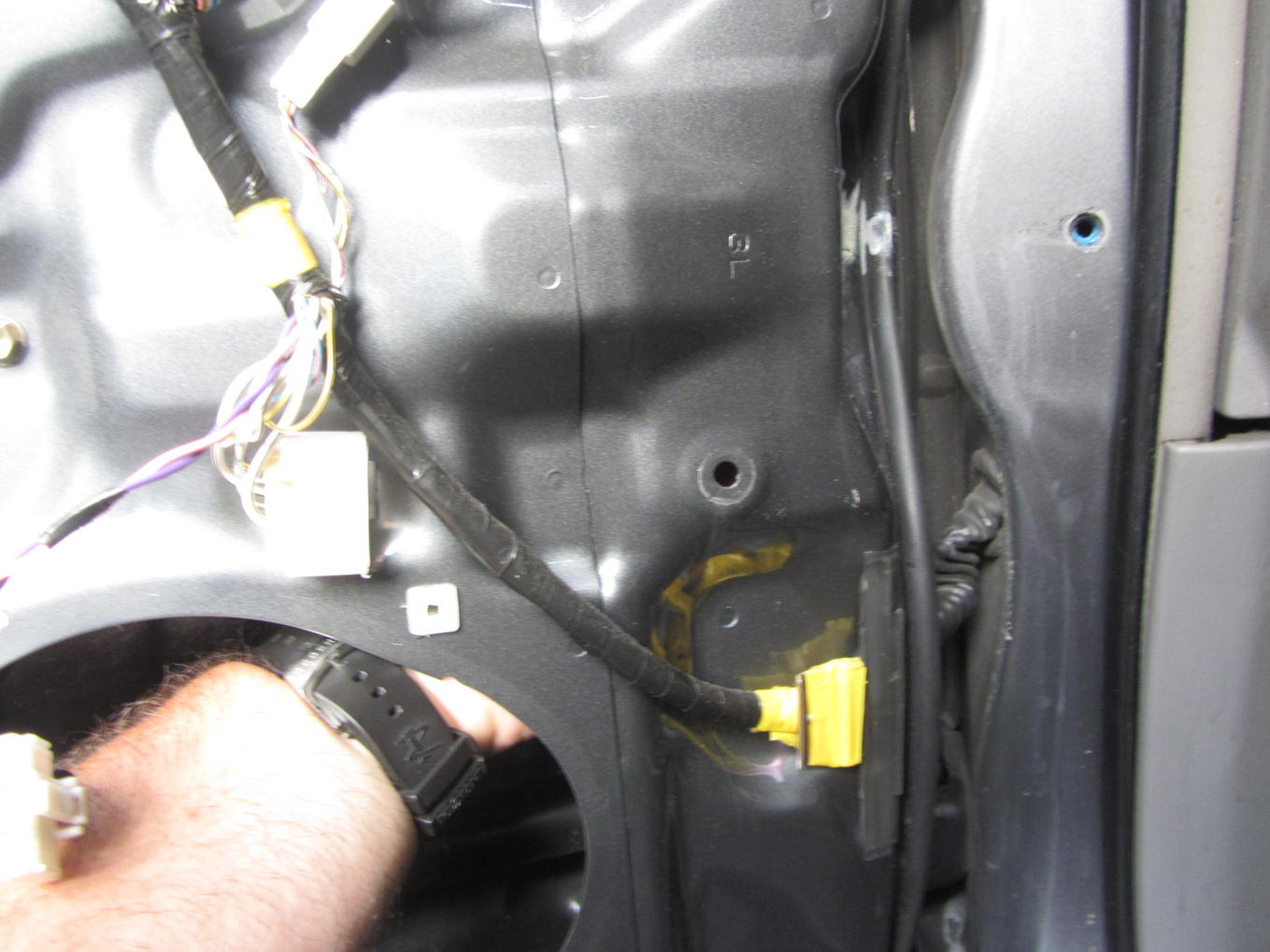

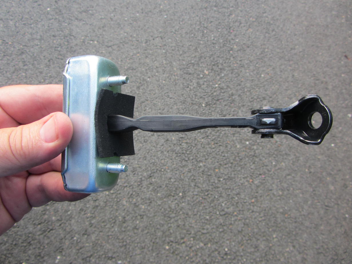

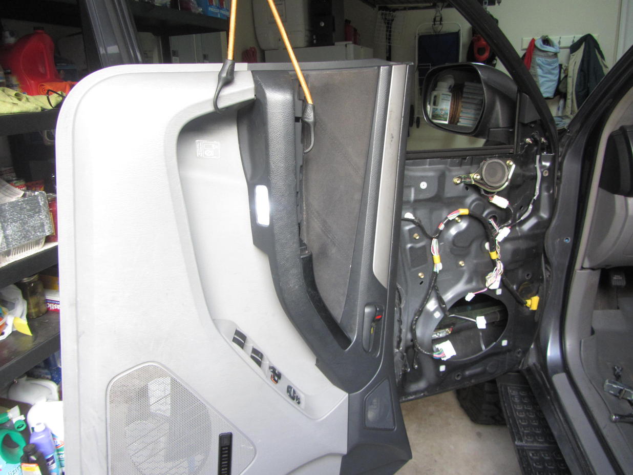

Installed the Door Check on the drivers side tonight...very easy.
1. Remove armrest panel...just pry up with a straight slot (remove screw)
2. Remove small plastic cover under door opener..(remove screw)
3. Lightly pull with fingers on the door panel...it popped out. The retaining clips can be used over and the panel is now removed from door. Slide slightly up and move right to left...panel will now only be held to door by the cannon plugs that attach to the speaker, window modulator etc....disconnect them.
4. Door panel was then hung with a bungee cord to support door panel.
5. Remove speaker....4 screws. Lift up and out, it will come out with some effort.
6. Reach your hand up in the speaker hole and remove the door check by unscrewing the 2 bolts that hold it to the door panel. Remove bolt that holds the door check to car frame and pull out of the speaker hole.
7. Reverse order to put in, I put some lockTite on the bolts and made sure they were not going anywhere. I aligned everything back up and then when it was all set...tightened everything down.
Pretty simple fix....can't believe I waited a year to do this!

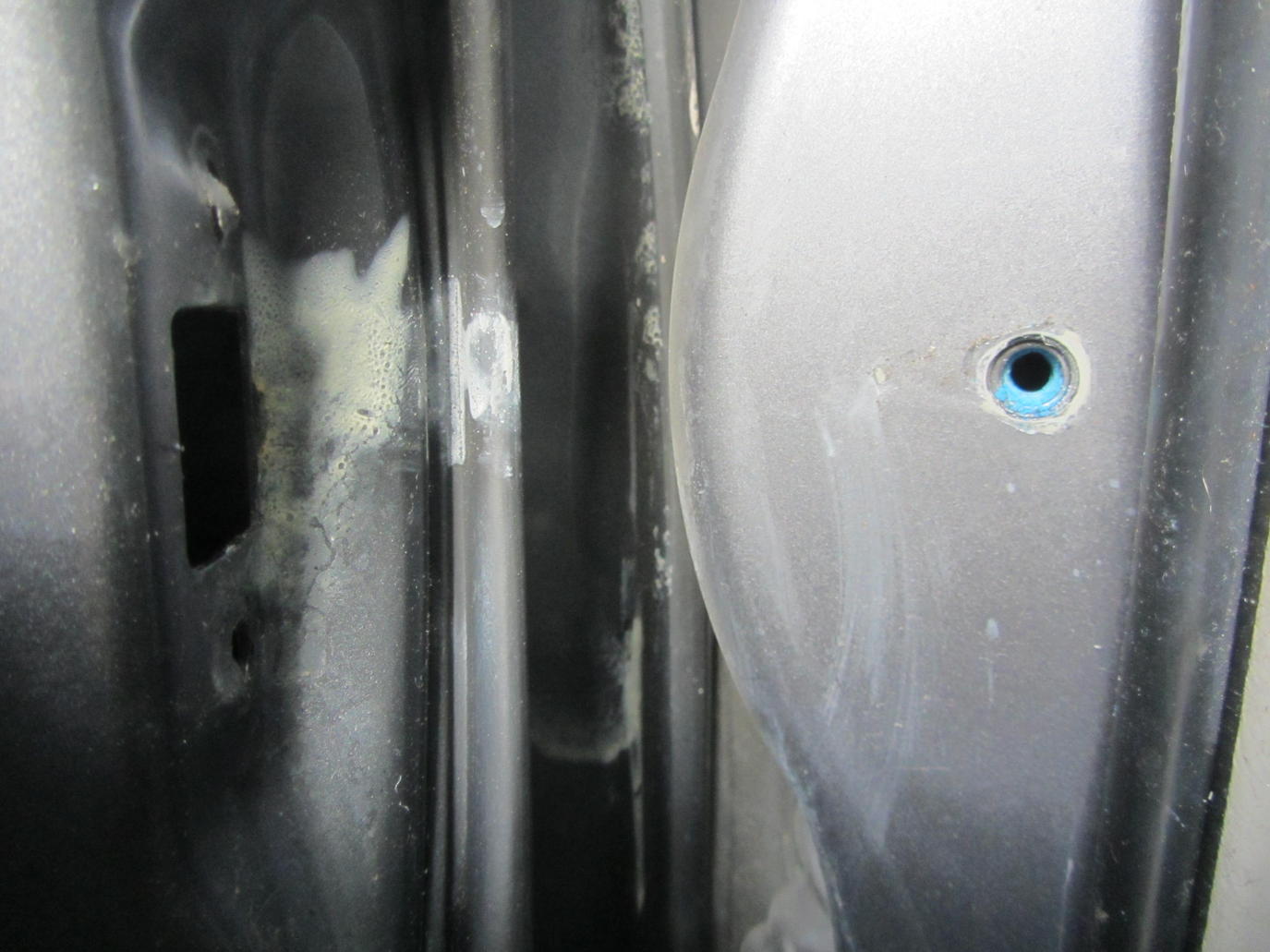

Thank you for the pictures natevans65. Received my new door check on the last week and could not wait till the weekend. Replaced the old one yesterday evening and did not find any issues removing the door panel completely without using bungee cords.
Couple items that will help remove the panel from the door in addition to the steps above:
  • When you start remove a small decorative triangular plastic piece from the top right corner of the panel. Otherwise it will not allow to lift the panel from the door;
  • Disconnect the small door light lamp. You could do it when the armrest panel is removed;
  • When the panel is removed from the door ask another person to help you at this step. There is another screw on the other side of the panel that holds the door opener. While another person holds the panel remove the screw and the door opener with two cables will come out no problem. Now you should be able to remove the panel aside from the door;
Also there is another clip at the center of the door (Blue-green color). It was left in the door when the panel was removed. Do not forget to install it into the panel when installing it back. See picture from SamNavy's post, Step 8, this is the clip! I hope SamNavy removed it from the door and installed into the panel before reinstalling the panel to the door :)

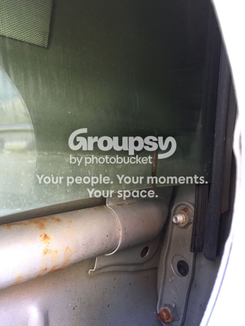

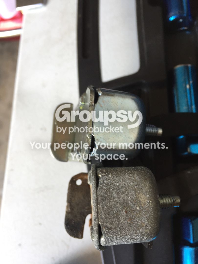

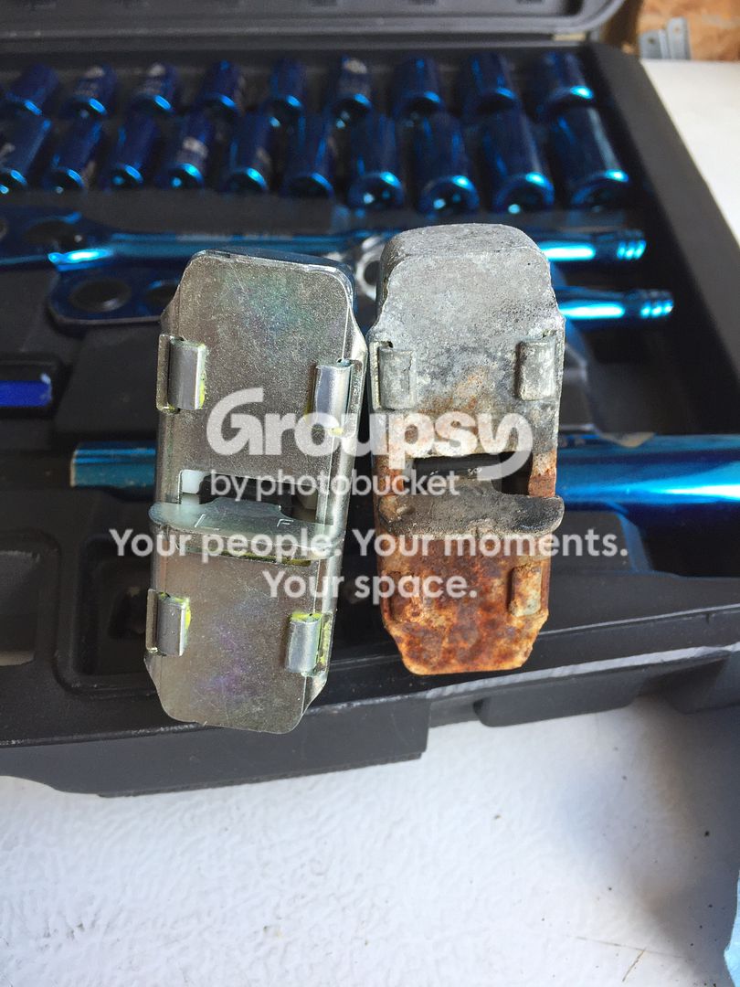

Replaced my driver's side door check today, thanks to this thread it only took 30 minutes. I put up with that nasty click sound for 5 years. LOL
Tools needed:
Phillips screw driver
10mm socket /wrench
Prying tool to remove door panel.
Bungee cord
Some photos!
New vs Old
IMG_0043_zpsgzm6tejq.jpg~original
IMG_0044_zps37nuzly5.jpg~original
Here's a pic showing the wear the door check was leaving on the bottom of the glass
IMG_0045_zpsqdb2vuji.jpg~original
Recommendations:
The door check is marked R on one side and L on the other. If you're doing driver's side then "L" should be facing up, and "R" facing up for passenger's side.
When the new door check is in place, feel inside the speaker hole with your fingers to verify there is a gap between the check and the glass.
Also sprayed the window track with SuperLube PTFE lubricant while the door panel was off, made a big difference , window rolls up and down smoothly again.
Definitely use bungee cords to hold up the panel, you'll save some time having to remove and then re-assemble the door lock cables.
