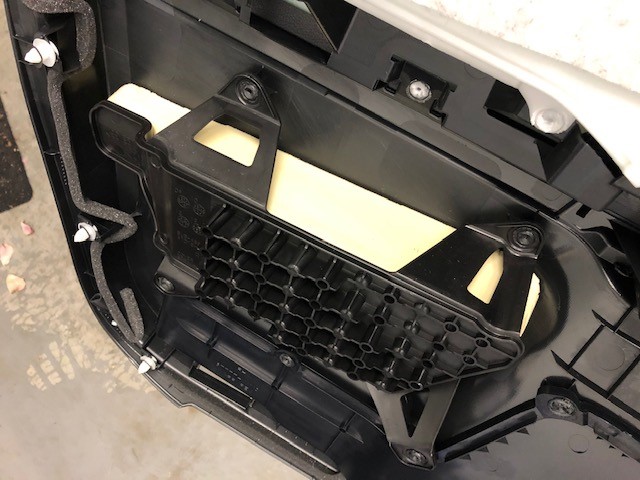

The yellow foam and textured black plastic bit, it extends into the door, curious what the function of it is? I'm hoping to use sheet metal and dynamat to seal up the door as much as possible when installing the door speakers, but this thing juts into the door cavity (where the clear plastic pocket is), and if it isn't critical I'd love to get rid of it...
I'm completely guessing here, but it looks like it provides a bit of stability under the armrest. Thats a fairly big expanse of plastic and it'd get dented in easily.
Either that, or sound deadening.
Definitely looks like it lines up with the arm rest, so probably reinforcing it.
Hmm, I've had my door panels off many times and I do not recall seeing that part. for sure it didn't cause any issue with adding the sound deadening material.

I recently sound deadened all of my interior and didnt have to throw that piece out. I did however have to adjust my material to accommodate it since I couldn't put my panel back on without doing so.
