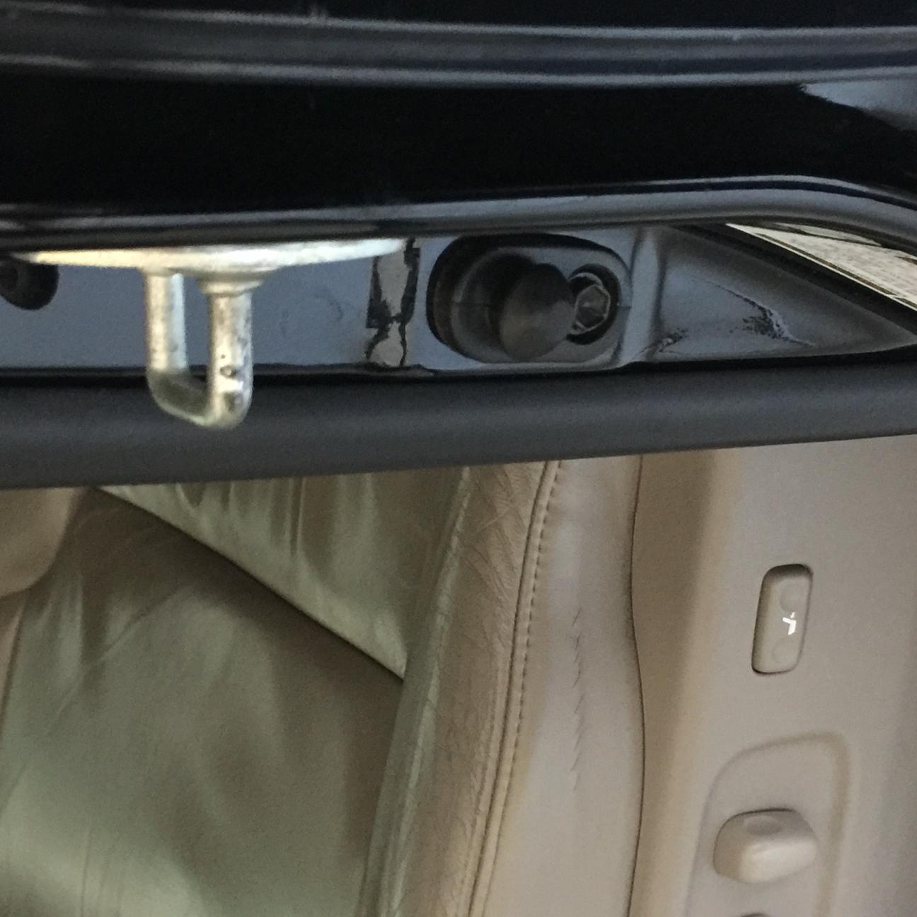

Was wondering if anyone has had an issue with this sensor? I haven't really looked into what's behind the cover due to lack of time. I can move it around and it will work, but every now and then it won't so my courtesy light doesn't come on. If anyone has fixed/replaced it I would appreciate some info/help. Thanks!!

It grounds to the sheetmetal via that bolt, it's an L-Shaped unit and the plug can be accessed from the back by taking the B-Pillar cover off.

I replaced mine about a month ago. Same symptoms you described and a new switch fixed it. I didn't remove the B pillar cover. I just unbolted the switch, gently pulled out some slack in the wire, unplugged the old switch, plugged in new switch, bolted it back on. Has been working ever since.
This is the part I ordered.
