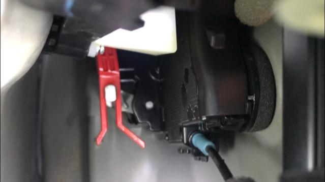

Thought a couple photos may help of the inside. Not the best photos but all I could muster with the location.

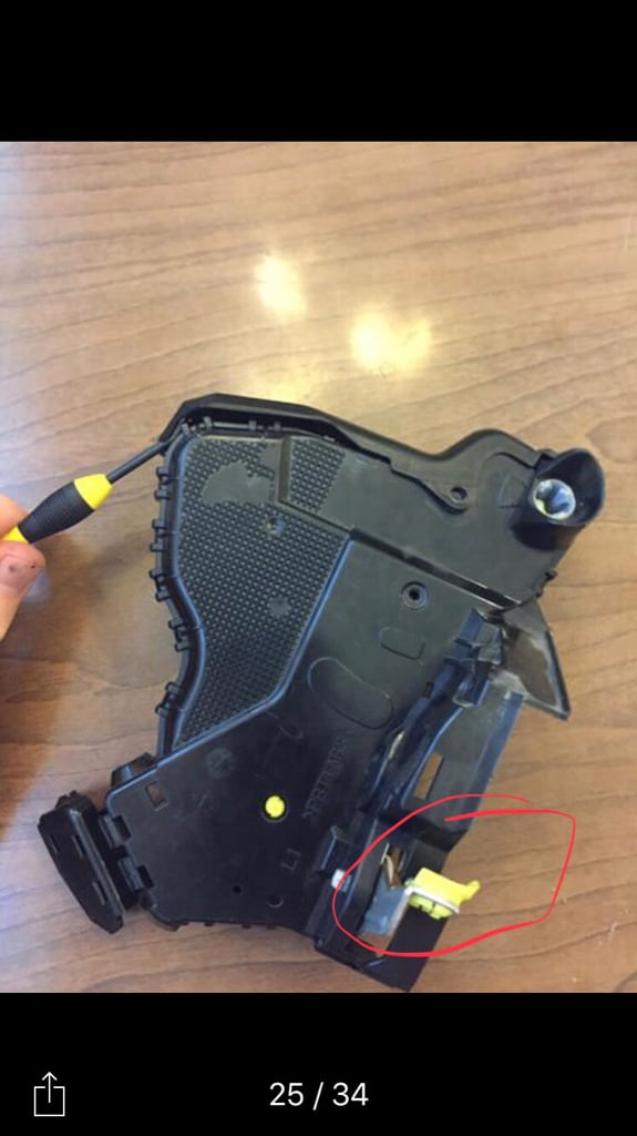

Did you confirm you placed that rod back in place after putting the actuator back in your door? The one that slides into the yellow piece circled in this pic:
I know I forgot the first time and I couldn’t open the door from the inside, don’t think it broke opening both inside and out though. Just guessing at what you may have missed.
I did not confirm that, so it's very possible I missed it. I'll have to feel around in there again today because I don't remember feeling a latch like that. Is that the child safety lock mechanism? Maybe push it down, then I can get the door to unlatch..
Thanks for the photo!

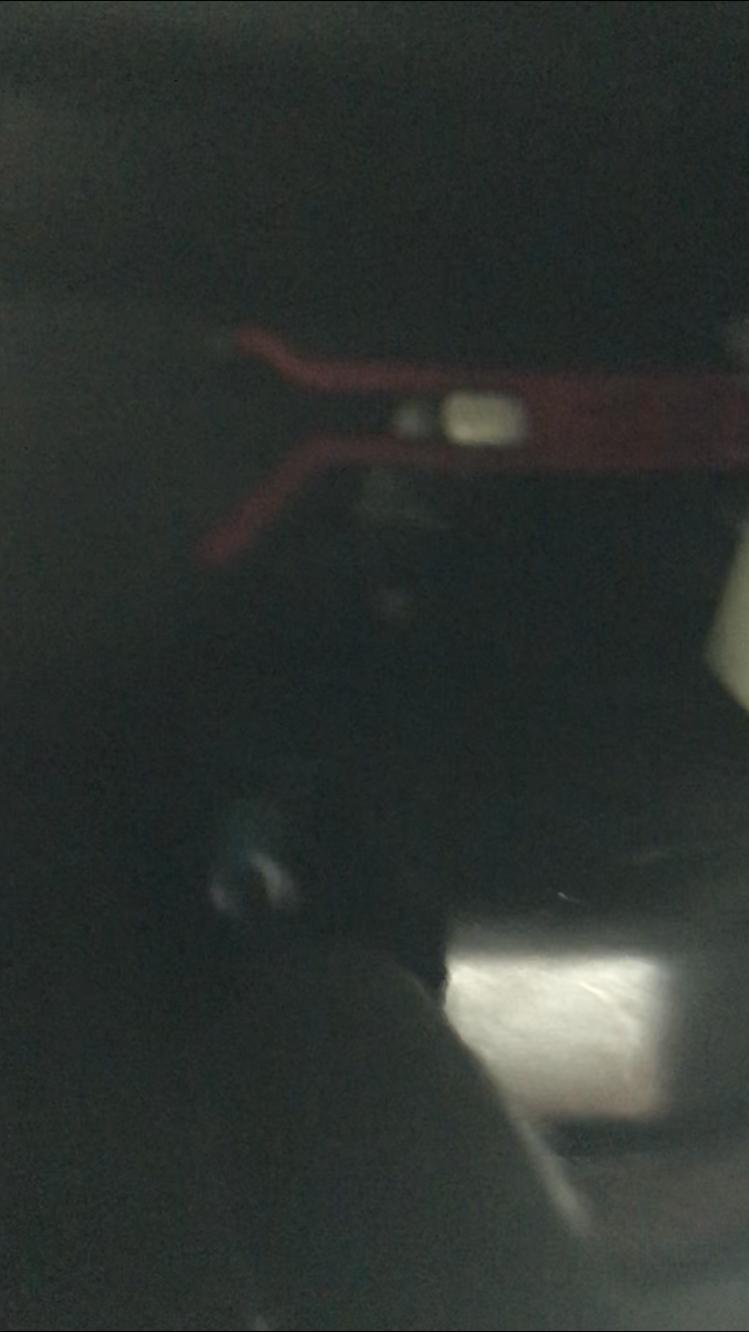

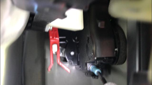

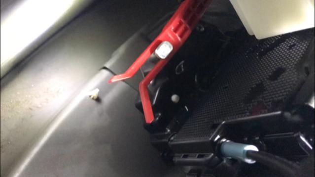

Appreciate the feedback from everyone. I got a flashlight in there and was able to get some cleaner photos. I've been focusing on the child lock idea and i have a line of site to the child lock switch (since I've removed the door panel) but I'm not seeing the on/off lever...like on the other side. I'm guessing that may mean the child lock was not put back in place correctly. If that's the case, anybody have ideas on a way forward?
Thank you!
brandon
