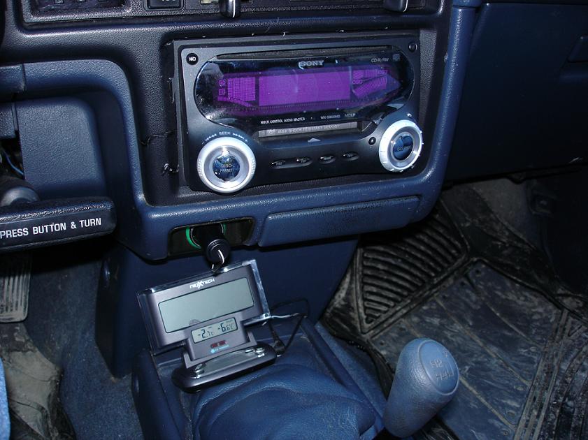

I bought a double din unit off ebay, because i wanted a deck that played minidiscs and cds, but i couldnt find any in north america (mine shipped from japan). It works well with the interior (matching blue), but it doesnt look stock thats for sure. If you want to find double din units, ebay is a good place to look as there a a few sellers from japan that sell them, and they have awsome decks accross the pond. (shipping actaully wasnt to bad, believe it or not)

I was under the impression that the Pan-Am units weren't compatible with North American radio frequencies.
Does the radio work on yours?
It only played Japanese 76-90MHz when i got it, but I found an FM Converter on ebay. The unit is inserted in the FM antennal lead and converts North America FM band of 94-108MHz to Japanese FM band of 76-90MHz. So if I want to listen to a station at 99.7 MHz, it will show up at 79.9MHz. Works on 12 volt power.
