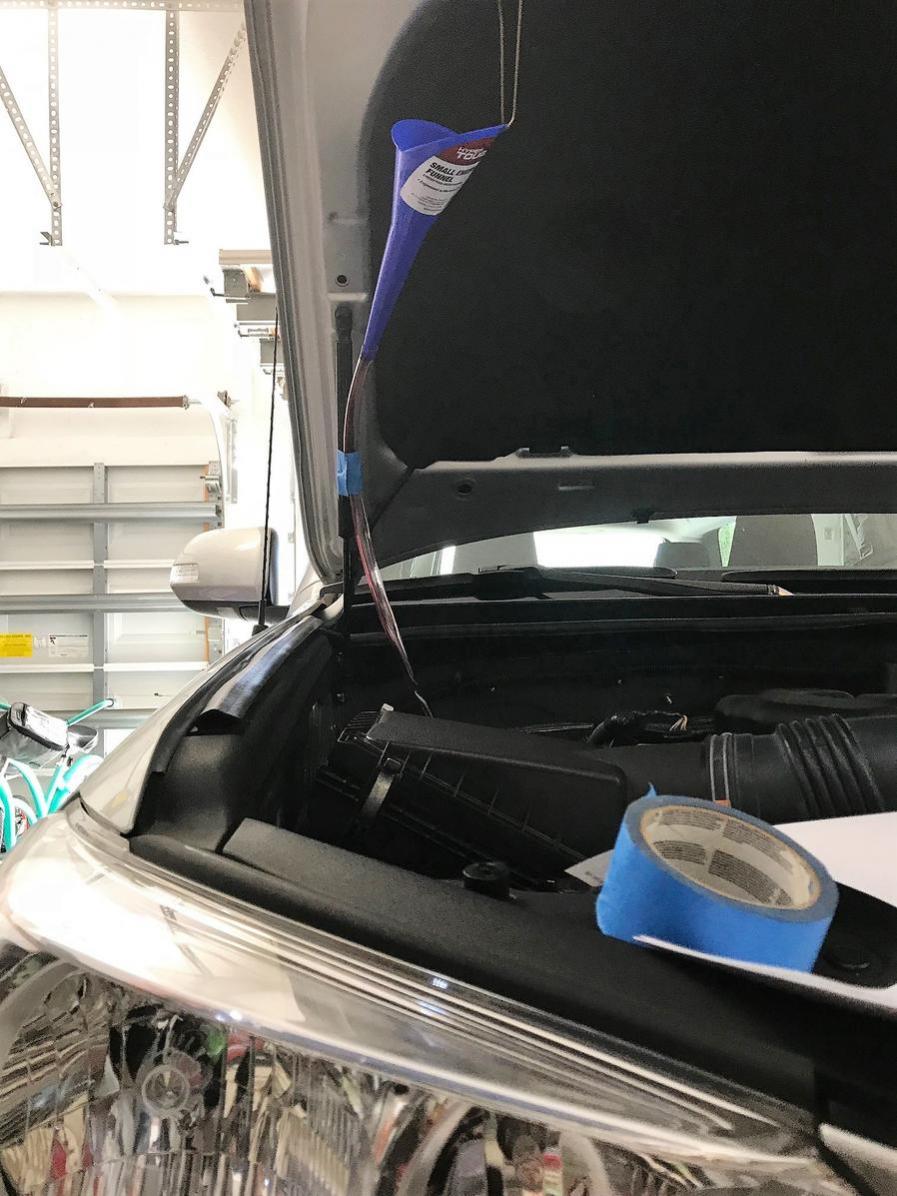

In many of the A750x transmission fluid change threads on the WEB, people mention refilling from below with a hand pump attached to the Toyota WS ATF 1 qt. bottles. That is a time-consuming pain in the ass as you will do this repeatedly for every qt. bottle you use. Refill from above(under the hood). A 6 ft. length of vinyl hose - 5/8 OD-1/2ID and a funnel attached to the fill end. The end that connects to the transmission fill plug will fit snugly. Install it correctly and there will be no worries of it falling out. Pic below of fill funnel and a homemade OBD pin 4/13 jumper. You can buy these "blanks" on ebay and then simply install your own jumper wire.

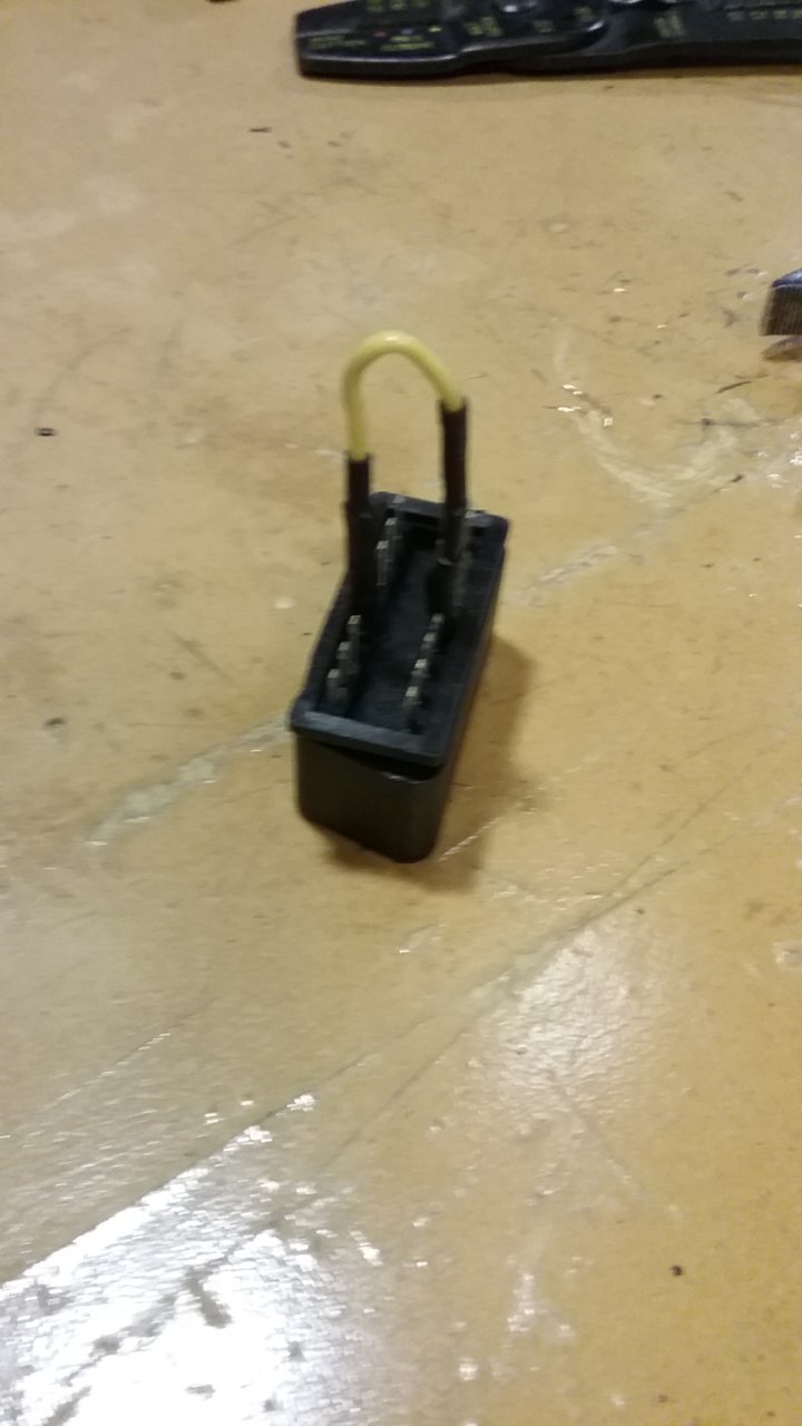

A750E/F - Automatic Transmission Fluid - Adjustment - you do not need the special tool mentioned to jumper OBD ports 4 and 13 - a small paper clip gets the job done.
Funnel Trick hanging of the hood looks familiar.
I found that pic on the web - saved for demo purposes. The point of it was to show people that refilling from the top is easier than filling from below. Did you take the pic?
I don't hang the funnel when refilling. Hose is routed below to fill hole. Hold funnel in one hand - pour with the other. ATF containers lined up on large plastic shroud that sits over radiator. Finish one - grab another.
I'm just kidding around with you. But, yes that is a pic from when I did my fluid change. I found it easy with that set up, just have to pour the fluid in slowly. I had my 10 yr old son under the truck to make sure nothing was pouring back out.
