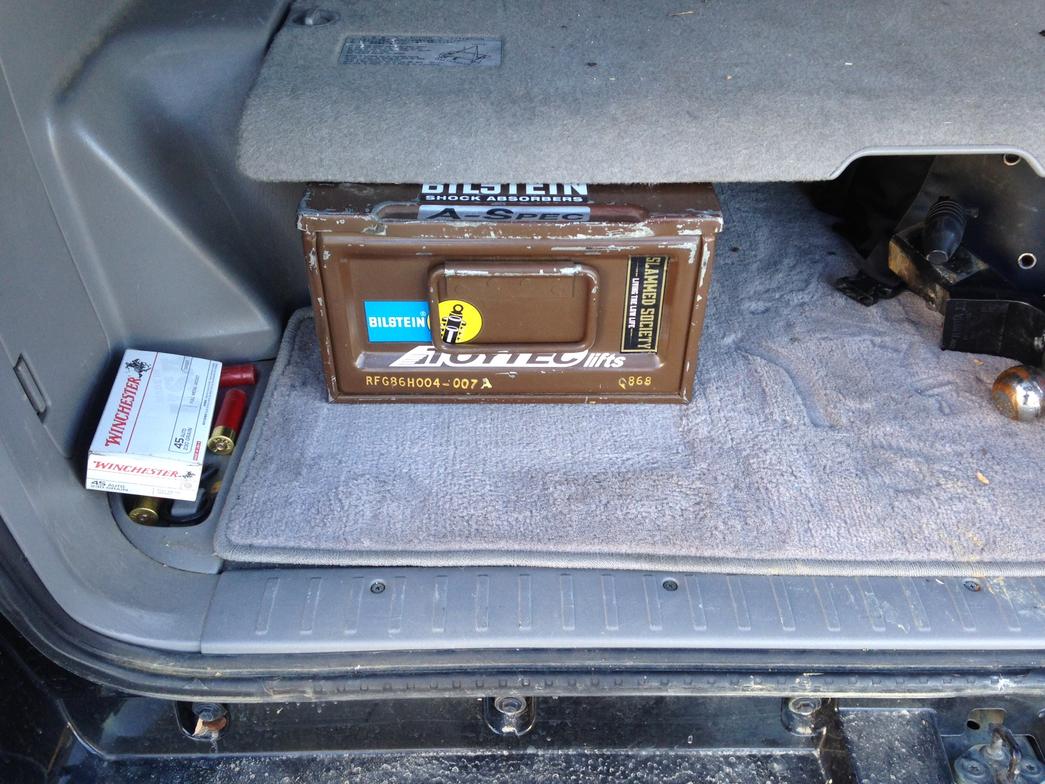

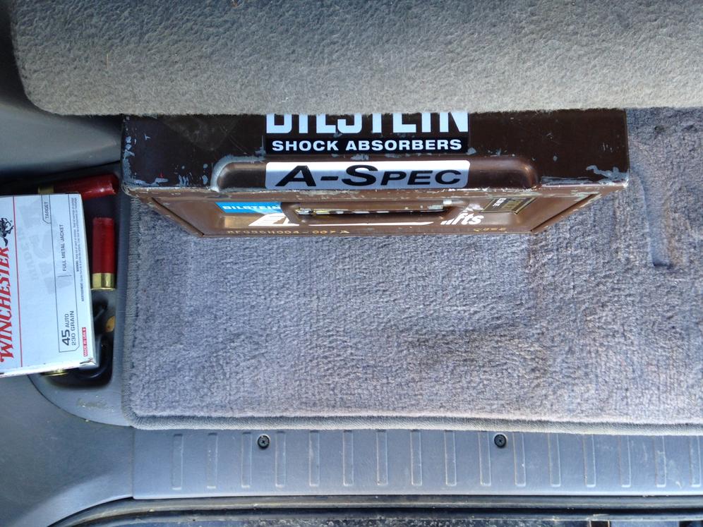

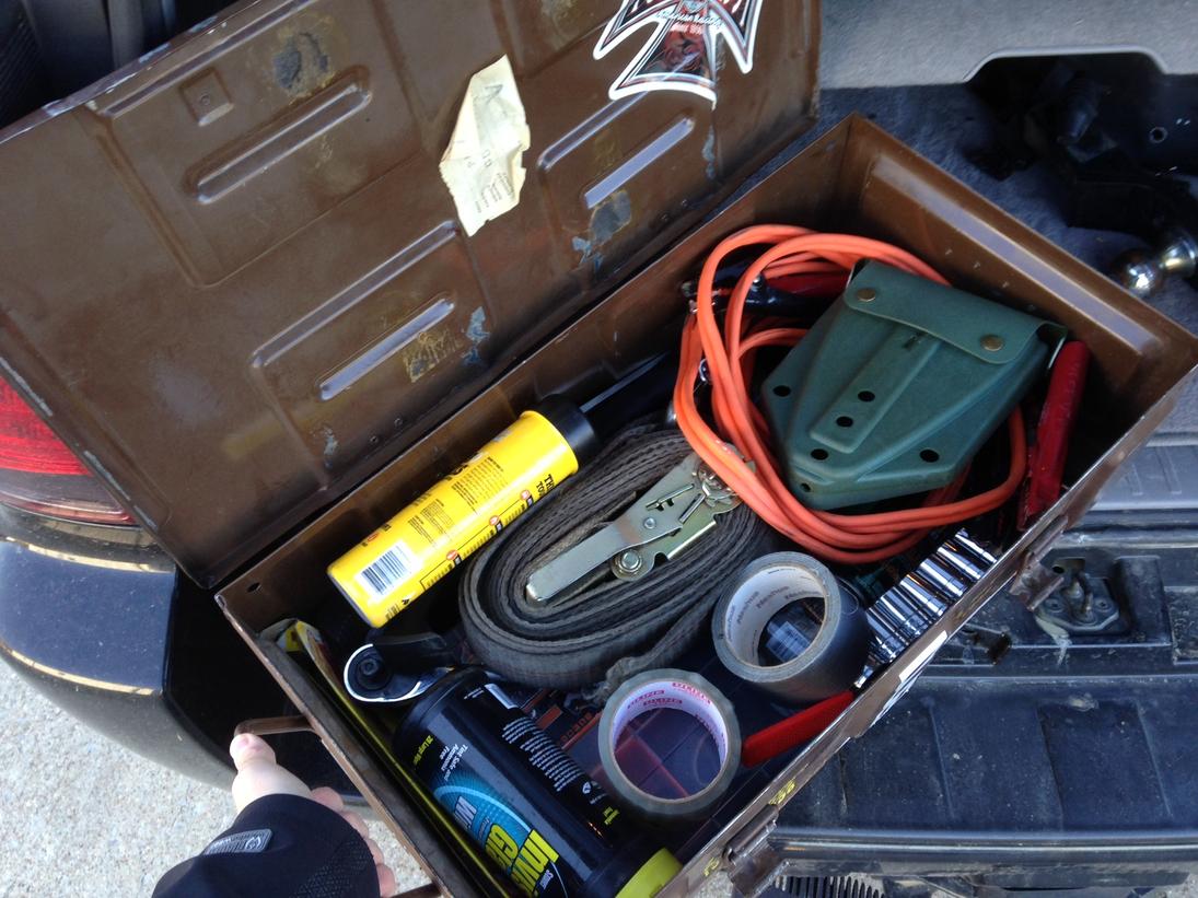

I've been debating about building one or just buying one. I think I'd use the hell out of it.
Currently I have one of these.
Ammo can link
Fits just about perfect under the shelf. I kinda want to put it on a slide of some sort, but I don't think I have the room to give vertically. That's how well it fits.
You could put two side by side and have some room in the middle.

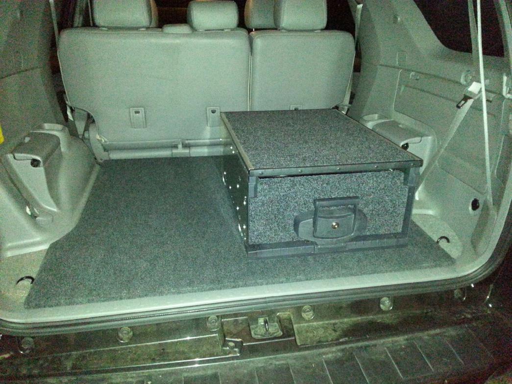

Installed photo??
Can you post pics of the ARB drawer?
The ARB USA website lists a bunch of drawers but no pictures. Just dimensions. These things are pricy like you said and not seeing them installed in the actual vehicle is a deal breaker for me.
Please post up some pictures if you can!

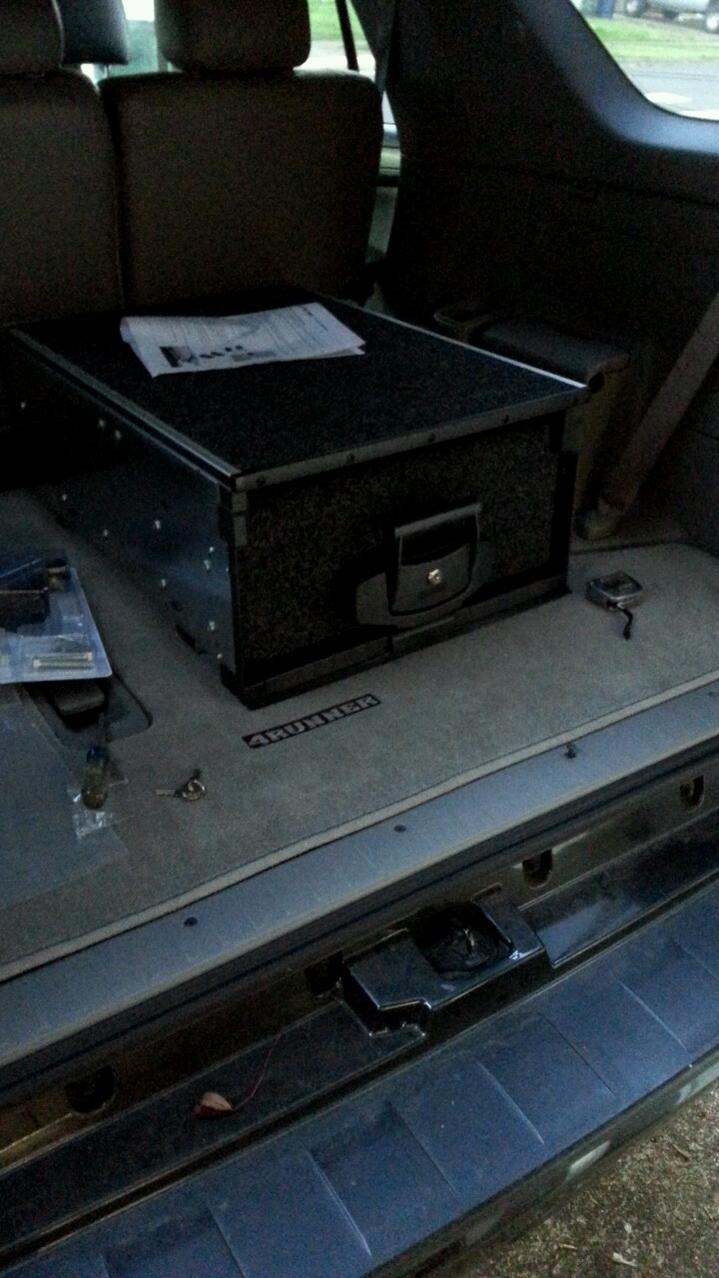

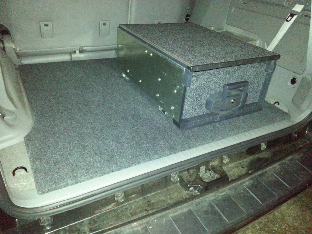

This is what I have right now. If you want something specific just let me know!
For mounting, I took a piece of plywood and cut it to the general shape of the cargo area. Then i glued down some indoor/outdoor carpet and drilled mounting holes in it that lined up with the boxes holes. I can remove the drawer from my 4runner by just pulling out the piece of wood.
EDIT: And my drawer is actually the 29.33"L one - not the 37.20"L I posted above. Same thing, just shorter. I don't think you can get a 37" one in there ...

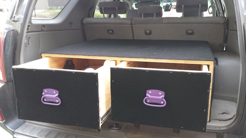

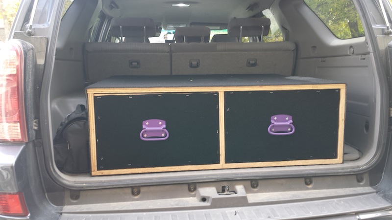

I built my own with no and I mean no woodworking skills whatsoever. I measured a lot before I bought anything. Lowes cuts wood for .25 a cut after the first two cuts!! They aren't perfect but did the job for me. I used 3/4 in plywood/hardwood to fit the entire cargo space. It measures 41 wide..36 deep..12 tall
I'm sure its not the best looking box out there but it turned out better than I thought it would. One side carries tools, jumper cables, oil, etc. The other side has clothes, food, first aid kit, maps, emergency blankets, etc.

Was there any rhyme or reason to the height you made yours?
Not really. I wanted to make it with one drawer at 16 in and one at 8 in tall, to put a fridge on the 8 in side, but after figuring that was out of league. I felt 8 in wasn't enough and 16 in was too much.
I am looking at it from the perspective of I'd rather have more than enough space for everything I wanted to carry with me all the time.
Maybe there was a little, a tall water bottle and an average size cleaning bottle like windex which I keep in there stand up and fit perfectly.
