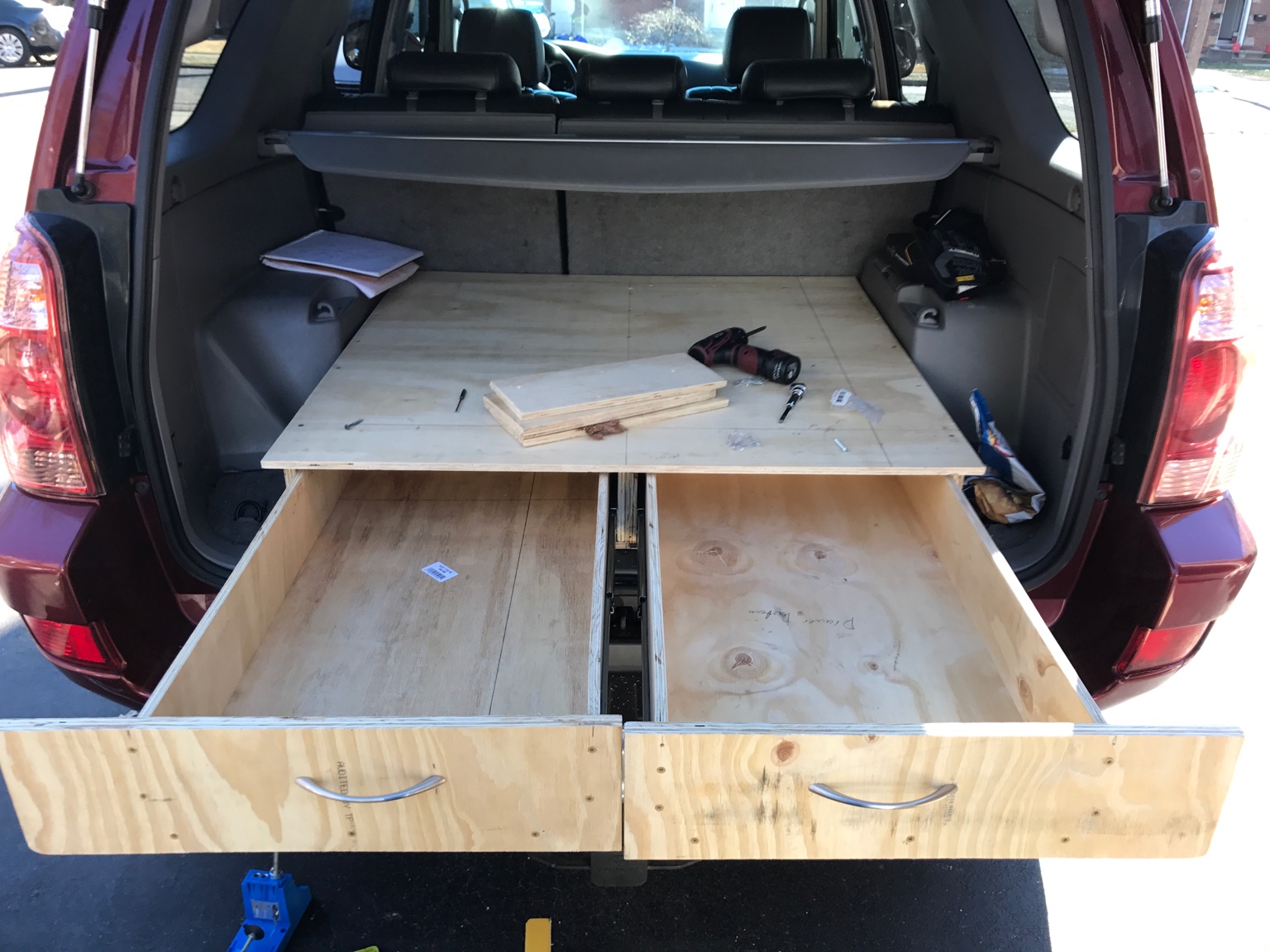

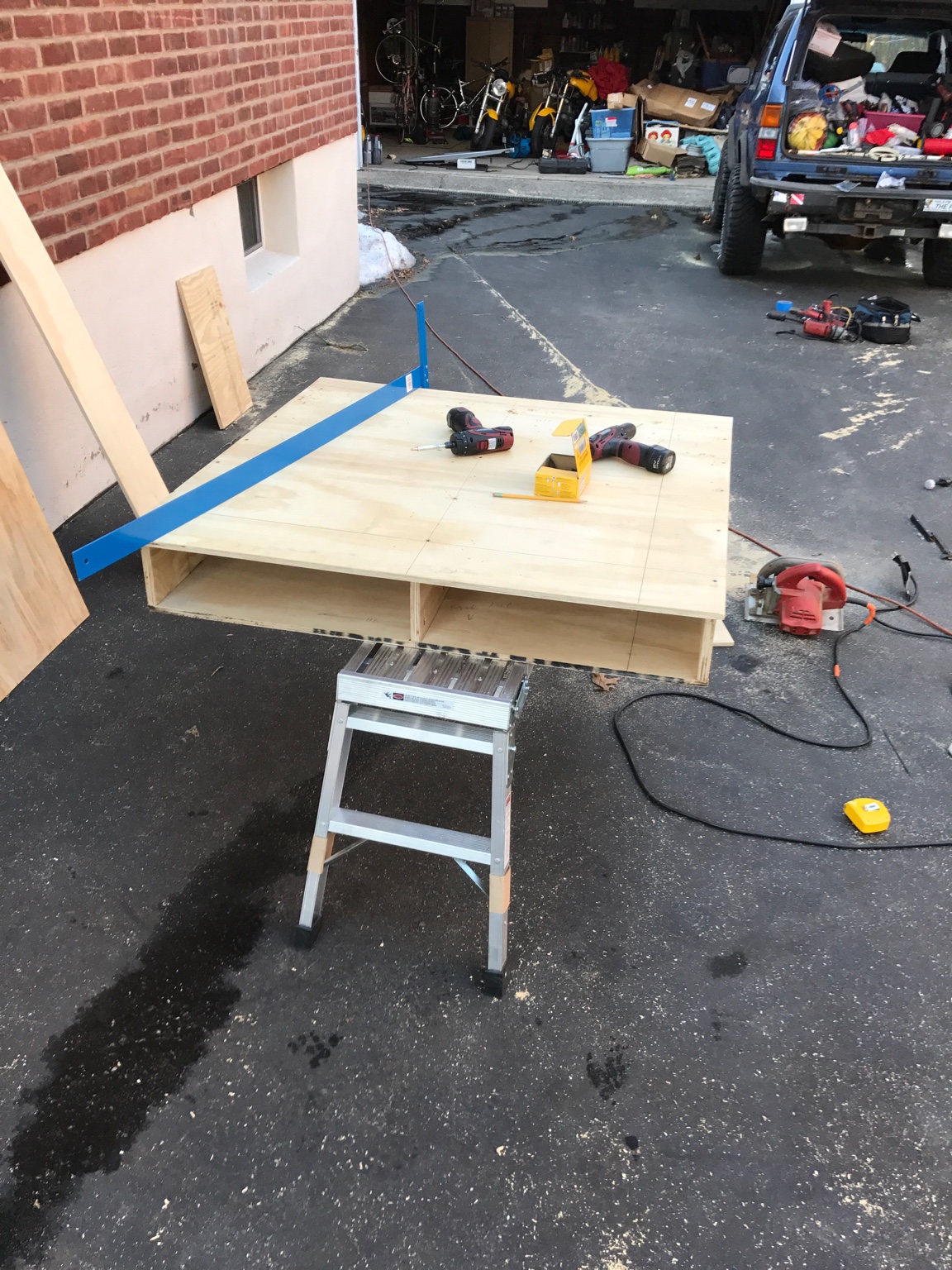

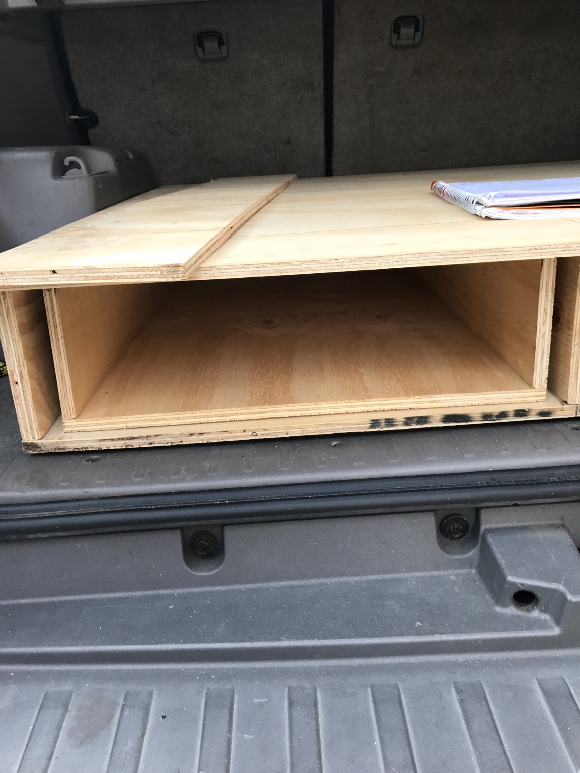

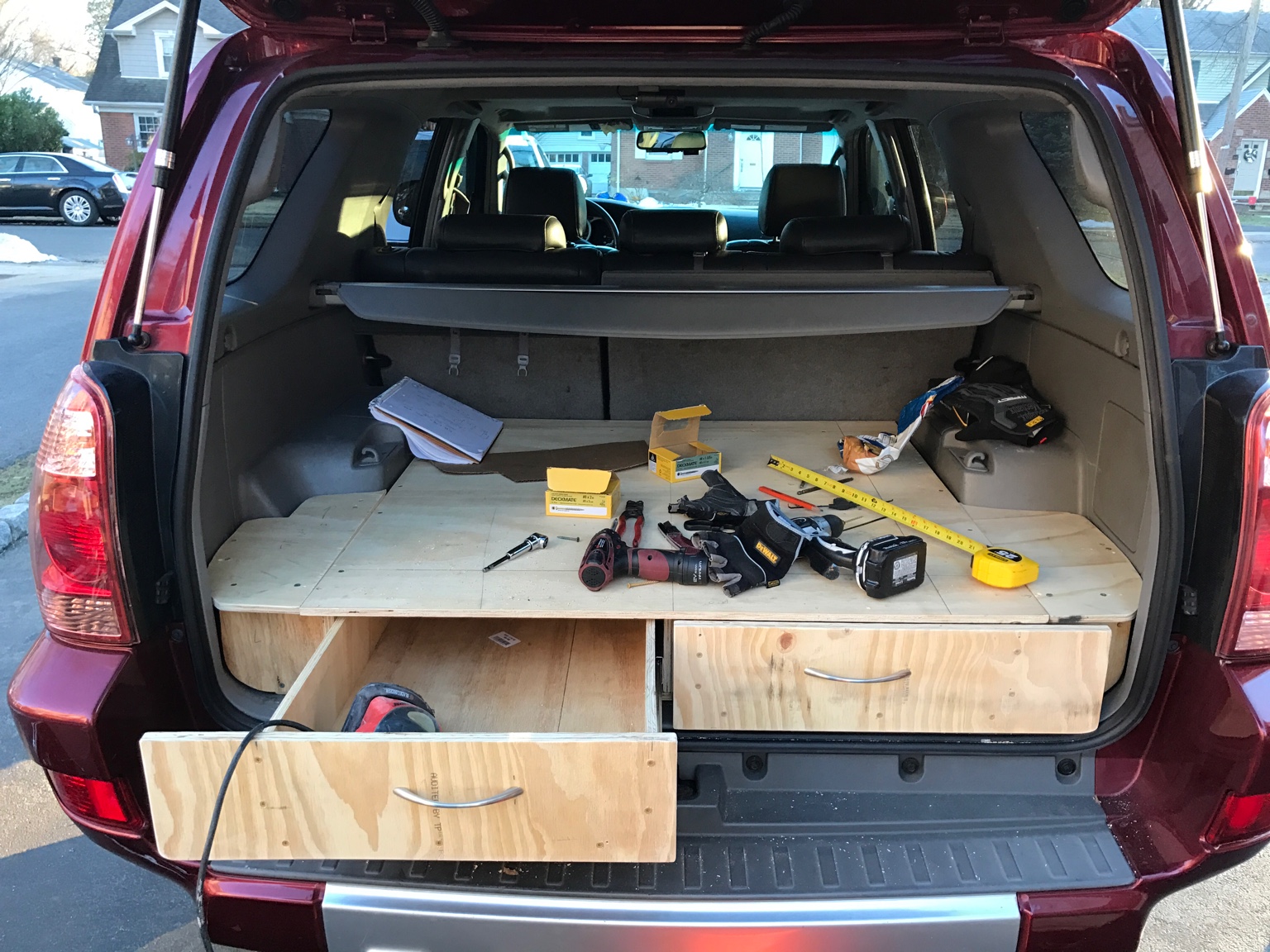

Does anyone who has built their own drawers/platform have the plans or diagram of what they built?

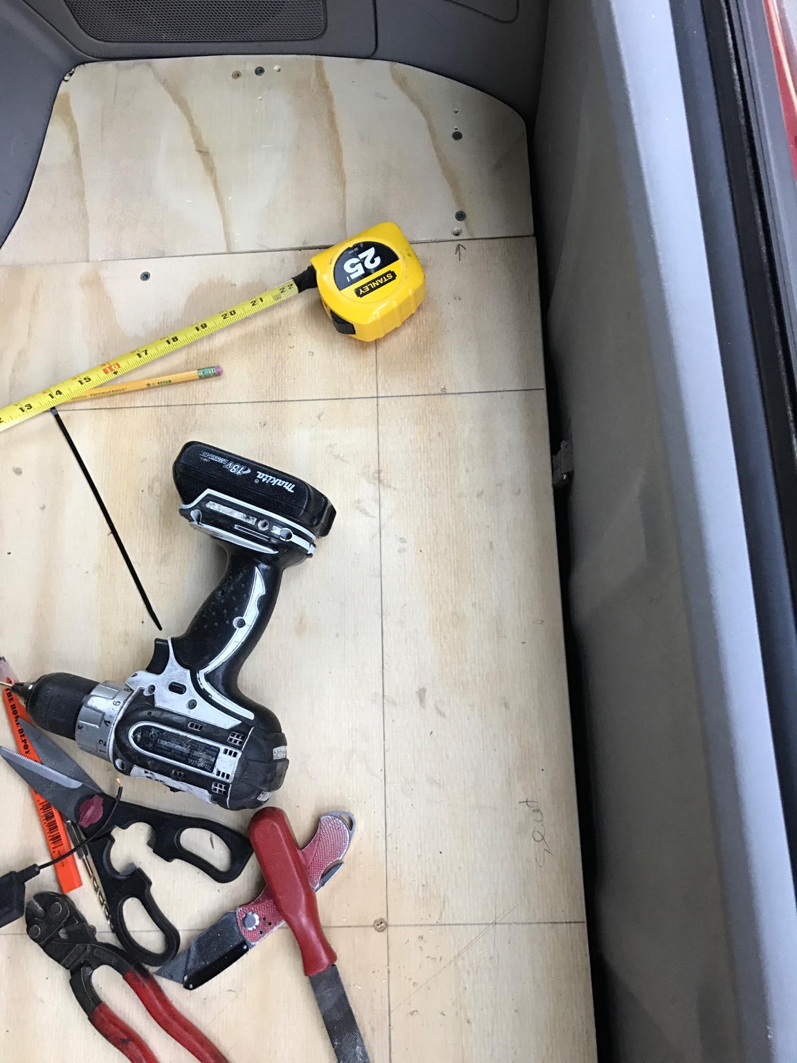

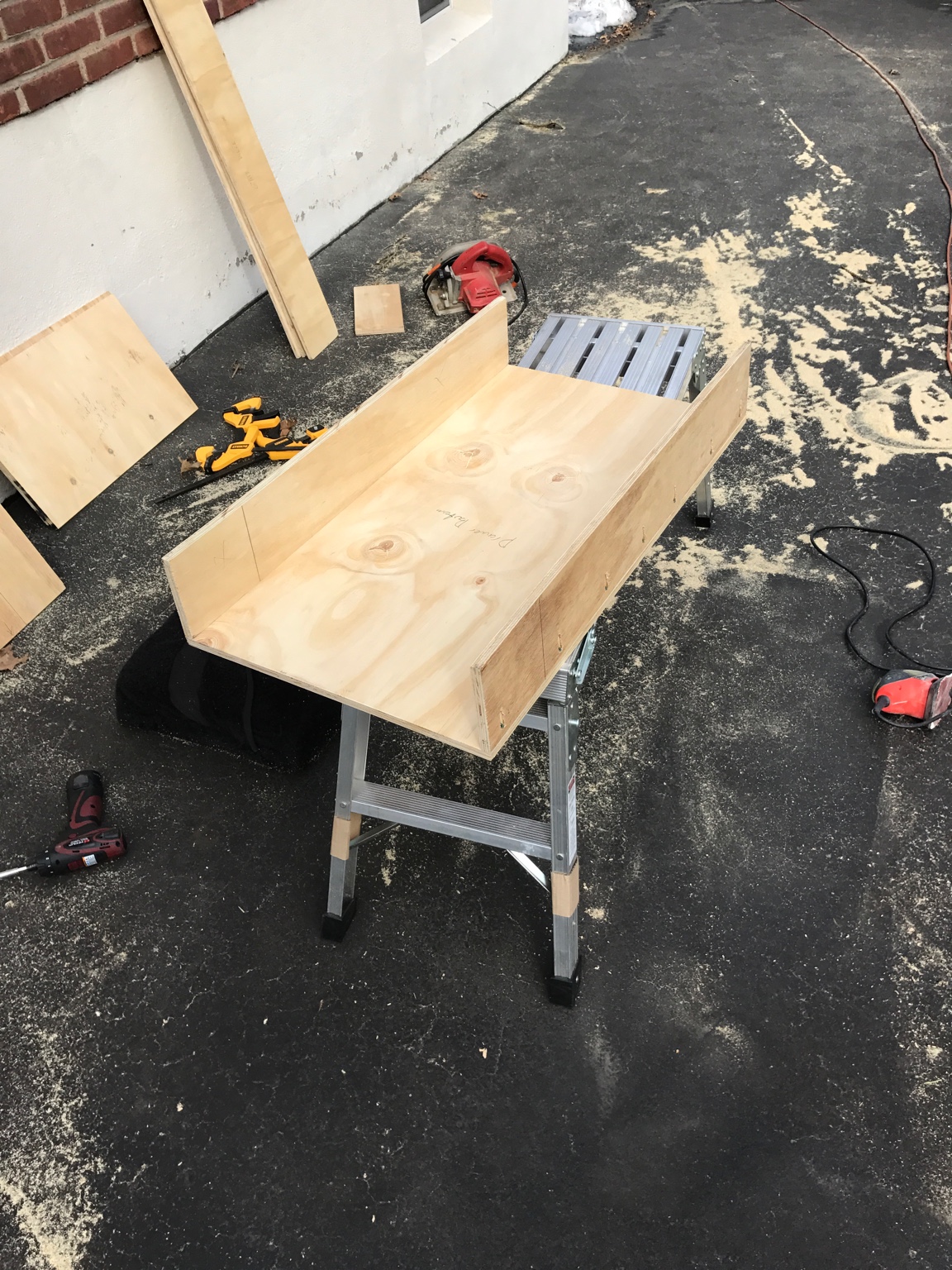

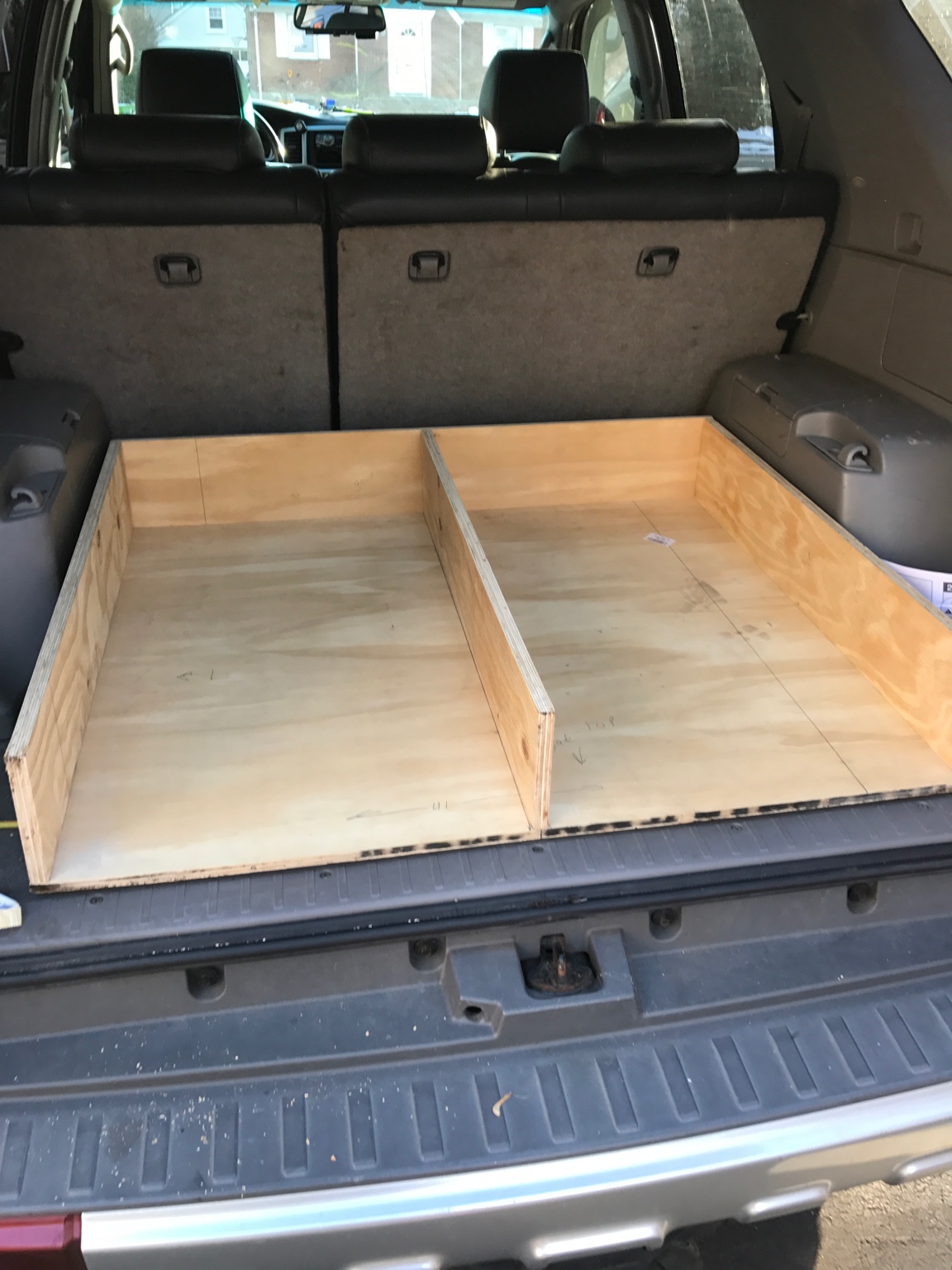

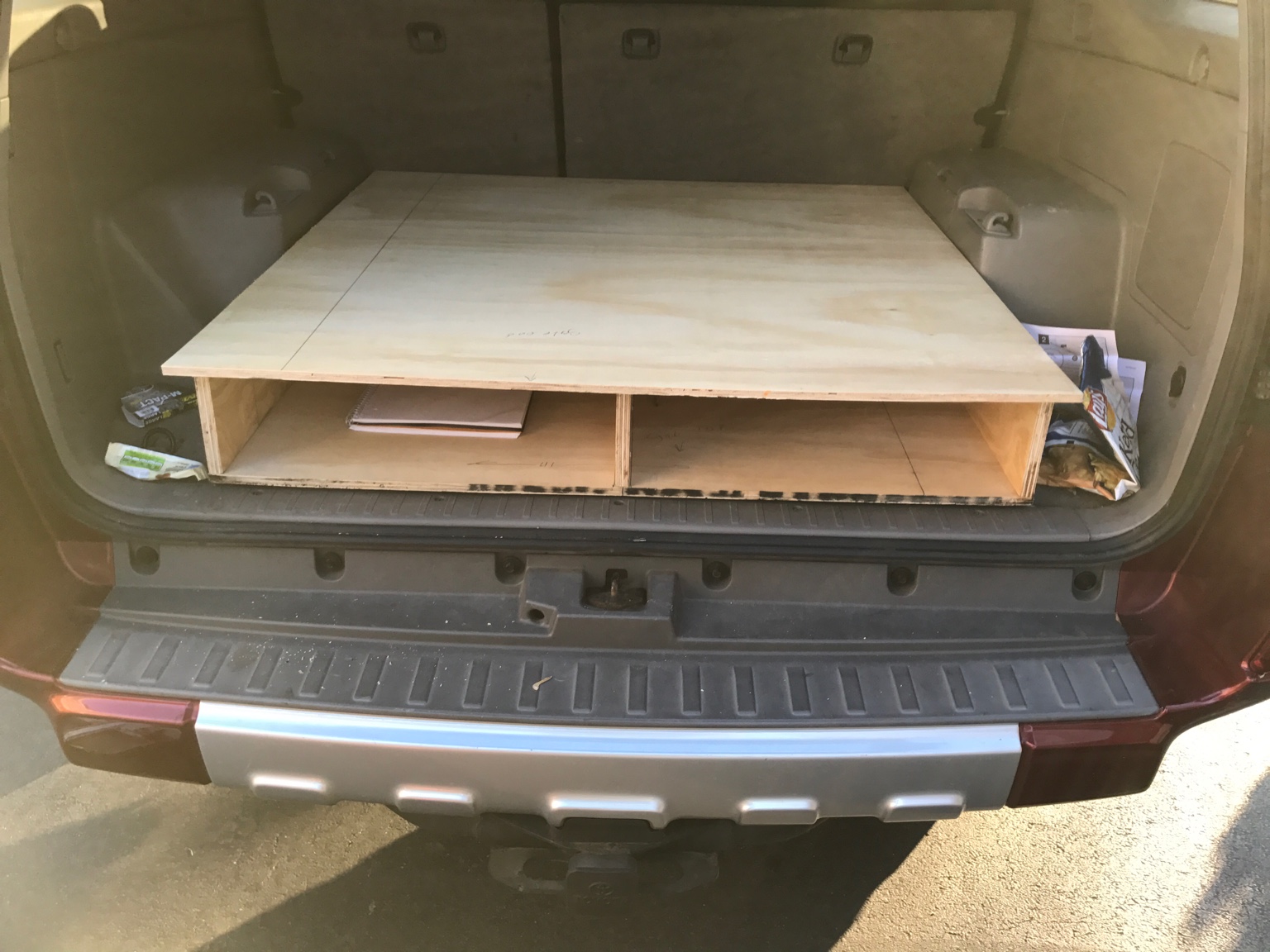

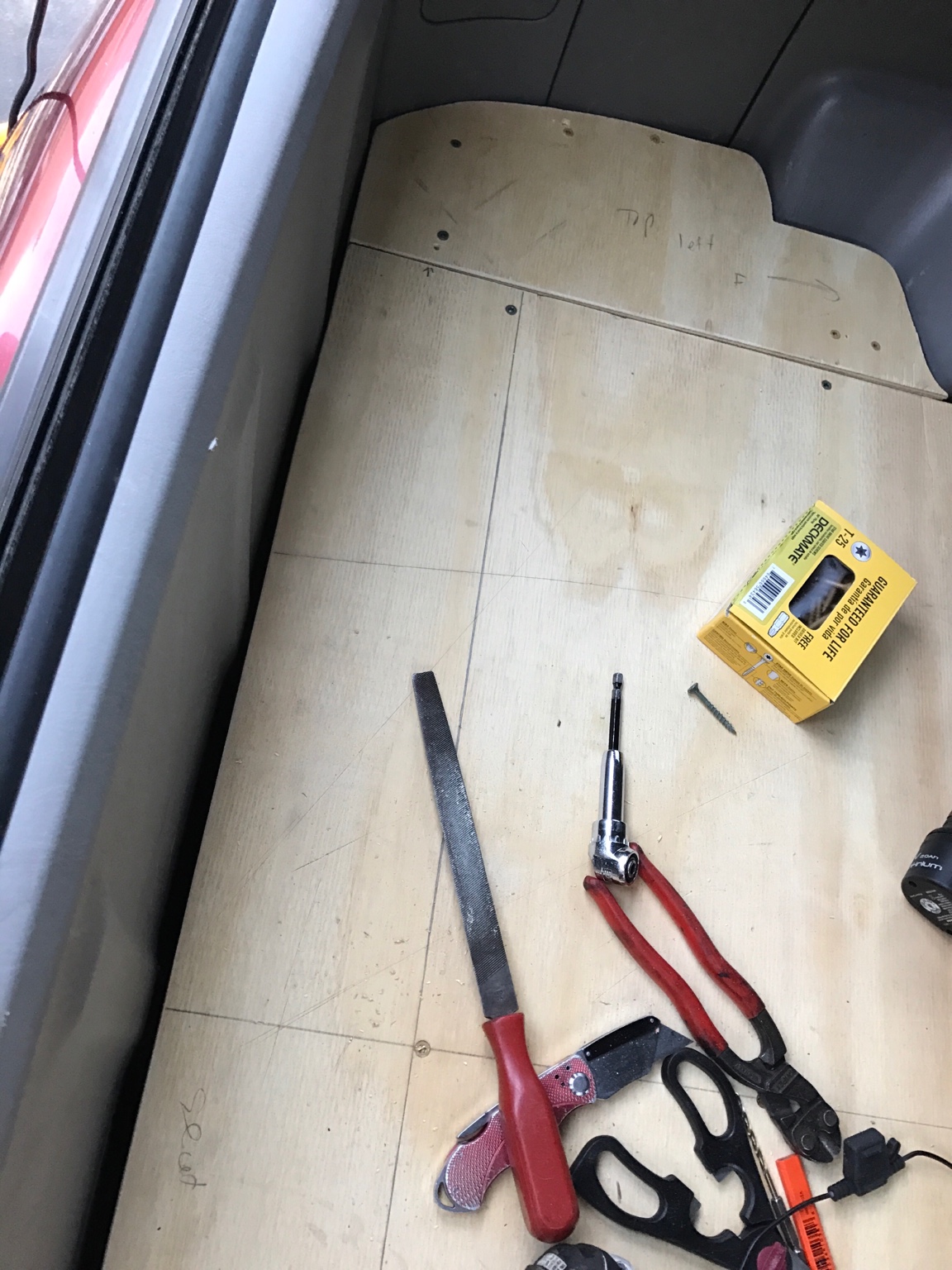

I just built a set myself and can share what I've come up with you you'd like. I did a low profile setup to conserve cargo height.
Total height was 7" with a drawer height of 5 1/2". I designed the side pieces to be easily removable for access to the jack hatch and the rear power outlet.
I'm still deciding if I'm going to cover it with carpet or use the roll of black leather I have kicking around...
Mind sharing your measurements? Your fit is one of the cleanest I've seen.
looks great! any photos of the framework, without the drawers or tops? and is that ½" or ¾" plywood? how much does it weigh?
Thanks! I do car electronics for a living for the last 20+ years so I've done lots of custom builds for audio systems.
It's 1/2" for the top and bottom, 3/4 for the verticals left right and the center is a piece of 1/2 and 3/4 together to make the spacing correct. I used 24" soft close drawer glides from Home Depot. I'd say it's about 50/60lbs.
I'll be happy to share my measurements. I was planning on doing a quick write up once I have some time.
nice, thanks for the extra photos. i like how basic it is. i want to do something just like that in my 4th gen, but come up with some sort of extra fold out platform for sleeping on. i'm 6'5 so it will take some ingenuity...
