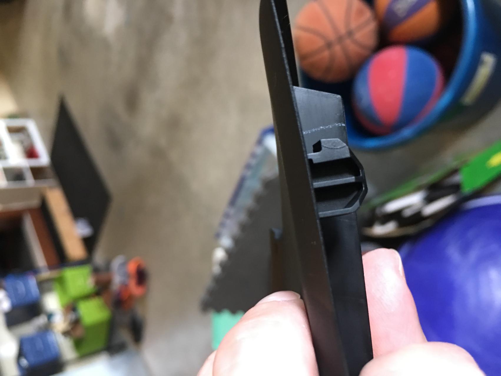

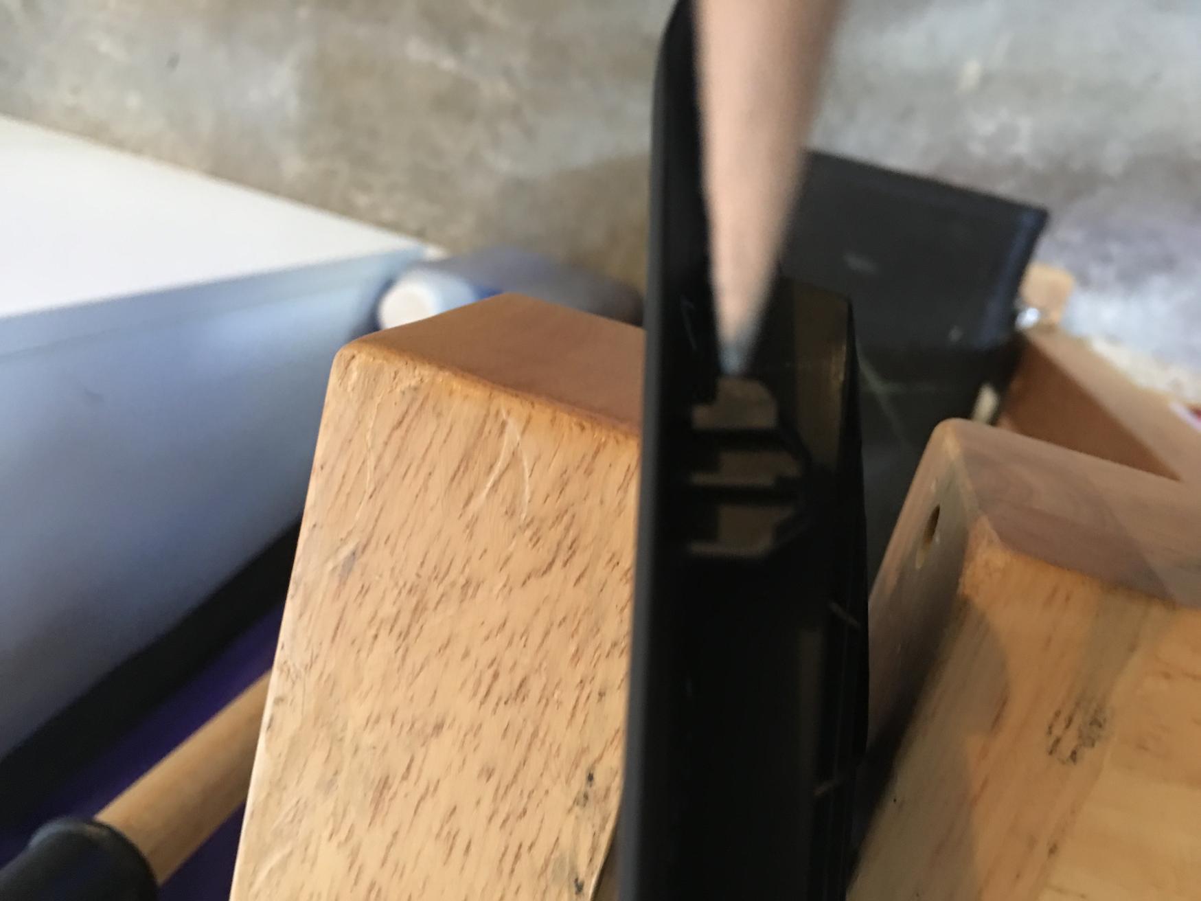

Bummer. Sorry to hear that. Keep us posted on what the dealer says. I have looked at a bunch of 4Runners in parking lots and those caps often look like they are coming out. I literally had to trim a little on mine to get it to snap in tightly. It should really snap down into the cowl. I could not push mine down far enough to get it to snap. This is hard to articulate, but I trimmed a tiny bit off the upper part of the hook clip on the bottom of the cap. I will try to attach a picture but it may be hard to see. I tried pointing with a pencil. Once I shaved a tiny bit off the clip mine snapped down tightly. Shaving that tiny amount allowed it to get under the cowl and snap in. If your dealer’s fix doesn’t work and you need more details let me know.

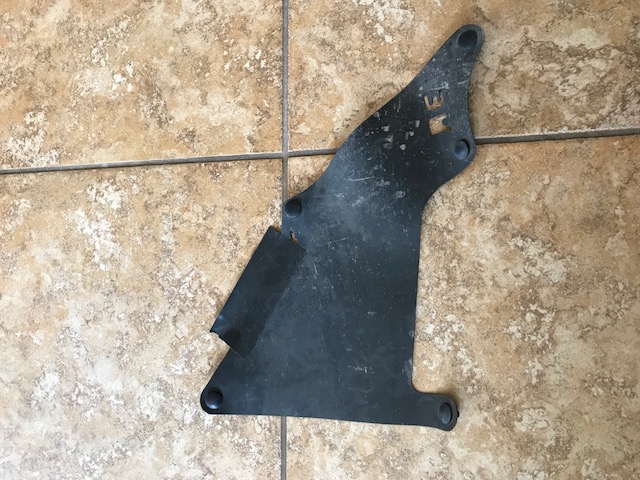

Took the front left wheel/tire off and found this thin, poorly designed fender liner, being held on by rattling plastic pins. You can see where the "Toyota Quality Fix" was attempted with a piece of tape (seen at the 9:00 position in the picture below). Even with the tape on it, it rattled like crazy when I moved it by hand. I have no idea why the tech didn't remove the pins/connectors and replace them (except trying to be cheap). Toyota quality? That's laughable. More like half-#ssed service. I took the whole thing off to check that the problem was fixed and it was.
(My good old iphone loves to rotate pictures. If you rotate the picture 90 degrees clockwise, that is the orientation in which it is on the car.)
