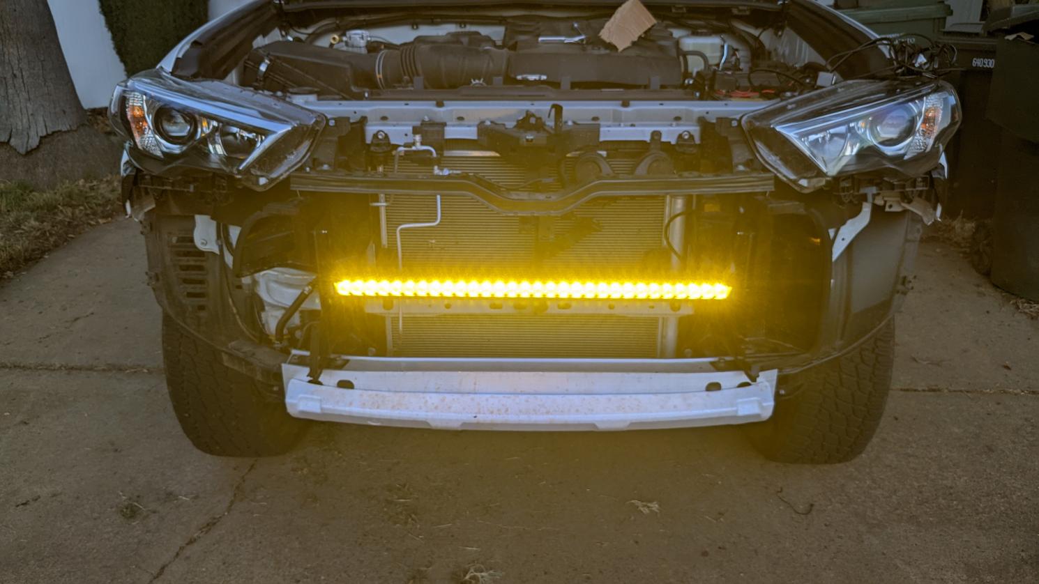

Step 4: Add the brackets (PIC)
Attach the brackets so that they can still be adjusted with medium strength, especially if you're reattaching the air deflectors. If you're not adding the deflectors back, go to Step 6.
Step 5: Add the deflectors.
This is actually two 2 steps: first, slide the deflector over the bracket through the gap you created. If it feels tight at all, go back and cut a bigger hole. You won't want to remove it afterward. Next, reattach the deflector to the frame, keeping a close watch on the 2 clips the go in to the frame. Be firm but careful.
Step 6:
Attach the brackets to the frame. First, Remove the nut in the picture above. (PIC) You can let the bolt hang, but otherwise just take it out so you know where it is. There aren't markings on the brackets; if you can't figure it out, remember, the slope should run closer to the back top to bottom. (PIC) Using the provided hardware from the bumper install package, attach the spacer, bolt/washer, and nut with the bolt head facing inward. (PIC)
Step 7:
Attach the the light bar. For 4runner users the power cord should be on your right. Gather the hardware you need (thumb bolt, washer, locking nut). Lift one side to the height you want. If you have TSS, the lowest setting is the only option. Attach the light bar, and then attach the other side. It may take extra pressure to get the bolt to catch; push hard!
Step 8:
Route the harness. Run the bar connection through the bracket and through the frame to the engine bay. Use painters tape to tape it to the frame.
Step 9:
Wiring harness work. Disconnect the easy connect from the switch to the harness. Or, if you're using an aftermarket switch, snip the female end off completely and tape the wires together. You'll need to pierce the firewall. Check both sides (in the engine bay, and in the cabin) to find an area that wouldn't interfere with any existing wiring. Punch through with either a box cutter, prison shank, or large needle. I used the old "tape wires to the end of a coat hanger" method, and it took a couple attempts to succeed. (PIC)
PRO TIP: If you use a large needle or something smaller, leave it in the hole you punch. It'll be a point of reference later on when you need to find the hole, and you can push the wiring in behind it. Pass the connector or taped wires through the firewall. Pull that wire through using needle nose plies or a coat hanger taped to the end. Give yourself enough slack, there's tons of room in the harness (super helpful).
Step 10: Switch work.
Pull the dash out using trim tools or bare hands. If using the supplied switch, route the female harness end as close as you want and either notch the dash to allow the wire to pass or just tape it to dash and connect the male end. The switch has double sided tape! If using an aftermarket switch, pop out the blank switch you'll be replacing.
Based on the switch style, I knew I would want an OEM-style switch to control the lights, using the existing bank inside the 4runner's cabin. That meant I would have no need for the switch. I tossed the switch aside, knowing full well that the wiring harness would still have enough wire to reach the cabin. Seriously, buy the harness. It's cheaply priced and has tons of value.
Step 11: Connect the wiring to the switch.
Disconnect the battery using a 10mm wrench.
Pop the dashboard loose. I usually just grab the plastic left of the steering wheel, and the left side near the door. I press in on both sides and pull back fluidly.
Find the blank switch on the panel you'll replace and squeeze the backside tabs to pop it loose towards you, not inward. Feed the wires through the switch hole you just created. (PIC)
I didn't want the switch to be lit full time, so I opted to wire the switch as follows. Switch side is (S), (R) is relay
- (S)Black to (R)black
- (S)Red and White to (R)red
- (S)Green to (R)yellow
(PIC)
Step 12: Disconnect the batter using the 10mm and 12mm depending on your needs.
Step 13: Connect the lights.
Connect the harness pieces together. (PIC)
Step 14: Connect the relay.
Connect the relay ring terminals to the battery. If you have an sPod, connect that wiring now. Reconnect battery entirely.
Step 15: Status check
The lights shouldn't be on. The switch shouldn't be illuminated.
Press the switch. If the lights turn on, you're golden. If not, check all connections: relay to battery, switch to relay. If the switch is illuminated full time, swap the accessory wire (usually white, blue, green) to the red relay wire. Otherwise, use a voltimeter to check currents.
Step 16: Cleanup
Tie up any cables in the cabin to static points. Pop the switch in to the panel, and panel to the dash. Mount the relay to a screw inside the engine bay, and tie up any loose cables.
Step 17: Test throw pattern.
If possible, turn the bar on and drive around your neighborhood at night. Test the bar's direction, and if adjustment is needed, make them now.
Step 18: Re attach bumper, making sure the fog lights, TSS and light bar are connected.
