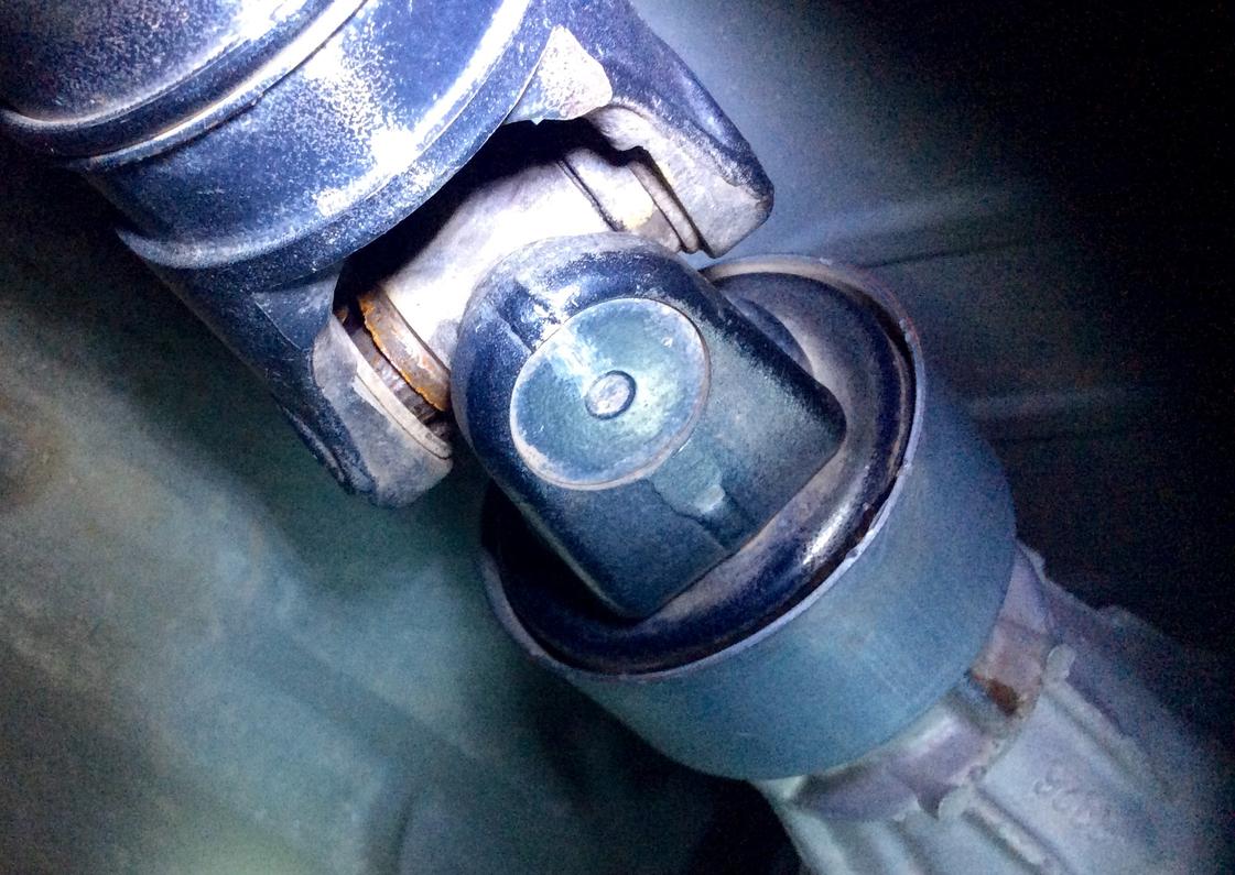

As I read this thread and before I got to this part ...I said to myself it's your driveshaft not your tranny. Here was mine just a couple days 2003 @285k
