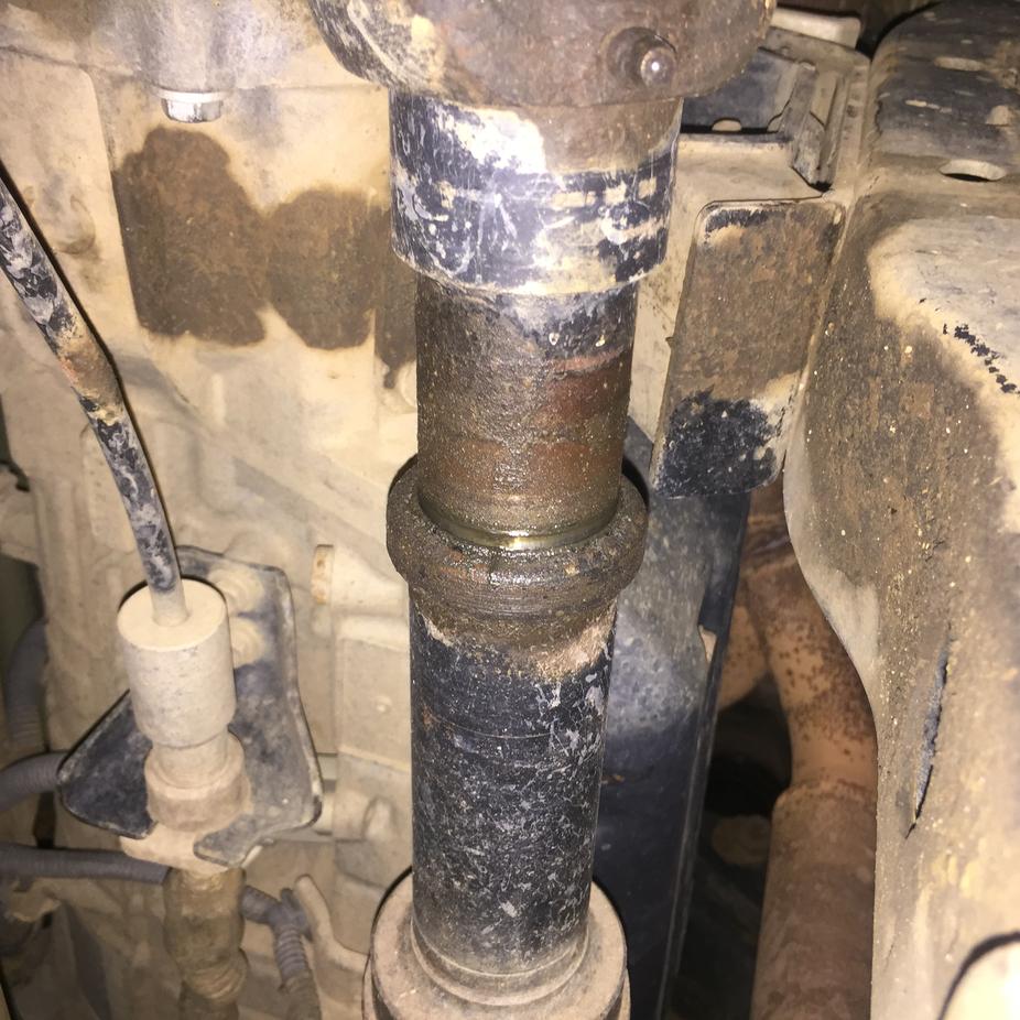

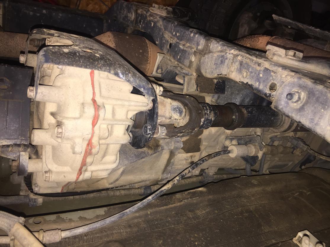

I've 177k on my '04 V8 Sport. About six months ago I had the t-case seal replaced, now I see some other leaking in my drive-line. What could this be?
Apologies for the angle of the shots, I edited them twice and uploaded them three times and they still are sideways or upside-down.
Thx.

Normal grease leaking from the driveshaft. Wipe it up if you want, but it's just excess grease leaking from the slip joint and zerks and getting sprayed everywhere when your driveshaft spins.
They must have serviced it when you took it in a while back, which is good.

I concur with Inv4drZm, you have nothing to worry about, it's just grease and shows that they greased the slip joint!
