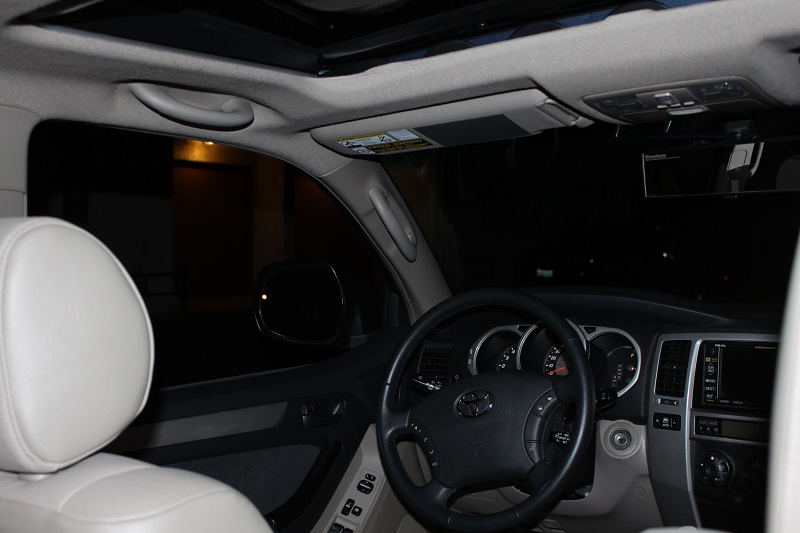

If you look where there should be one on the driver's side, there are two filler caps. Pop them open and unscrew them. Re-use those screws for the handle. If you look at the headliner above the driver's door it will make sense.

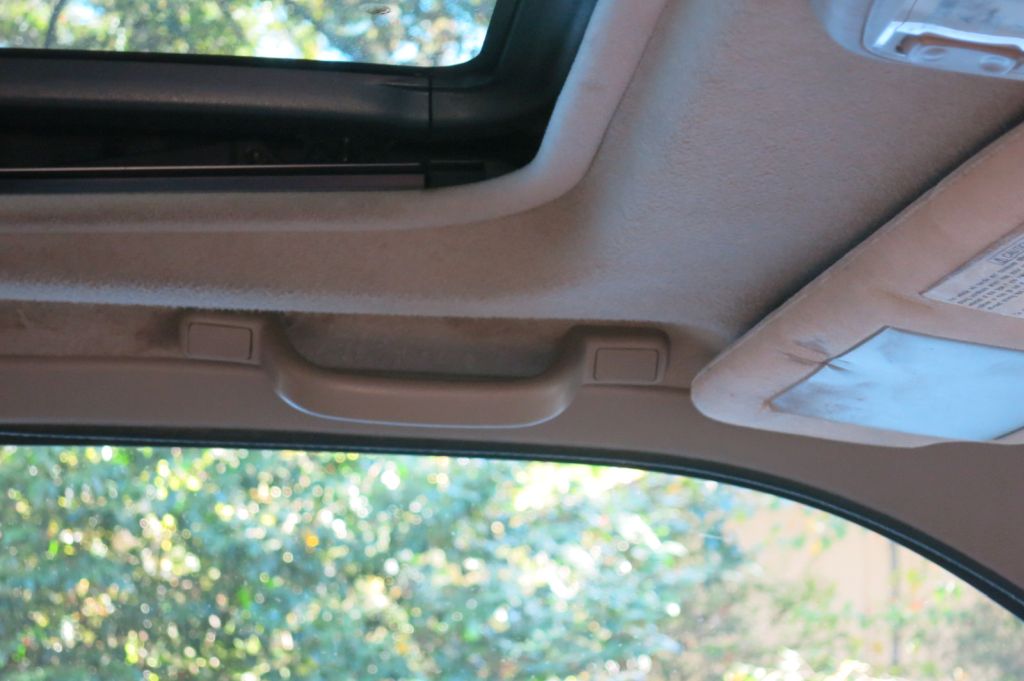

Yes there is a spot for it. It was the very first mod I ever did on my truck. Buy a passenger handle. It screws right on.

I bought a used grab handle for my 1999 4Runner on eBay ($15 + $10 shipping). It looks new and came with the screws. The roof frame is already drilled and tapped for the screws. I found the holes by probing with a needle. It mounts in exactly the same position as the one on the passenger side. Install took about 2 minutes. I am 5'8" and it's nowhere near my head. If you are over 6' then sit in the passenger seat to see if the handle there bothers you before getting one.

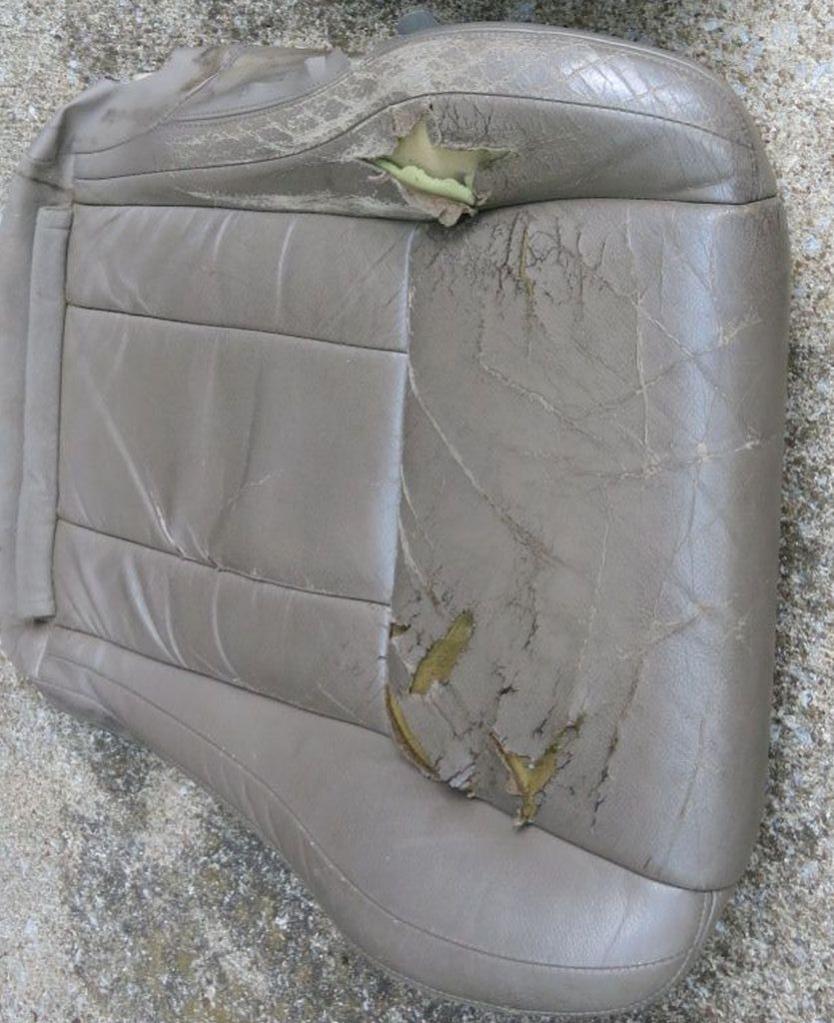

One of the main benefits of the new grab bar is that it will keep the driver's seat from wearing out! Why? People of short or average height swing their left leg out, it doesn't reach the ground, so they slide off the seat edge with their full weight on the seat edge, wearing out the left edge of the driver's seat. Look at the driver's seat of any high mileage 4Runner for sale. Tall drivers may be able to reach the ground with their left leg to support some of their weight while exiting. Or you can step on the running board, or use the new grab bar to support some of your wight while sliding out. Picture shows the wear I'm talking about on my driver's seat bottom before I reupholstered it. Note the inner side of the driver's seat is always not worn much at all.
