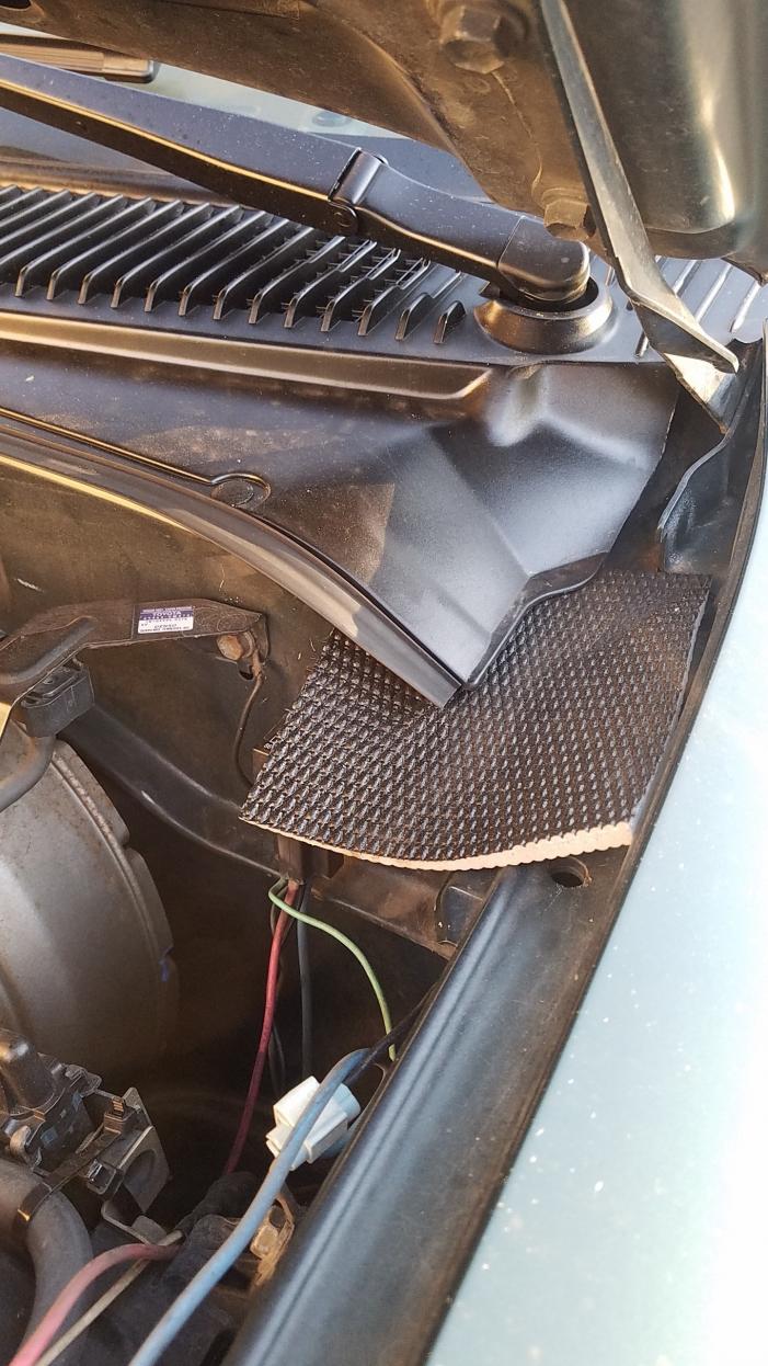

Also, there is an easy way to divert water from coming down the windshield and pouring over the firewall grommet many of us have pulled auxiliary wires through. See here: https://www.toyota-4runner.org/3rd-gen-t4rs/265500-fixed-firewall-grommet-leak-driver%92s-side.html
I see water dripping from above the floorpan near the fuse box so I doubt it's the round plastic plug, and it leaks when it's just sitting, not driving.
Thanks for the diverter idea. I don't have any aux wires going through, but it looks like a likely source.

For me recently it was definitely the firewall grommet. I pulled the carpet back & traced the wetness to there. Touched it up with some silicone on the engine bay side and planning to add a diverter as well.
