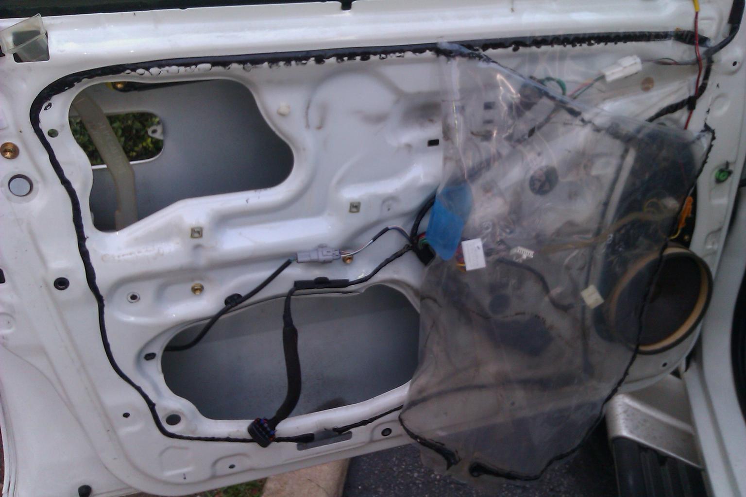

Getting the actuator out
This was the hard part. I'll try to remember all the steps. It is mostly a pain because, as you can see from the picture of the door, the openings are way too small, so you have little visibility or room to work. Just yell out a curse word every now and then and you will feel better. :) (most of these steps are in no particular order.. you really just take things off until the actuator comes out.)
1. Take out the 3 bolts that hold in the door latch.
2. When you look at the door from inside, right where the actuator is, there are two bolts (you can see them in my picture). Take out the 1 bolt on the left. That is what actually holds the actuator in place.
3. Remove the plug that attaches the wires to the actuator. You just have to squeeze hard on the sides to get it free. You can do this either before or after the actuator comes out. It's actually easier after.
4. Underneath the latch, there is one bolt that holds the bottom of the window track. You will need to remove that. Don't worry, the window is still secure, it just needs to be all the way up throughout all this.
5. Remove outside handle/lock. I'm going to call this step optional because I know people can get to the actuator without doing this, but I found it really difficult to detach the two metal rods (one to lock, one to handle) without removing the whole assembly. If you are going to remove it, there are 2 bolts on the inside to remove, one on each side. The left one is much easier to remove if you use the hole in the door to access it. Once it is loose, you may have to remove the small metal clip that holds the lock in. Then detach the 2 plastic clips (mine were pink and yellow) that hold the rods to the outside door handle.
6. The last rod that can be removed is the one going up to the manual lock knob. You could probably get to the plastic piece and detach the rod like the others, but I found it difficult to access the clip. Instead, I unscrewed the lock knob and pulled the rod through the plastic sleeve as I removed the actuator.
7. The actuator should now be completely free. Put your hand around it and slowly pull it out and you get everything else out of the way. You'll have to make sure the 4 rods aren't getting snagged on anything and also bend the window track out of the way. Don't worry, the window track is fine once you bolt it back in. Bend it as much as you need to.

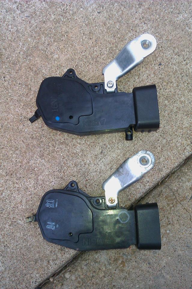

Replacing the actuator
The actuator should now be completely free. If I were you, I'd plug the lock/window control panel back in and plug your old actuator back into the wires (while it's all dangling free). That way you can press the lock/unlock buttons and if the actuator tip is not moving, you know conclusively that is the problem.
If it's totally shot, like mine was, replace the old with the new and do everything in the reverse order to reassemble. That was not as easy for me as it sounds, of course. :) For me, I had to do the disassemble/reassemble 3 times because the metal rods are finicky. If they got bent a little in the process your lock knob or inside handle could end up being a little sticky and you need to open it back up and bend the rod back how it was.
Anyway, wanted to give my story as someone with no mechanic experience to hopefully help others. Ended up taking maybe 6-8 hours, but I was learning everything as I went. In the end, it worked and saved us a lot of money.
