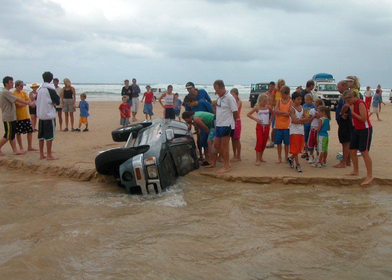

I'll second everyone elses advice, 4wd at all times, A/T tread, 15-20 psi, mild driving style. Avoid driving 2hrs either side of high tide. For cruising drive just above the wave line where the sand is moist and compressed, but DO NOT STOP here or else you'll sink in seconds. If you need to turn around then always try to turn away from the water. When stopping, reverse up a couple of yards so you have compressed sand in front of you. If you only have one piece of recovery equipment, make it a shovel. Watch out for freshwater creek crossings, slow down when crossing these. Watch your gas consumption, you'll get less then 10 mpg in the sand. Drive directly up and down sand dunes, not on an angle or you might roll. Check the other side of the dune before blindly flying over the peak. Dont end up like this 2nd gen 4Runner....

greyghost4x4 said:
Techno, please explain what happened in that photo. Thats an amazing pic, but it sucks for the owner.
Evan
I really don't know the exact circumstances (this pic is all over the internet) but I do know it is on Fraser Island, Qld Australia and probably at Eli Creek. I assume the driver got stuck crossing the creek and when the tide came in the waves simply washed the sand out from under the tires and down it went. Just like when you are standing on the beach and you can feel yourself sinking when the water recedes around your feet. Fraser Island is the worlds largest sand island and is a fantastic place to visit. A search on youtube will give you loads of videos from there.
