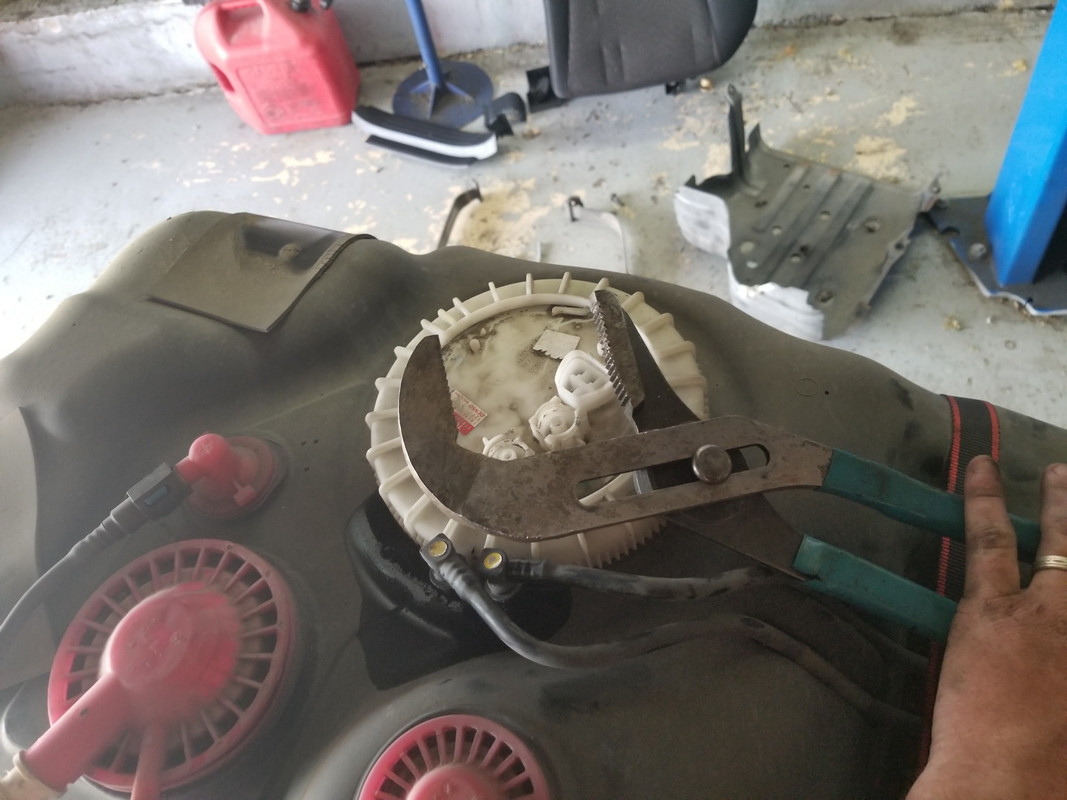

It's been couple of years since I've done this project but I opened up the large locking ring on top of the fuel tank and peaked inside. I don't recall needing any SSTs at that time. Maybe I scratched my head for a bit then used a screwdriver or something to help with the removal of the large o ring nut thing.
Where Toyota screwed up was that this hole is not large enough to pull the fuel pump out of so I had to drop the fuel tank. The tank did have lots of crud that clogged up the fuel pump inlet which led to fuel starvation at the engine. My guess is that the original owner contributed to the crud and it was floating on top. It was reddish colored material. Dropping the tank, removing the fuel pump assembly then cleaning out everything the old fashion way is the best way clean your tank.
I've been looking for a good DIY thread on this but haven't had much luck. I need to drop my tank to replace the sending unit for the fuel gauge. It hasn't done it lately but a few months ago the readings were going all over the place. I didn't realize a SST was needed. I thought it just required a big strap wrench.
I have strap wrenches but don't recall using one. I think what I did was to use a flathead screwdriver against one of the "tooth". Then I tapped the screwdriver head lightly until the ring started to move. Again, this is going off of my memory!
This is what I used on a 4th gen and my 5th gen.
I grabbed it straight up and down not sideways. I would be weary about tapping it with a screw driver.
