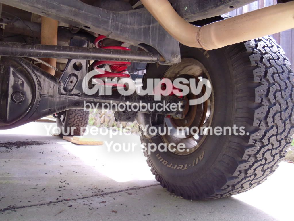

So when I bought my rig, the PO had done the mod w/Sky Manf. brackets and Eldo front disk calipers (no e-brake tabs/levers). I looked into new calipers about $170 for a deal on them, but the cable system design seemed a little problematic routing and creating a nautulis like gear for increased cable take up required for those calipers. I've been researching manual line locks, but they all seem to bleed pressure over time and may create a situation for premature seal wear. I will most likely end up buying Sky's transfercase brake system, and then try to modify it work with the V6 chain drive t-case.
Here's a picture
005-1.jpg~original
I haven't had the same issues with brakes that driffter33 mentions that would be helped by using a proportioning valve, but I might try that.
