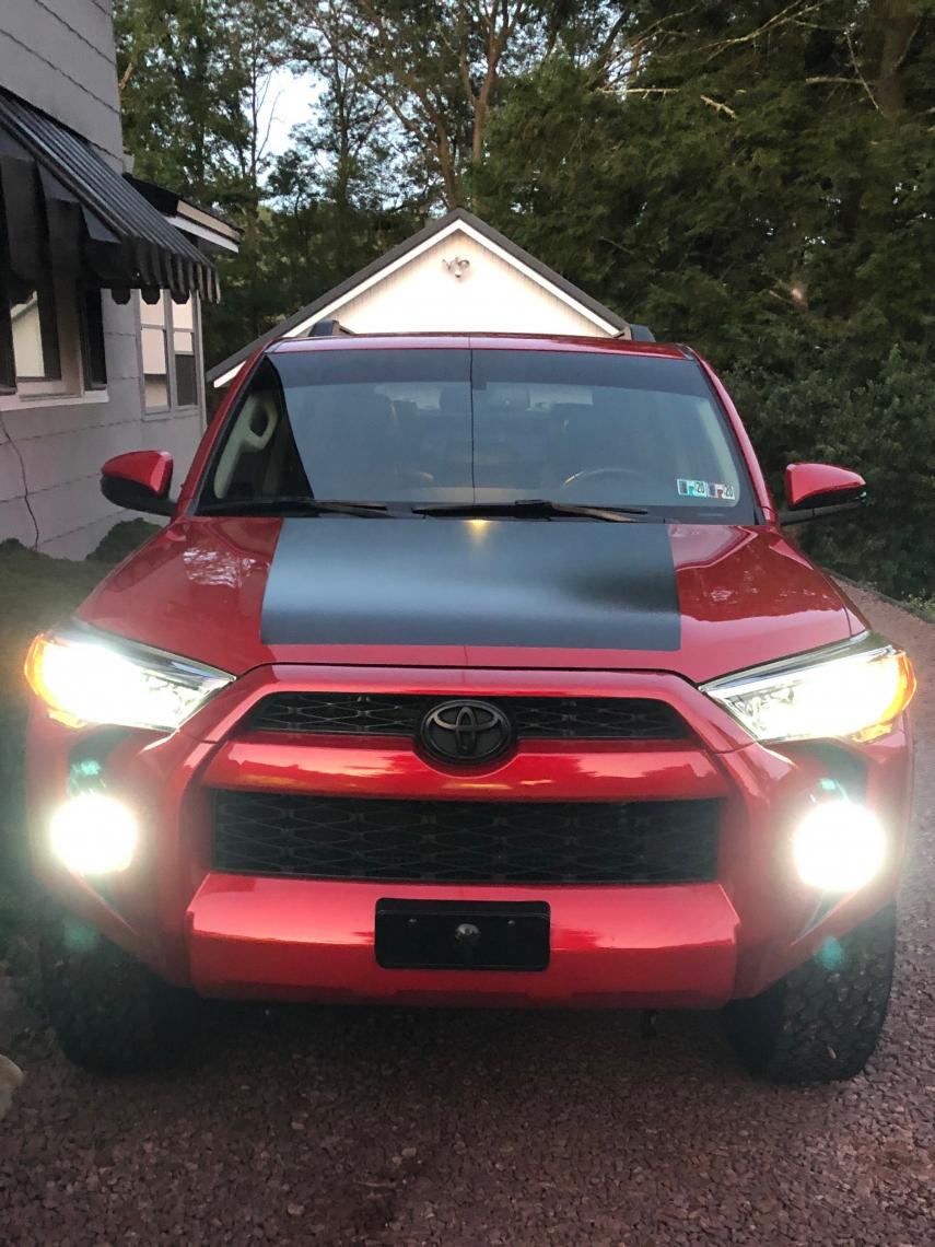

Got the headlights installed very happy with the results.Way better than the stock halogens for sure!

Very interesting setup and looks great installed!
I am looking to replace the low's and fogs of our 2014 Limited and have seen nothing from LED's other than these that appear to make any sense. Any shots from night time or opinions about light output at night?
any tips for the install? I nearly pulled the bundle trigger but read the comment above about the fan / heat-sink that made me a little nervous.
Can you also post the beam pattern comparison between this LED bulbs and the stock bulbs? The beam pattern on the ground is preferred compared to the wall. I asked [MENTION=343791]DRZ-Off-Road[/MENTION] for the same, no response.
Don't have a beam comparison as the stock bulbs are out.Beam pattern is good better than stock for sure.Light output is really good compared to the halogens.I am happy with the results.
Do you have any picture you could upload? Night time against a wall would be enough. Thanks!
