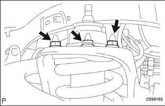

So I attempted to do the lift myself; I just got spooked at this point in the instructions as shown in the picture, I am to remove these 3 nuts.
Problem was that when I do (in my mind), isnt there pressure under just waiting to be released when the nuts are off? :jaw drop:

Loosening the 3 nuts will do nothing at all.. Those 3 hold the coil assembly into place. Don't be scared, nothing will fly out at you.. Look around there are tons of pics..
The single 17mm or 19mm above your arrows holds the coil assembly together, I would not suggest loosening that one lol..

Theoretically when I loosen all that the directions here call for this is just to gain wiggle room to add the spacer?
your link didnt work, "wiggle room" is gonna be harder than it sounds, but you will figure it out.. And remember nothing is gonna fly out or attack..
