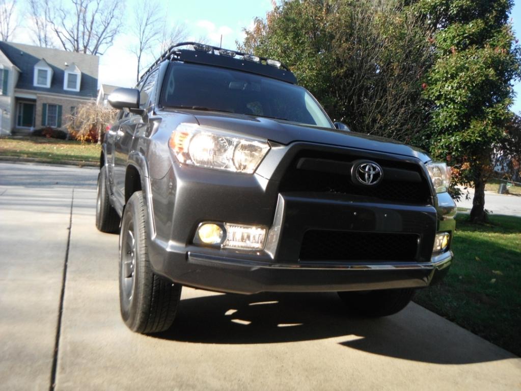

goal is to have them operate as if headlights are not on, so you have on the headlights/fogs/dtrl or headlights/highbeams/dtrl at the same time
example of this on a 5th gen

Sorry for the blurry pic and I know yours in 09' but like this? I can have headlights on/off, fogs on/off, DRL on/off all independent of each other.
