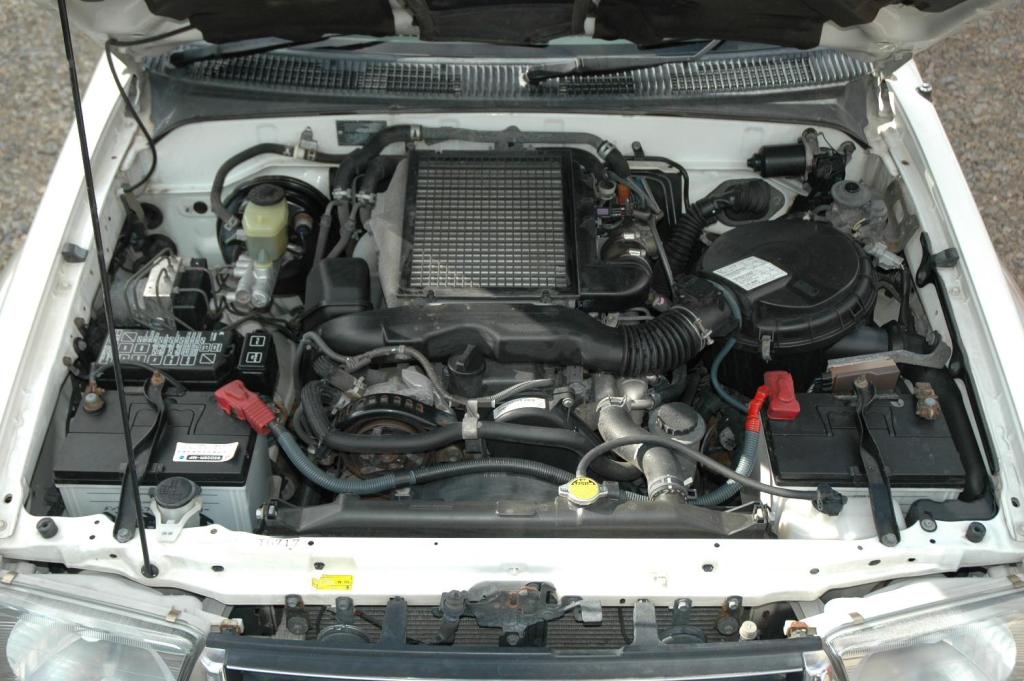

No cruise control, no evap charcoal box, no rear heat, no spark plug wires, and an intercooler hiding much of the hoses and wires on the motor. Plus an abnormally clean white firewall...
The dual battery was an option on Japanese Surfs. It was called the winter package as gets cold in the north, where snow and ice dominate in the winter.
Is it just me or is that a cleaner and more organized bay than the 5VZ :thumb3: :banplease:
The kz diesel motors air box routes to the L side because of the OEM batteries on both corners of the engine bay. I believe the starter battery is on the R and the other is on the L. I was going to swap this motor in my truck, but decided not to in the last minute very capable turbo/diesel. My 2nd reason for not doing the swap is because I already have a R side snorkel. [emoji23][emoji1686]
