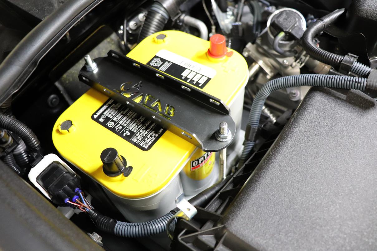

So does anyone sell a bracket that will fit in the passenger side spot, or one of you guys make them and sell them?
Is this really necessary? Does the battery holder come with the part that goes over the top of the battery?
The battery tray from C4 Fab does come with a hold-down bar.
