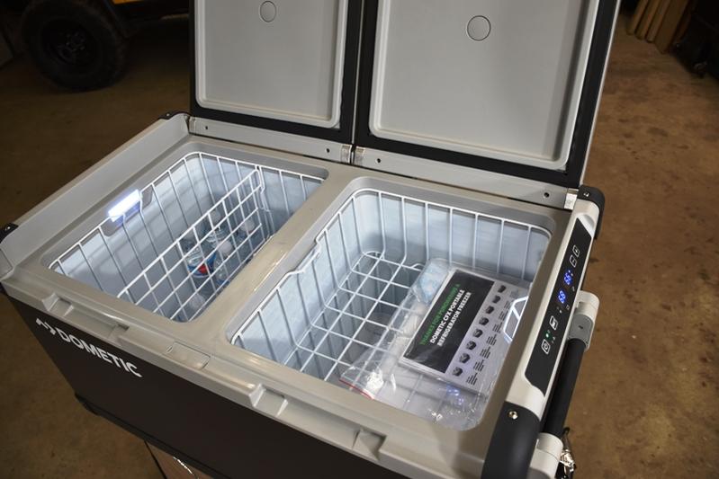

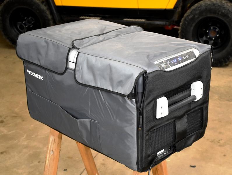

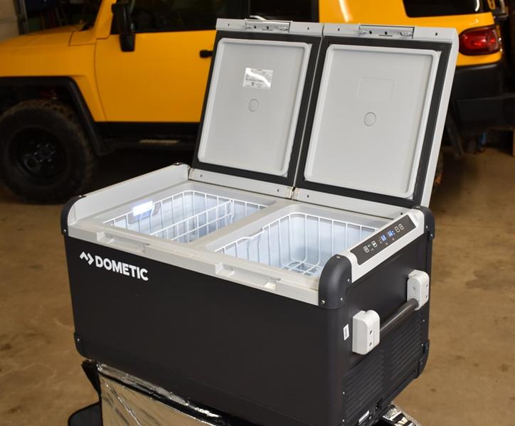

What started us down this path to dual batteries was the inconvenience of buying ice for the cooler almost every day. Forever our trips have been partially routed and planned according to where we could buy ice. We would often times drive many, many miles out of our way in order to keep our food from spoiling and our beer cold.
Last fall we finally broke down and bought a fridge, a Dometic 75DZW. Yup, the big one. Now we need a way to power it!
Our wants and needs that lead us to this particular unit is as follows:
• We wanted a brand that’s known for its reliability, durability, and has an excellent reputation for standing behind their products.
• A unit that was big enough to hold enough food for two people for up to seven days.
• It needed to be as energy efficient as possible, compared to other brands its size.
• It had to have a drain in the bottom to facilitate easy clean-ups, in case of an accidental spill and routine cleaning.
• Both AC and DC capabilities. For times when we want to use it in our camping trailer.
Additional features it has that are a bonus:
• Split in to two compartments. One side can be used as a freezer. Just in case we need to make ice for someone we have along that has a cooler. 
• Bluetooth controls and monitoring device. We’ll easily be able to keep an eye on it and make adjustments while we’re driving.
• Although it came with an additional cost, an insulated cover. This will add to its efficiency but still provide easy access.

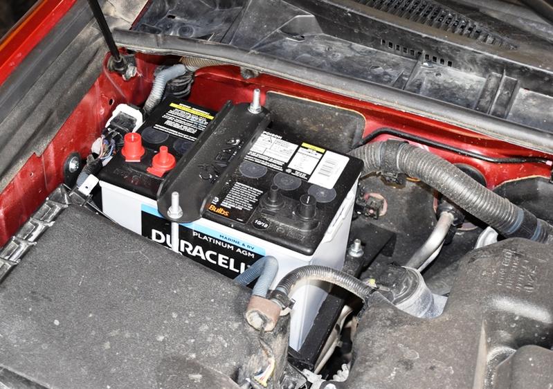

Battery, Battery Mount, and Position of Mount

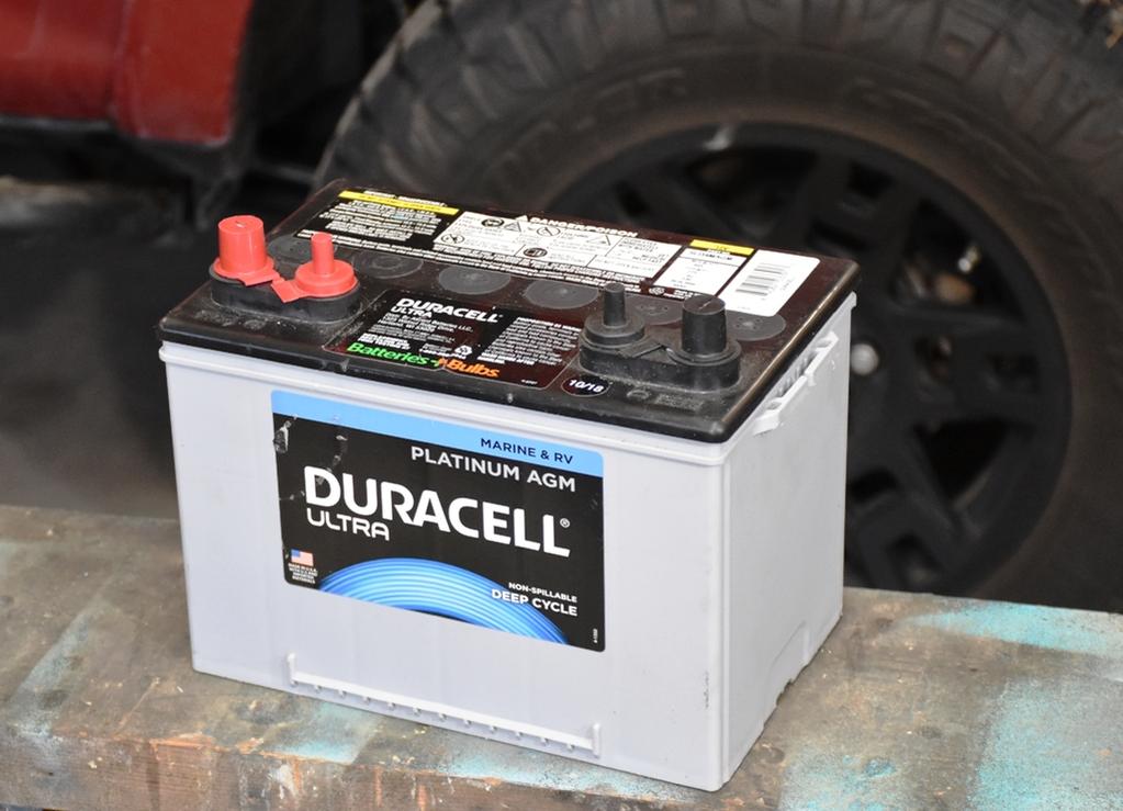

It's possible to pay a boat load of money for a battery if we wanted to. We didn't want to. After a lot of research we decided on a Duracell Ultra Platinum, AGM, BCI Group 34M, Deep Cycle, Dual Purpose battery from our local Batteries+ store. Just shy of $200 and It came with a four year free replacement warranty. We went with a dual-purpose or hybrid battery for the ability to use it for an emergency jump-start.

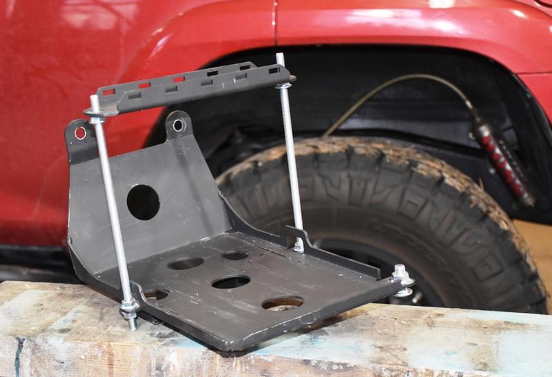

For our 4Runner there's three likely positions for a second battery.
1. Side by side with the starter battery.
Pros-
• Mounting them both there would leave plenty of room under the hood for other things, like a compressor. (We have ours mounted in the rear)
• The cables connecting the two would be extremely short; less power drop, a tidy install.
Cons-
• To fit two batteries in that space it looks like we'd have to downsize them. We want to keep the starter battery the stock size and, since it's only a year old, we want to keep it.
• That area next to the engine would be very cramped.
2. Passenger side, up front near the radiator.
Pros-
• This spot provides a nice flat, sturdy spot for mounting a universal tray.
• Cables would be short, just a radiator's width apart.
Cons-
• We would need a kit to relocate the air pump that's already in this position, adding to the overall cost.
3. Passenger side, near firewall.
Pros-
• More than enough room for a large battery.
• No modifications needed to existing components.
Cons-
• Takes a special, somewhat elaborate battery tray to securely hold
battery.
• Connecting cables would be at their longest of the three choices.
For us choice #3 was the best choice. Now how to mount it there.
Choice of well made battery trays for this location is limited. We went with one from C4 Fab. primarily for the lower cost but after receiving it we were impressed by its ruggedness. There's no worries about it failing or bending! It does come only in bare steel but that's easily handled with some good surface prep and a rattle can of flat black. Bolting it in is a quick and easy job, two bolts at the bottom, bolt a bracket to the firewall, then two bolts sideways into the fenderwell.

Can you explain why choice #3 was the "best choice" for your application?
Also can we end the whole mystery thing and get a complete parts list that you ordered?
An finally can you show a pic of the battery tray with out the battery? Does this tray address the weakness of the fender in that area?
Thanks.
Sure, since that space is virtually wide open choice #3 takes the least amount of modifying to fit in a large battery. Some people use this space for their compressor but since ours is mounted in the rear, it's the most logical space for our second battery. The cables we use to tie the two batteries together will be sized properly to avoid any power drop due to their longer length.
Patience my good man, patience.
I'm guessing a pic of the tray mounted under the hood without the battery? I'll do my best to get one posted later this morning. Because the tray is bolted on in such a way that it doesn't solely rely on the strength of the inner fender at the bottom, I believe it's more than adequate.
Thank you for answering those questions. Mark, don't worry about the pic, I went to the C4Fab web site. I look forward to the rest of your writeup. Hurry up!:becky::tea:

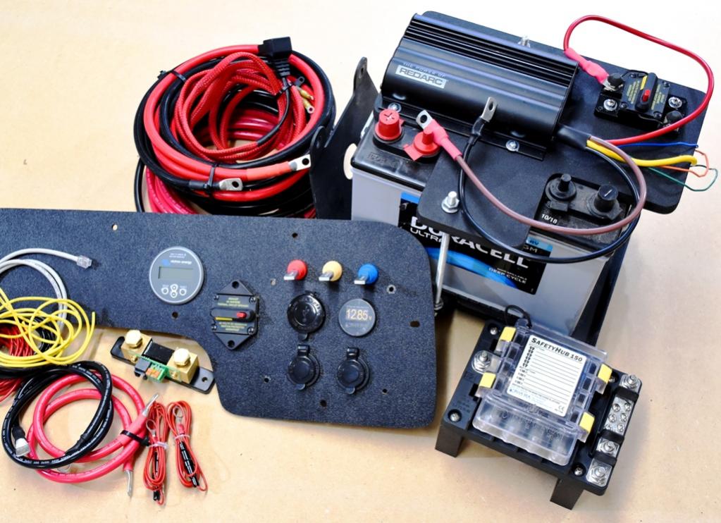

Well, this project has taken longer than we expected but as they say, good things come to those who wait.
Most all the parts are sitting on the bench. There's a little wiring to do on the outlet panel. Should be up and running soon!

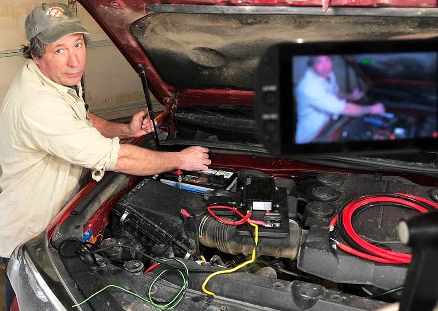

We're making progress! In fact we have the system installed and tested. Now to run the wires back to our outlet panel. The video will be slightly delayed due to me being off on the measurement of the cables going to the rear. So, we need to splice in another 18" using an Anderson plug. That should be on our doorstep tomorrow.
