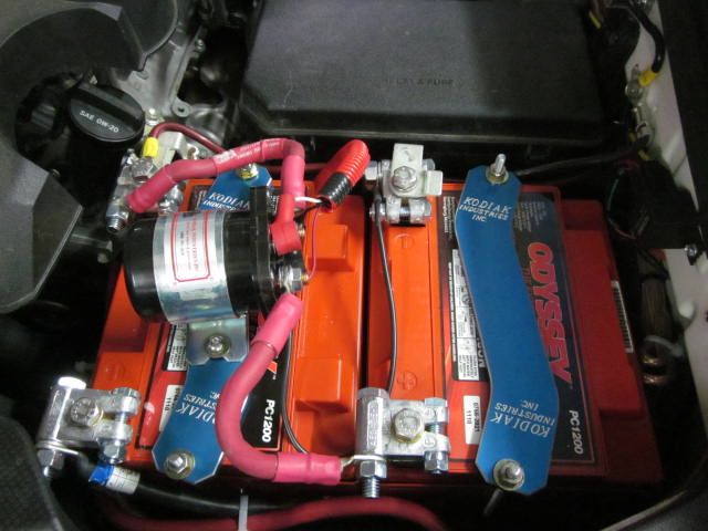

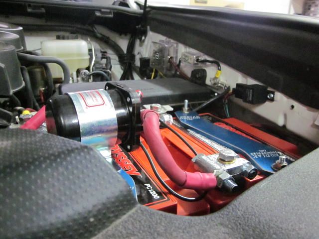

Thanks to BFLAN, my Kodiak dual batteries are installed and absolutely awesome!!! It turned out really well and is a very clean set-up.
Because of all of my lights, winch, CB and etc. he also hooked me up with a distribution block that you can see in the background, it makes everything look so much nicer!
Thanks BFLAN, you're the best!!!!!!!!!!!! :cheers:
Congrats and welcome to the dual battery club!:thumb3:
