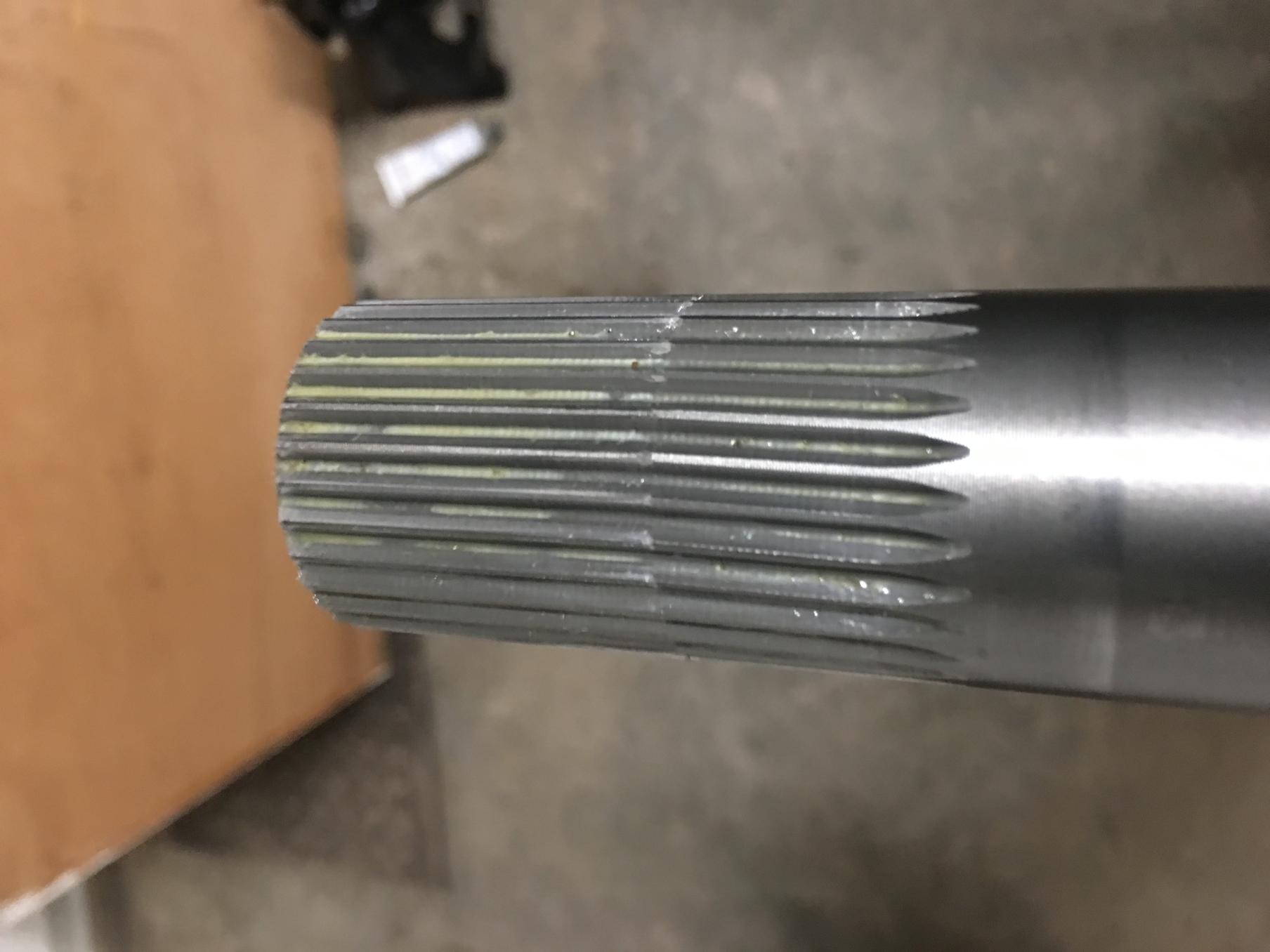

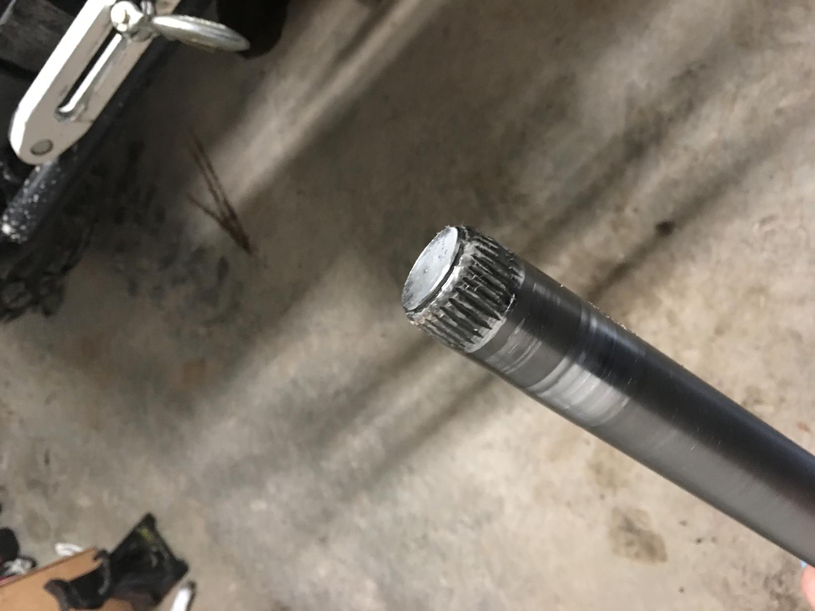

I use double low a ton in technical rocks. I found out last week that a 30 spline original Long is not as strong as my cases.
