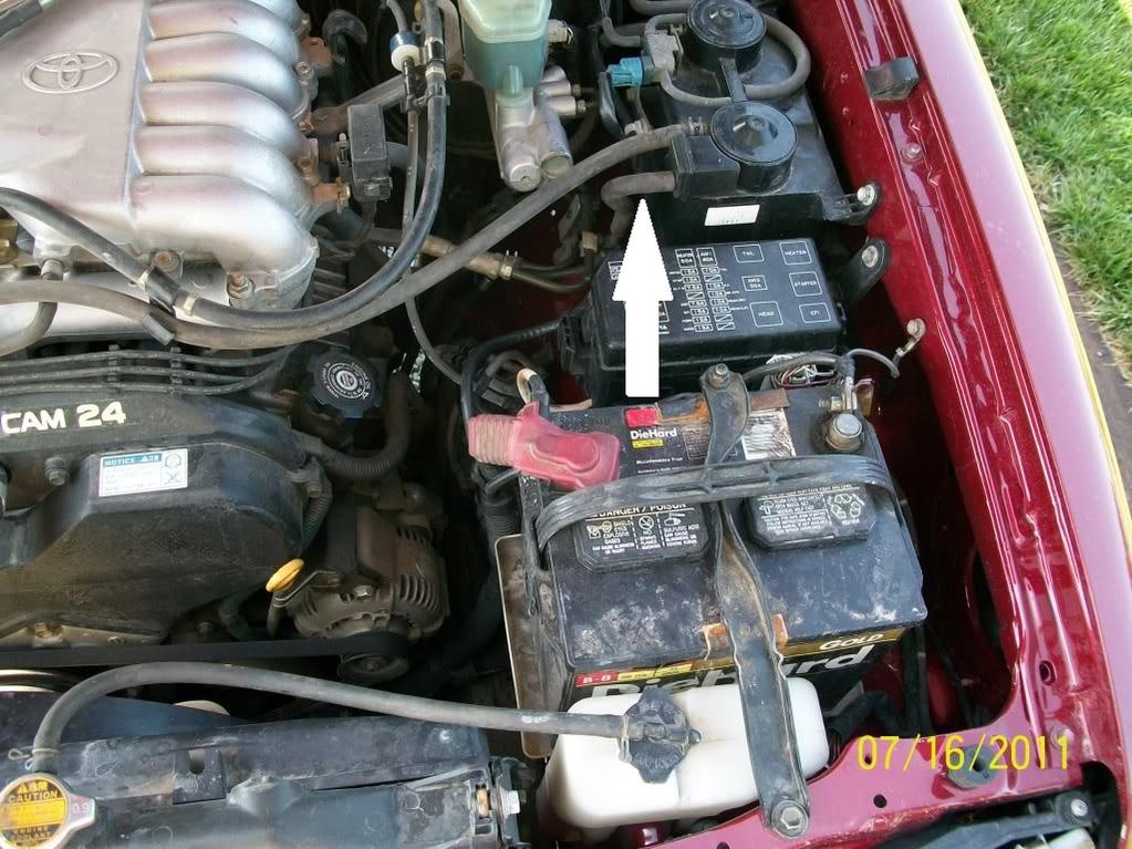

Ive Reinstalled my engine after replacing my flex plate and have everything just about hooked up except for one line that for the life of me I cant remember where it went to. Any help is much appreciated.

The line goes down and connects to a 6" piece of piping held onto the inner fender well with some clips. Then another piece of 8" molded hose which - much to my surprise - mounts into the inner part of the frame of all places. The description calls it a charcoal canister outlet and the thing in the frame is a guide. The frame connection has what looks to be a grommet around it with a nipple inside. -this is the "guide" Sits flush on the frame rail so maybe hard to see so maybe feel around for the hole with the nipple poking out a little. There's a joke in there somewhere :naughty:

there's a vent in between your mud flaps where that might go. you may have to light a match to see it. let us know...
