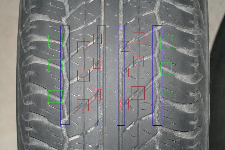

Finally got around to rotating the snow tires for the season (it just may snow around here yet.) Just want to make an observation about the Dunflops.

There have been many threads on these tires but I want to use this post to highlight what I'm talking about.
The Flops are OK to start at full tread depth (~11/32") because there is a defined tread pattern. However, as they wear the design of the tread block changes (see pic.) There are "ribs" (red boxes) between the blocks that aren't the same depth as the circumferential grooves (long blue boxes.) With 67K km (~42K mi.) on these tires, they have worn to 7/32" in the deep groove but the ribs are now almost flush causing the pattern to close. The inner tread blocks are joined and the sipes in the blocks are all but gone. Another 2/32" of wear and there won't even be a defined inner block pattern. The outer blocks also have ribs (green boxes) but they still have 3/32" to go before they join. This wear pattern changes the tire's traction behaviour because it gets more difficult to evacuate water out of the contact patch. There are wear bars at the legal minimum of 2/32" but I wouldn't even want to go down to 4/32".
These are now Doneflops with less than half the rubber worn off. Other, better, tire designs don't rely on ribs to strengthen the tread. They have full depth tread blocks so you can get almost full use of the tire's life without a change in pattern and the resulting change in traction. Look deeper into the tread, not just at the pattern, when you shop for tires and you can get your money's worth.

Very good observation there kmvreter. I just noticed that before I changed to the Revo's. The front passenger side was newer because it was the spare and the tire that got the nail couldn't be repaired. The front driver side was the original tire with 46k on it. Man, was I happy to get new tires, beside the improved traction, we now have a spare, because the tire that couldn't get repaired was of no use. Anyways they were an ok tire UNTIL you put some miles because as kmverter said the characteristics of the tire changed.
Nice post and picture.
Yes, and when all these patterns close, they will hydroplane in the rain. There isn't any where for the water to go when the tread pattern starts to "close". I have had tires like these!
