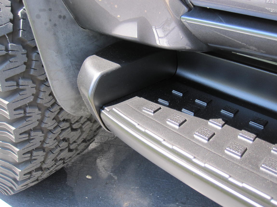

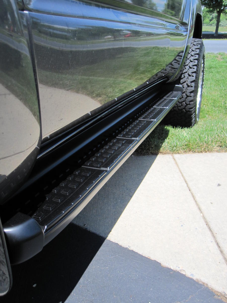

Used the DupliColor black bumper sprayon my 04 Sport V8 and they turned out great. Washed them first....then used the DupliColor spray cleaner, then the adhesive spray then several coats of the black it brought them back to life. Will post a pic once I take the tape and prep work off. Going to do the mud flaps next but awaiting new hardware and will do the same to them. If they turn out like the running boards.....they will look brand new!
Notice the mud flap discoloration vs the running board, they really turned out nice and look NEW.
Updated Pics
