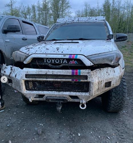

My biggest fear w/ aluminum is doing a recovery and having a failure like in this photo. See IG link for more pics (not my rig). Pretty rough and Im sure the repair was a nightmare. Flexural Rupture at the frame connection I believe.
https://www.instagram.com/p/CPJGqlOnm9I/?igshid=MzRlODBiNWFlZA==&img_index=4
