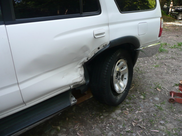

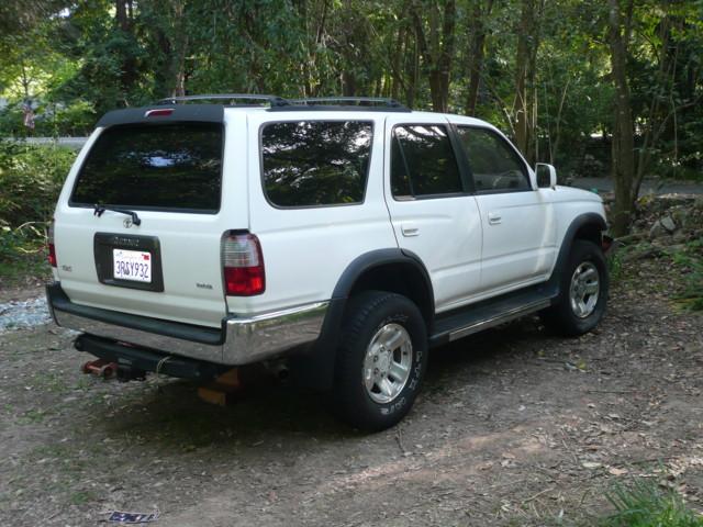

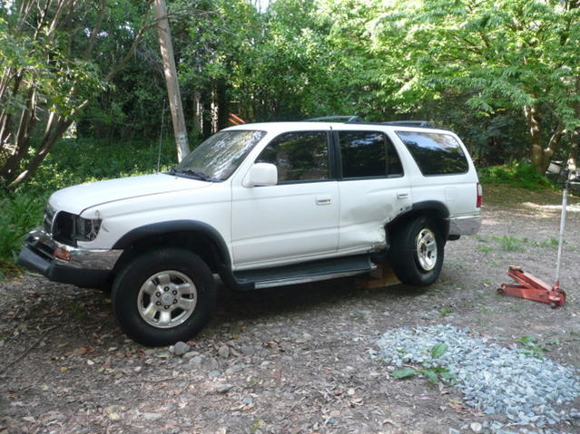

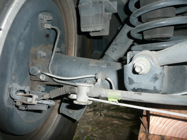

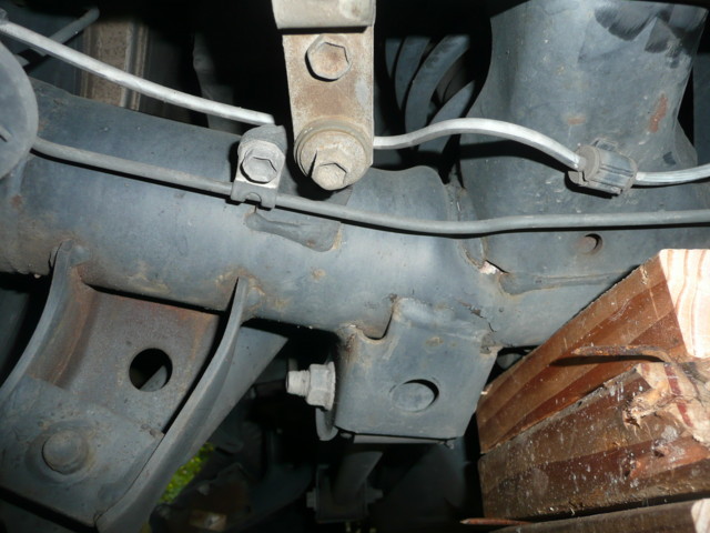

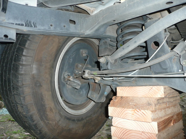

Hey everyone,
First post here, just registered so please bear with me. I just picked up a 96 4runner 4x4 for a grand today that was t boned right in the rear driver's wheel, bending the rear axle housing and I'm guessing the shaft as well, the diff sprung a leak from the impact. I'm not going to mess with trying to fix the axle and am just going to be replacing the whole assembly. I figured I'd replace it with a locking diff. as well. I'll attach pictures of it all. A guy at a junk yard said he has a few diffs for my 4runner, and one of them is a locking diff, but the little motor that goes on the diff housing is gone, he said cuz its gone he would give me the whole assembly for $350 drum to drum ( minus the diff locking motor) Do you think this is a good deal? and if so where can i get that motor? Also where can i find the gear ratio for my 4runner?
