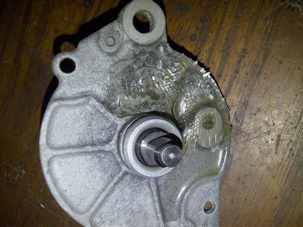

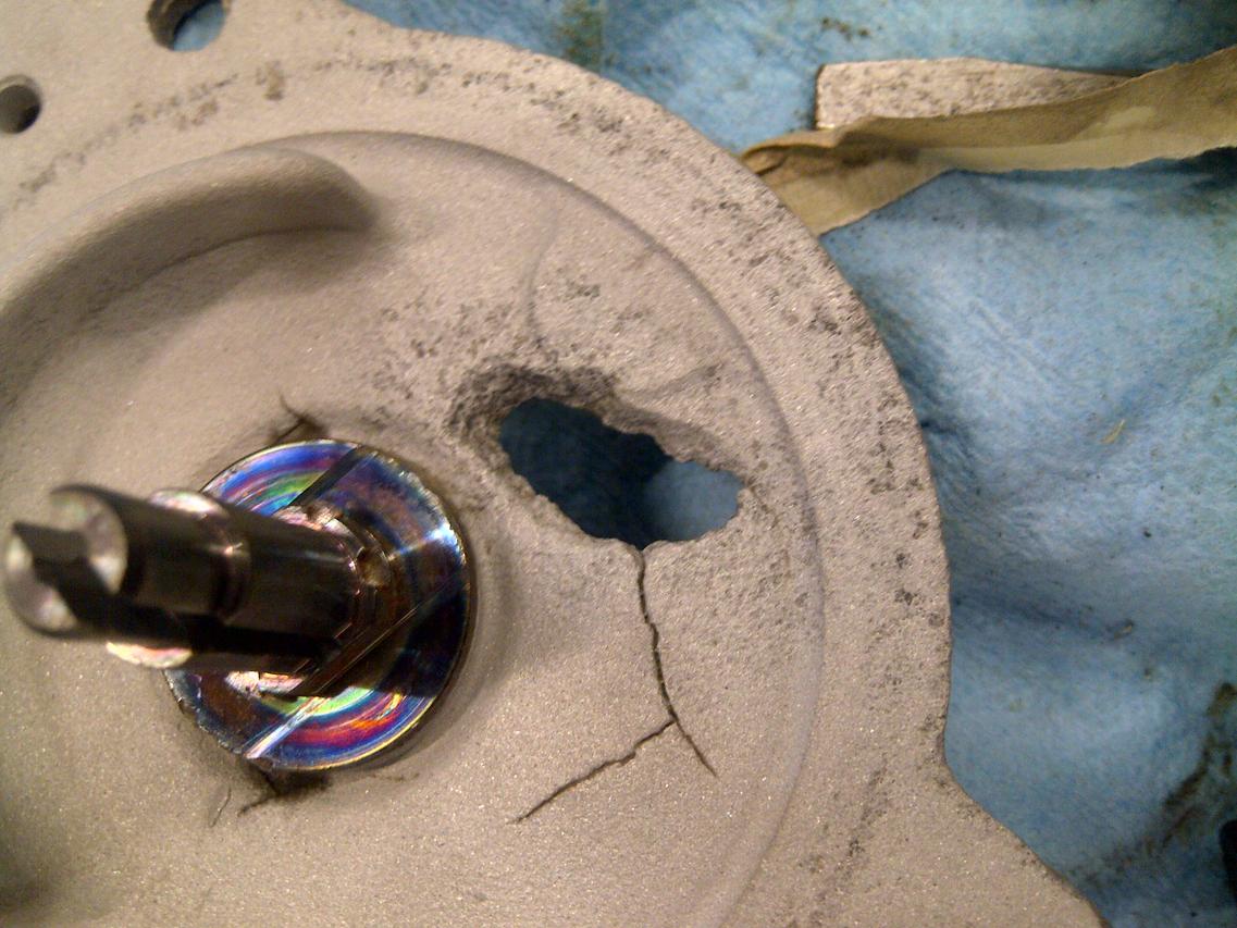

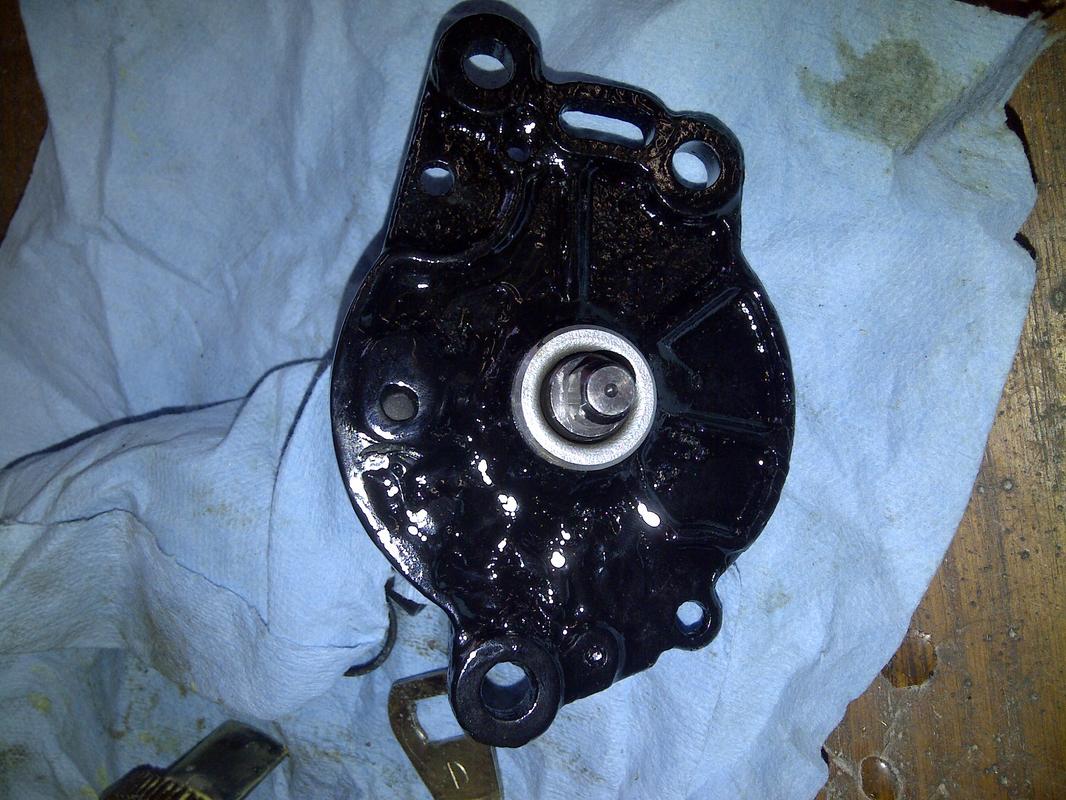

When I got it my brother who knows about this stuff told me that it was probably broken. So we went ahead and took it off. The corrosion was apparent and i knew it had to be fixed. What I didn't know was I had a gaping friggen hole in it about the size of a nickel.
So I looked it up and someone did a fiberglass fix. Considering its not structural I went ahead with the fiberglass. It worked good.
What I did:
Get some fiberglass mat, resin, hardener, paintbrush, small cups to mix the resin, and 2-3 disposable small paint brushes.
Pre-cut the fiberglass to size, then apply resin around the area that you will stick it to. Apply the mat and use resin to cover the fiberglass. Repaet untill you see fit. 2-3 coats is plenty.

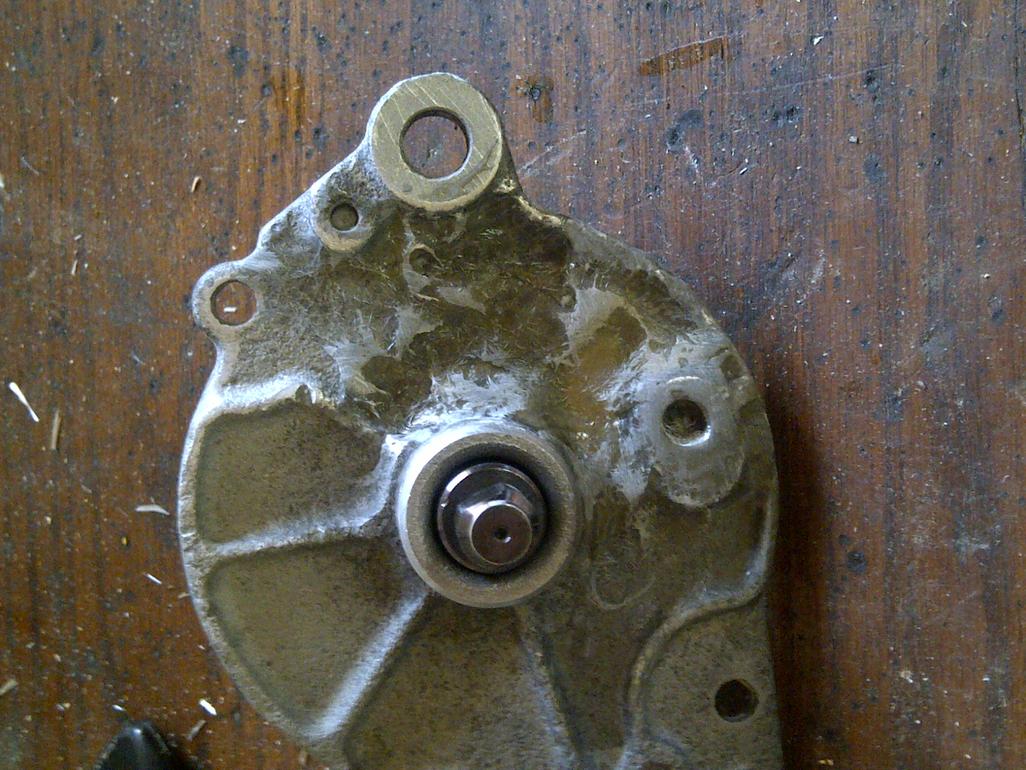

Thinking I did a great job I painted her up, well not so much. The center piece that the gear turns on was stuck. Wanting to get it done I let my friend in a shop class a head of me work on it. And he broke the center piece.

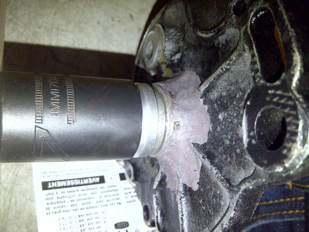

I was devastated! So close to being finished. So I got some steel putty and fixed her up. Thinking I was almost done I started to re-assemble the gears. While doing that I broke the center piece. So I fixed it again. Testing it for hopefully the last time and...
IT WORKED! But heres where the plot turns...

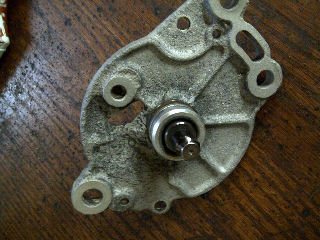

The center piece came loose again, but was solid when it was put together. I thought it was fine but my brother thought more was needed. So he took everything apart. He redid almost everything and fixed the center piece for good! Excited that he fixed it we put it together. We hooked it up and IT DID NOT WORK... W T F

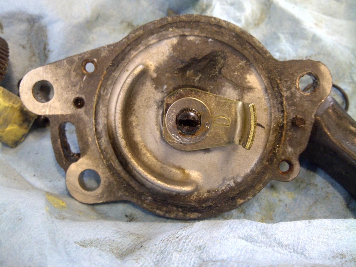

We could here and feel the motor trying to turn... but it didn't. So he took it a part and cleaned it out. Then we took the motor housing its self off. We thought the problem was solved when we saw that the magnets the motor works off of were loos and just floating around. Again the MOTOR didn't work... We took it apart and cleaned it. The Motor spins with our hands but wont when put back together.

FWIW, It sounds like the case is tweaked and put stress on the motor when torqued down.
Ya, I understand that would be but that money doesn't float around in my part time job. Its still drive able so its not to bad. When I have the gears off the motor still doesn't turn... It has to be something to do with it. Maybe jammed or something...

Cause with the gear side off the motor doesn't turn it.
So its fixed, the magnets that fell out of the motor cap have been put on correctly. We had the north and south magnets backwards so it wouldn't turn. After correcting it, it turned nice and smoothly.
