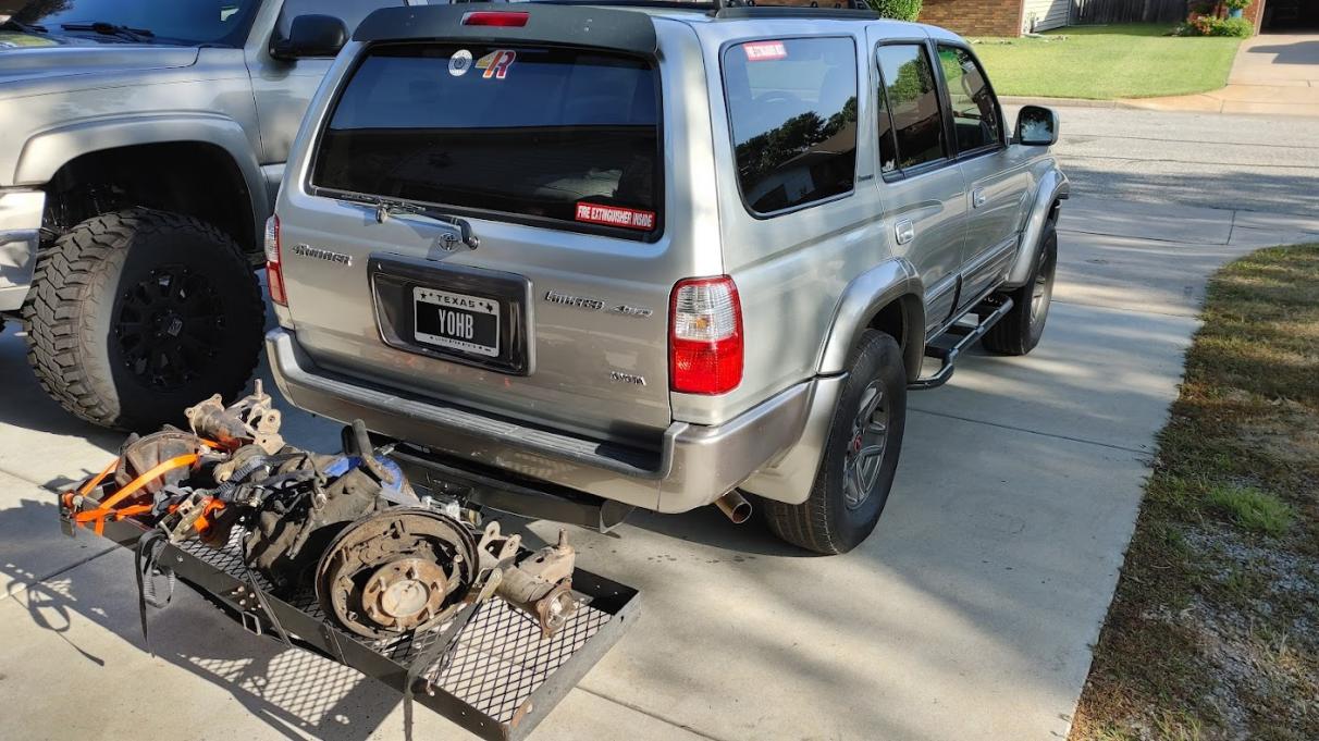

I have had this conversion done for about 2 years. Its been rock solid, but 1 thing that always bugged me, was the lack of a safety override for the locker.
I have hit the switch at 70 mph once, luckily no catastrophic failure as I was off the gas and coasting.... I meant to hit the seat heater switch, my OEM locker button is just below that...
Anyway. My question is related to the Grey Wire mod. Right now, both grey wires are just shorted to ground.
Can I use the Parking Brake signal to the grey wire to add in a safety? I don't want to risk my wife hitting the button the 1 time a year she ends up needing to borrow my rig,...
