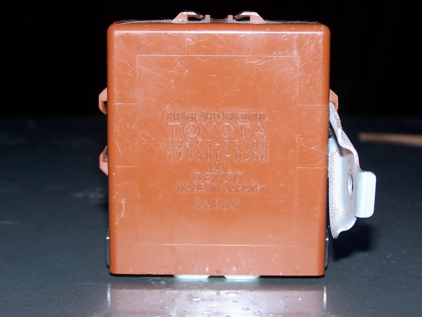

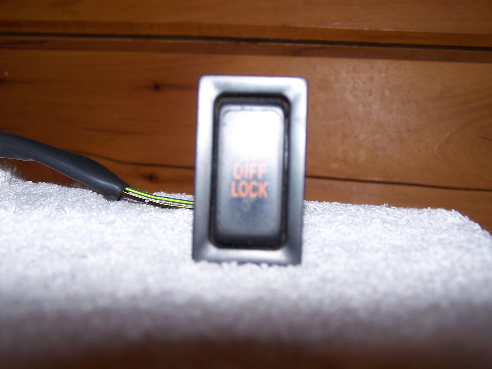

I have a 4WD ECU and Diff Lock switch for the locker I would sell you. PM me if you are interested in talking about it. I also have four or five connectors for the harness I would throw in for free. I do not have the harness however.
