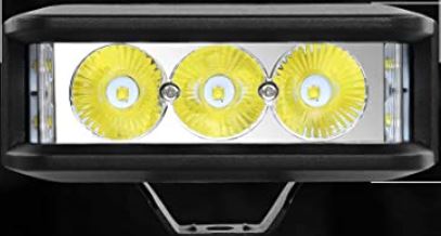

I just sold my squadron pro led fog lights. they go into the stock location and are more than bright enough for your needs. Easy install without having to remove the bumper and can be used with your stock light switch.
I do agree it might be better than pulling the front bumper off to put the LP4’s behind the grille. Those in amber to match my amber led bar probably be good. I had a Cali led white lens behind my 2015 Tacoma years ago and no issues with the lens getting dirty. You could still clean them off. I wish I did not have to stick my led bar behind the upper grille. But I don’t want to spend for a southernstyleoffroad bumper with a winch which I don’t need. You don’t have many options with the safety sense. I like the idea of the fog lights to go with the led bar. So you are saying the bajadesigns squadron fog lights are so much brighter the the factory led ones. The 2020 has the led fogs.
If you do it soon please post pics and feedback. So you’re gonna mount into the plastic grill?
[/QUOTE]

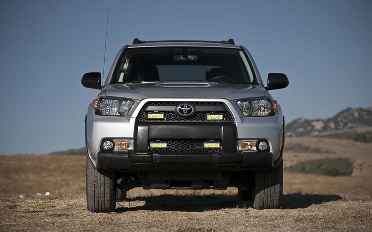

Sure, I will definitely post pics and feedback -not sure if that will be soon -maybe in the next 3-4 weeks, but I will post for sure.
My plan is to turn lights "upside down" and mount them to underneath portion of the horizontal (plastic) part (s) of grill... just not sure yet if it will be on the top or bottom portion of the grill, below is "poor" man photo shop of what I am thinking (and that is not my truck), and also what I meant by "upside down" light.

I want to do something like this on the upper part of the grill with dual LEDs instead of running raptor lights. The guy who's running this setup bought his on Amazon and it came with the mounting hardware plus extensions.
Like this:
