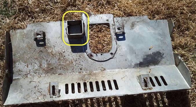

Steel. My Bud's were my 2nd set of aftermarket skid plates, so I did a lot of research in hopes of not buying a 3rd set. I have had to do a bit of gusseting and repairs to the transfer plate, but I am overall very happy with them.
Bud's have a square steel piece in that area that transfers load from the front skid to the frame cross member, preventing cratered skid plate/oil change doors, which I have seen on other skid plates.
ETA: pic of what I'm talking about
