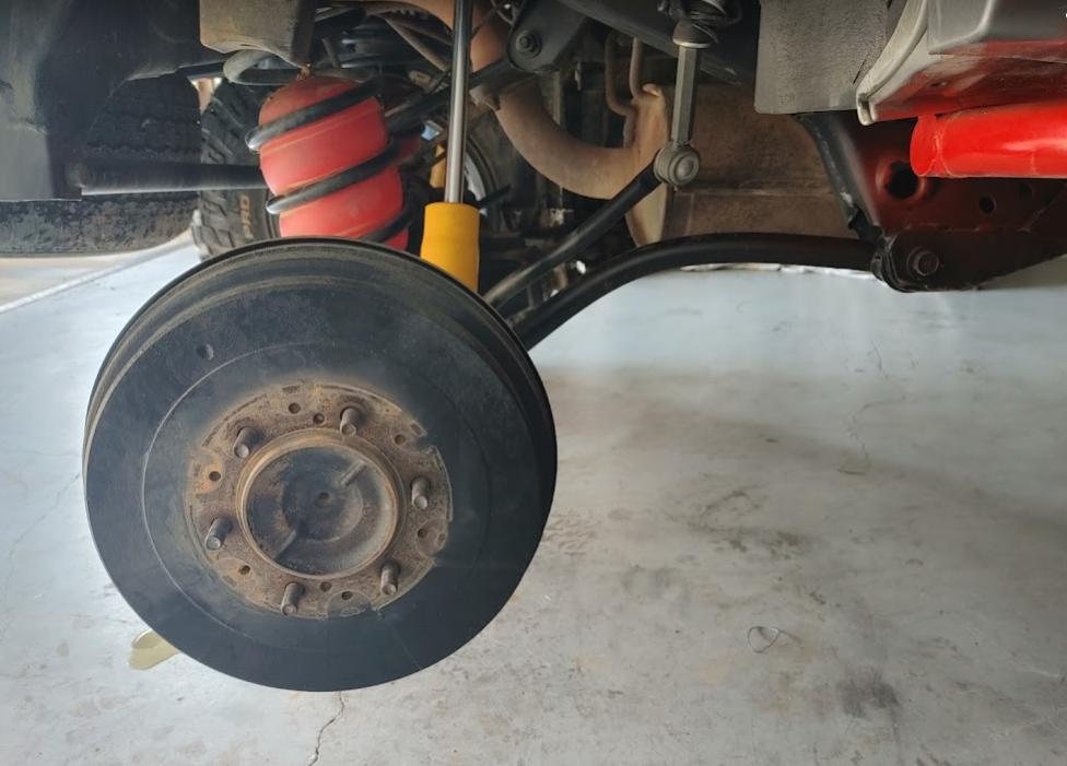

Lol Define Hardcore wheeling? I wheel mine like it owes me money... The bags have held up for over 2 years, and way to many hard sends...
