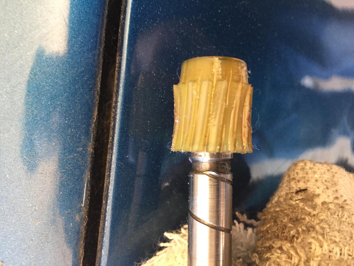

Speedo Nylon Gear Pix - take a look and comment please
91 4Runner, 2WD, auto, 6cl, 3.0L , 3VZE , A240 transmission .
Had a used transmission placed on truck 500 miles ago, speedo quit. Heard some clicking noises down below when speedo quit. Speedo cable was really loose in the screw in housing . I took unit part out of the tranny, put a drill in reverse on the nylon worm gear, speedo works fine no binding. Put back in truck up on stand, RPM at 3000, no movement.
Here is the gear-- just to verify, this looks cupped/eaten. Am I correct?
If so, what web site can I get a replacement on? I went to village Toyota.com having a hard time locating.. Thanks...
