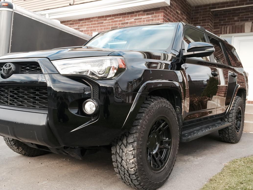

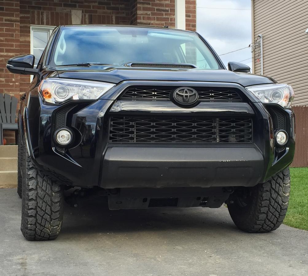

The FN F/X Pro wheels are 17x8 width and comes with 24 single black spline drive lug nuts M12x1.5P plus the spline drive lug nut key. You will receive 60g of black Hofmann power weight strips. Dustin give us a discount, a T-shirt and the black lugs are free. These wheels are a bit less heavier by a 4-5 pounds each. I don't remember the off set. Great customer service and nice guy to do business with.
Everybody is assuming it is a crap product with no proof. With that said, you would have to be the guy who tests them to see if they are really crap or not. OEM and FN are the more reliable and proven options, but until someone tries these ebay wheels, we probably won't know if they are junk.

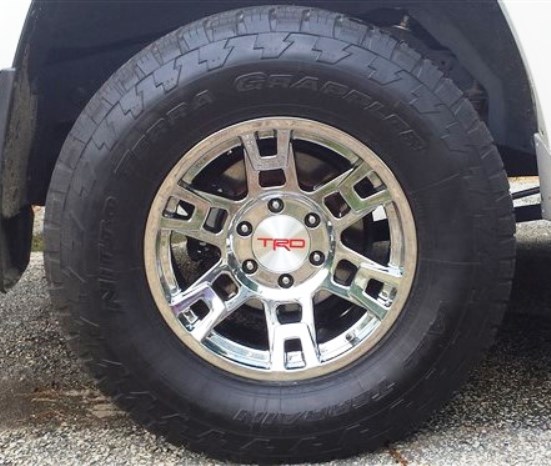

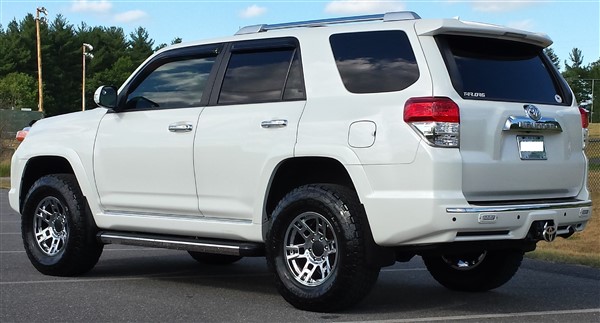

FN Wheels ƒ(x) Pro
Diameter: 17"
Width: 8"
Offset: 0mm
Backspacing: 4.5"
Load rating: 955KG (2,100lbs+)
Weight: 23.88lbs (approximate)
Certification: JWL-T, VIA, SAE J-2530, DOT approved
Colors: Matte gunmetal, dark high-gloss gunmetal, matte black and matte bronze
Toyota specifics: 106mm hub centric for Toyota hubs, lug holes drilled for 12mm Toyota wheel studs for a snug fit on all 6x139.7 Toyota hubs.
Price: $699 + shipping for a set of four. Includes center caps and locking lugs
With TRD center cap part #PTR18-35092
