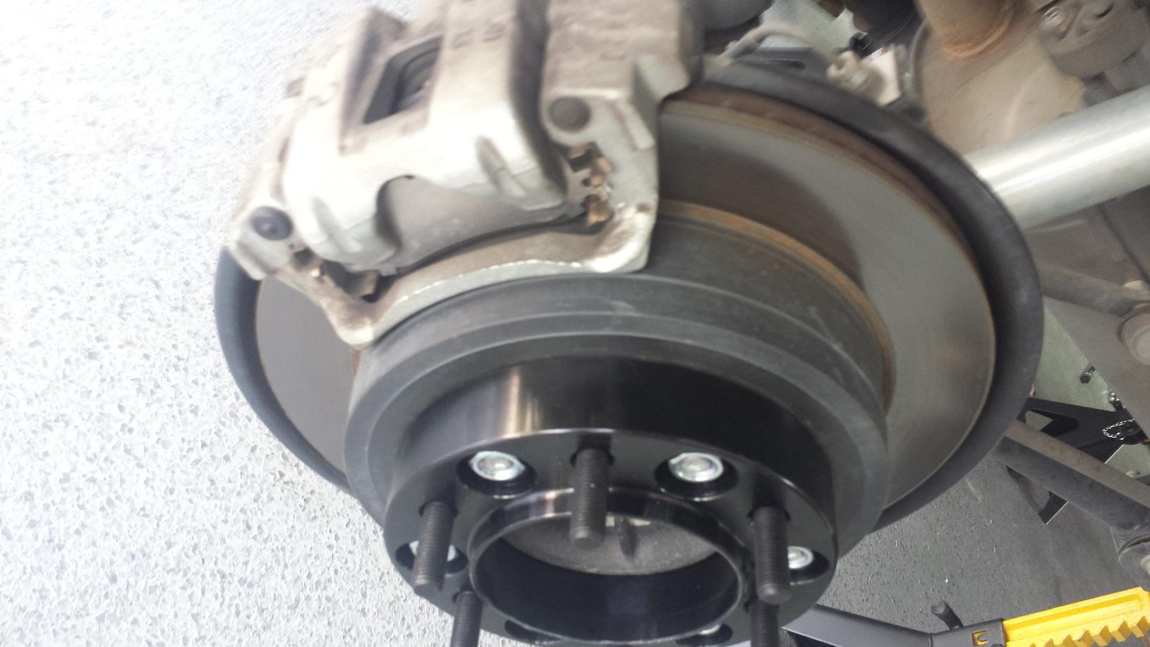

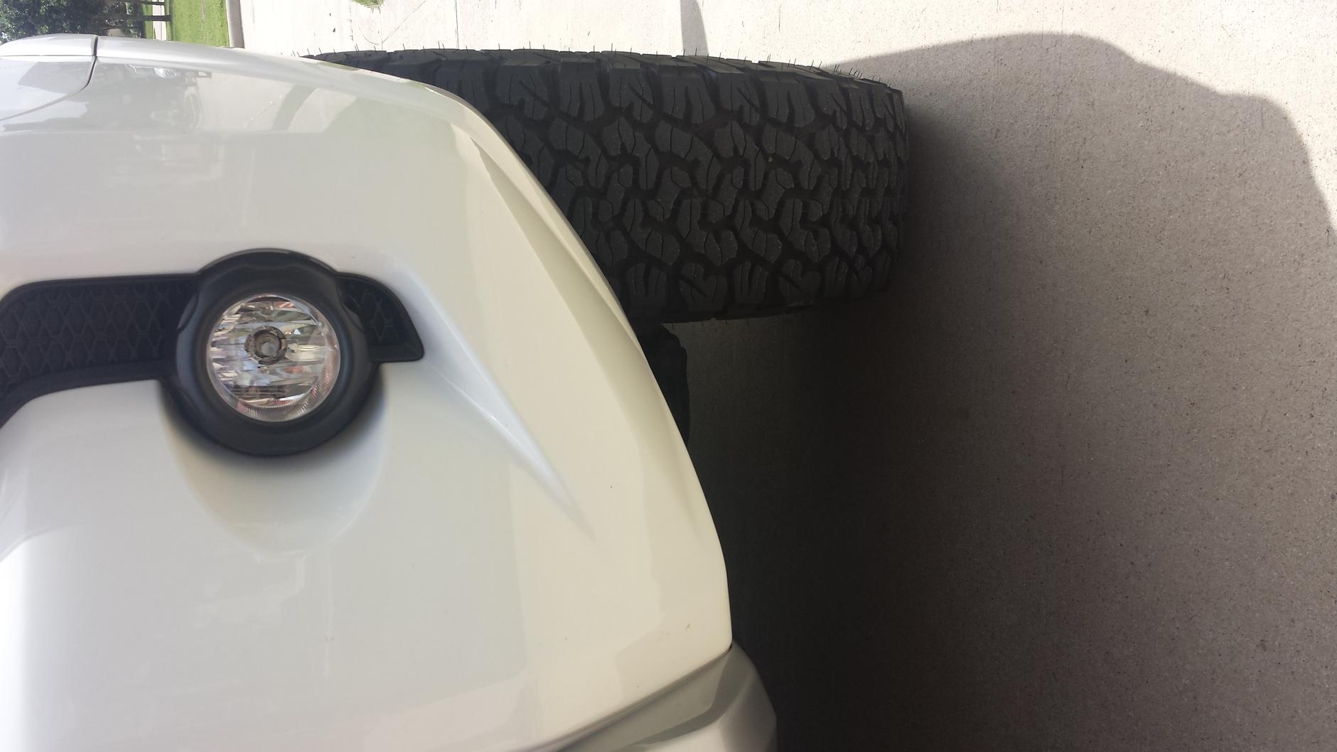

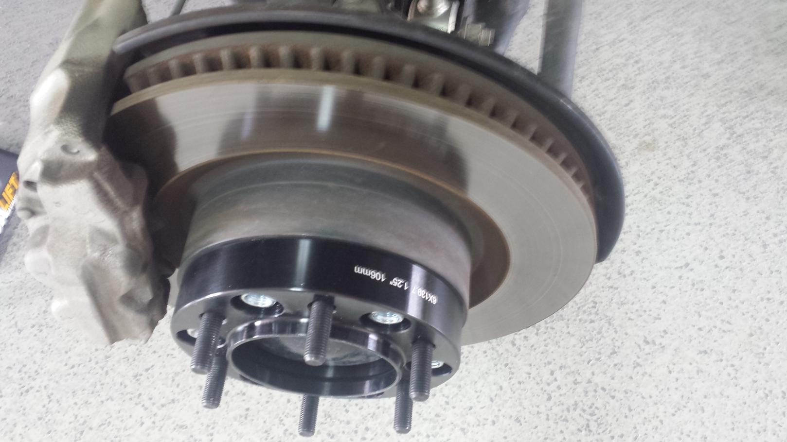

Just installed 1.25" hubcentric billet aluminium 6061-t6 wheel spacers; Just like the other mods I've done, it looks really nice but it seems to magnify any shimmy/vibrations & affect the ride quality adversely. A little steering wheel stake at 50-58mph now. At least I got to use my new tools, floor jack & jack stands. Torqued them down to 60, then 85 ft/lbs. Also used red threadlock. 85ft/lbs with the wheels too. Anyway, this is just another persons opinion; nothing that hasn't been covered already.

I actually called the guy's who make them out in California & asked him a few questions; it seems legit. The product is high quality solid billet & they sent the correct style lug nuts. Just not really working in my application.
One other variable: I did also rotate my tires since I had them off, so I'm going to "unrotate" them to see if the shimmy goes away. Little rubbing on front mudflap & bumper with 275's/1.25" spacer too.

The spacers are great quality, don't worry about that. They came with the correct extended thread nuts (you won't need the black ones). It's the nature of the spacers themselves. They seem to magnify any minor issues. Anyway, I un-rotated the wheels last night & the shimmy went away almost entirely. Once again, these are high quality spacers with the correct hardware.

I really don't know anything about spacers specifically, but it seems mathematically, that makes sense. You are extending the distance from your wheel to the source, thus any small off-balance angle would be more noticeable.

Went ahead & got the lifetime alignment with the local Firestone since I'll be changing up some stuff once in a while. Caster was increased from just over 2 to almost 3 on both sides. Camber also closer to zero. Rides a lot better & man it looks nice with those spacers & lift. 3 techs made comments about it & got involved trying to get it perfect. Couldn't let that go so went next door & got them a pizza. Make sure to use the silver (extended thread) nuts to install the wheel spacers & get at least 5-7 turns with them.
