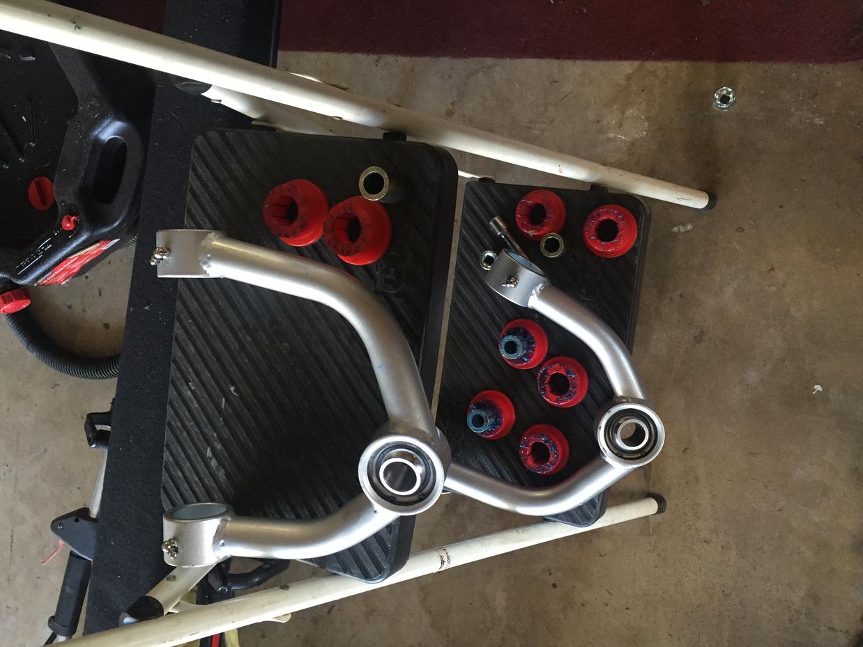

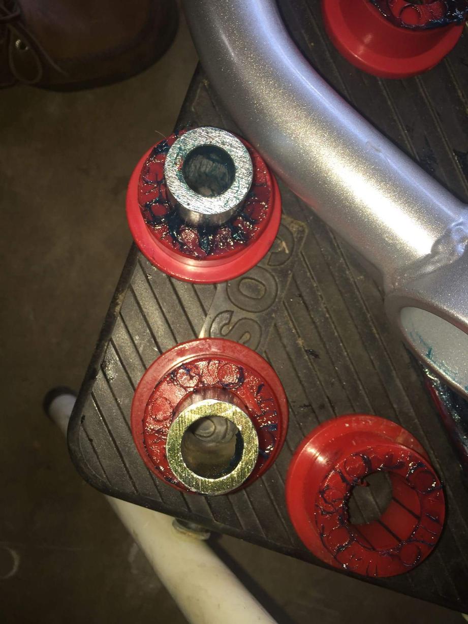

Ordered the cheap eBay UCA's for the 4runner being i have a 3' lift and ucas are in order, didn't want to drop 700.00 for new control arms so i went the cheap route to try it out, took apart the old bushings and ordered a new set of bushings and sleeves from all-pro, took apart old stuff today to notice the sleeves appeared a different color (one side gold and one side silver) and also had what appeared to be a different sized sleeve on each arm. will post more pics when i install new bushings, sleeves and install on 4runner.

Just make sure that the new sleeves extend to the end of the bushings. Ever though you get new sleeves, and bushings from All-Pro doesn't mean they work. I thought I read somewhere on Tacoma World where someone replaced the bushings, and sleeves with All-Pro's but still had issues. They had to sand of the bushings down to fit since the physical tube on the UCA was longer.
There are two very informative threads in the 3rd Gen section and the 4th Gen section.
Also, why are you replacing the bushings? Those are fine and virtually identical to the All-Pro ones.
