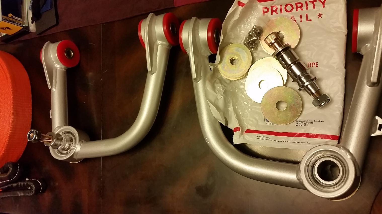

So - the UCAs look very easy to manufacture. My parents own a metal fab shop so I have a pretty good idea of the cost to manufacture the arms - so I figure the chinese ebay ones are reasonably priced for what they are. $320.
Well... I was wrong. They're heavy, look quite nice, fit and finish is good. Welds look good. Powdercoat looks good. I installed them Friday and got the alignment done Saturday. Alignment numbers look great.

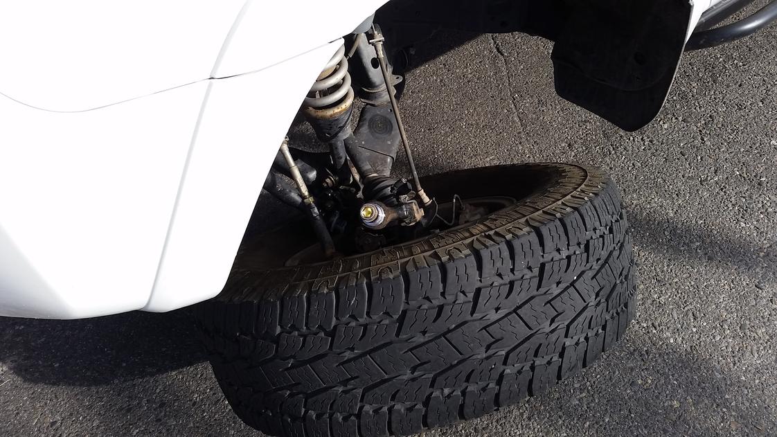

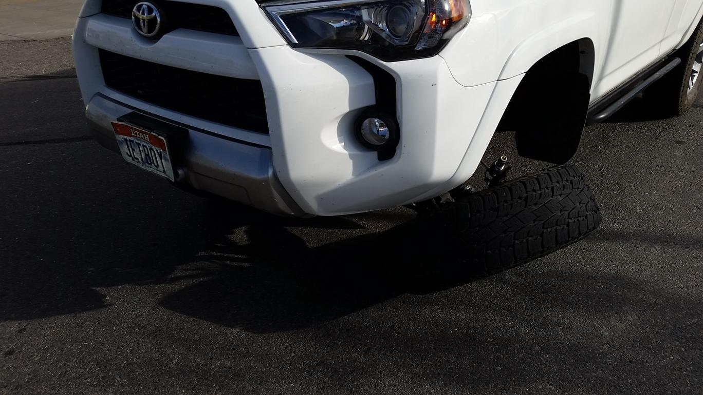

Today (Sunday) I ran to Home Depot doing some yard work. Back out of the parking lot and something feels funny.

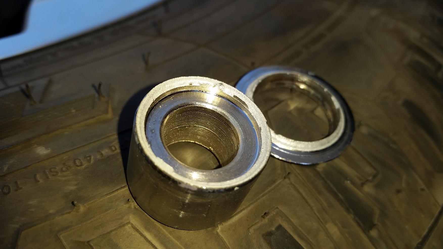

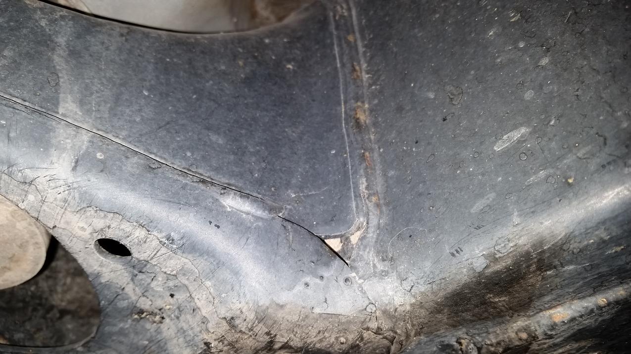

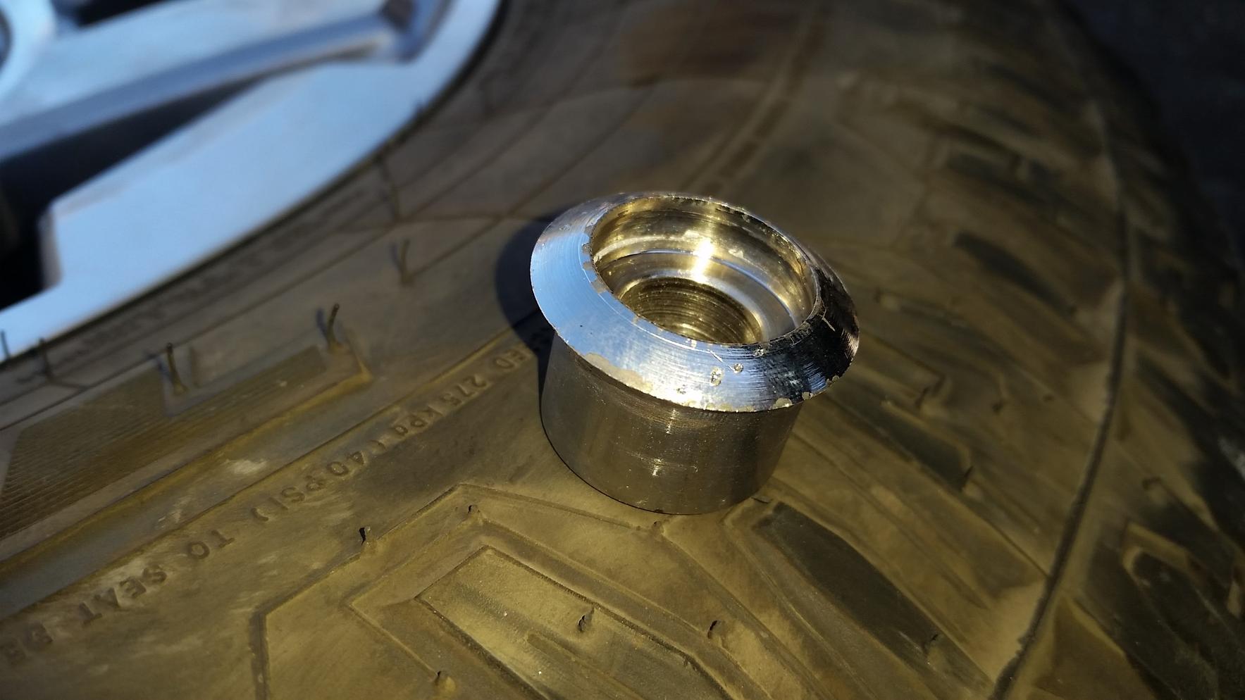

The upper misalignment spacer split and the design of the hardware means that if this occurs the bolt head is small enough to pass through the uniball and the whole thing falls apart. Looking closely at the spacer shows that it appears to be a cast aluminum part. The area of material where it failed is very small. Additionally the part has a grove right at the spot that both reduces the area of material.
I actually do think I can solve the issue with a few replacement parts, but I'm now a bit gun shy of the rest of the arms as far as quality of the uniball and bushings. I'm sending them back. Not worth the risk IMO.
Lemonade from the situation: I was at home depot - ran inside and bought a bolt, some heavy washers, and a nut. Jacked the thing up in the parking lot - bolted it back together and drove it home to swap back to OEM arms in my garage. I live about 1 mile away on a residential street, so I didn't feel too dangerous doing it.

In case anyone else was wondering, like I was, that doesn't happen to have a spare misalignment spacer handy... Here's what a Total Chaos spacer's cross section looks like.

Fair question. It was about $300 less than comparable ones from the name brands. It could have been bad news at speed. There are lots of failures from the name brands as well. As a comparison OEM aftermarket arms with rubber bushings (rubber is more expensive to manufacture) are about $150 for a pair. There's no reason they should be $600 to move the upper joint about 1 inch. other than about $400 of profit. There are a lot of quality parts from China. These aren't one of them.
These have a dangerous design for the misalignment spacers. The bolt should not fit through the joint. I should have identified that immediately. Also the spacers should be machined steel. - actually the pin should be a one piece machined part not spacers with a bolt. That's a very hokey way of doing it. It's also the way that ICON, Camburg, and many others do it. The primary difference is in materials. Icon parts are steel, not aluminum.
Before installation - you can see that they're either identical without stickers or a very close clone to the Total Chaos.

They are a copy of the TC design, but are almost certainly not 4130 and they have obviously cut corners in very important places with the hardware. Probably a non-stainless uniball and probably not a grade 8 bolt.
That may be the case. IMO 4130 is nonsensical for this application. So that's a waste of money - although we're talking what? $1 or $2 difference in cost, so I suppose it's just a matter of what's easier to use. And then you've got a gusset in the wrong orientation, so there's probably not a whole lot of engineering going on outside of making sure the jig is setup correctly for the right geometry. But the other hardware... probably where the corners are cut. It would be interesting to compare teh misalignment spacers. That's what failed here. If they're aluminum - they're prone to the same failure - especially if they're cast aluminum.
Just to add some additional info - I torque everything I physically can get a torque wrench on. These are 100ft lbs. That's what I torqued them to. And FWIW - as a comparison to the total chaos - which these are a clone of - the TC version is a fine thread bolt, these are coarse thread.

**edit**I have also had to replace tc misalignment spacers (due to a seized bolt which had to be cut, long story). Their misalignment spacer come from f&k rod ends. They're 17-4ph stainless steel
