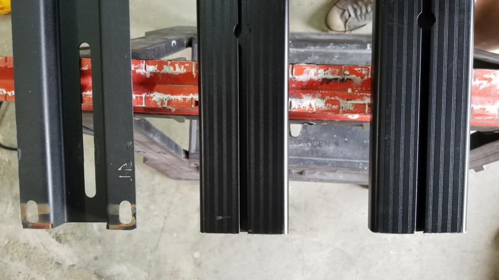

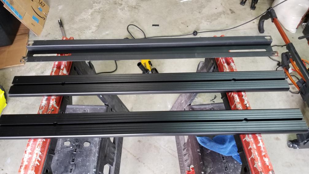

I have the same issue, I bought a Yakima cargo carrier and the crossbars are too wide for the clamps. I came up with 2 options. 1. Cut into the crossbars so that the clamps will fit. 2. Buy some aluminum crossbars and cut them to size. I started with option 1, but I felt like it would weaken the crossbars down the road, so I bought 2 aluminum crossbars from Frontrunner Outfitters and cut them the the length of the existing crossbars. I still have to drill the mounting holes and will do that when I buy a large enough drill bit. Here's what I've done so far. Hopefully it will work out and then I can use some of the frontrunner accessories.
