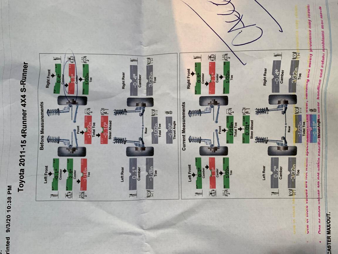

I recently bought a 2015 4runner Trail Premium w/KDSS and had the eibach springs installed front and rear paired with the bilsteins all around and currently running 285/70/17s. I did not install UCAs and the picture below shows the alignment specs, I am not sure really how to interpret this but I decided to go ahead and have UCAs installed. After a lot of research and an internal struggle on what to choose I decided on the camburg ball joint UCAs and having them installed next Tuesday. Right now the 4runner without the UCAs drive perfectly fine so I am curious to see what the difference will be once they are installed.
Also was having difficulty uploading the picture of the alignment so let me know if you cannot view it. This forum is definitely much harder to navigate than the other one.
